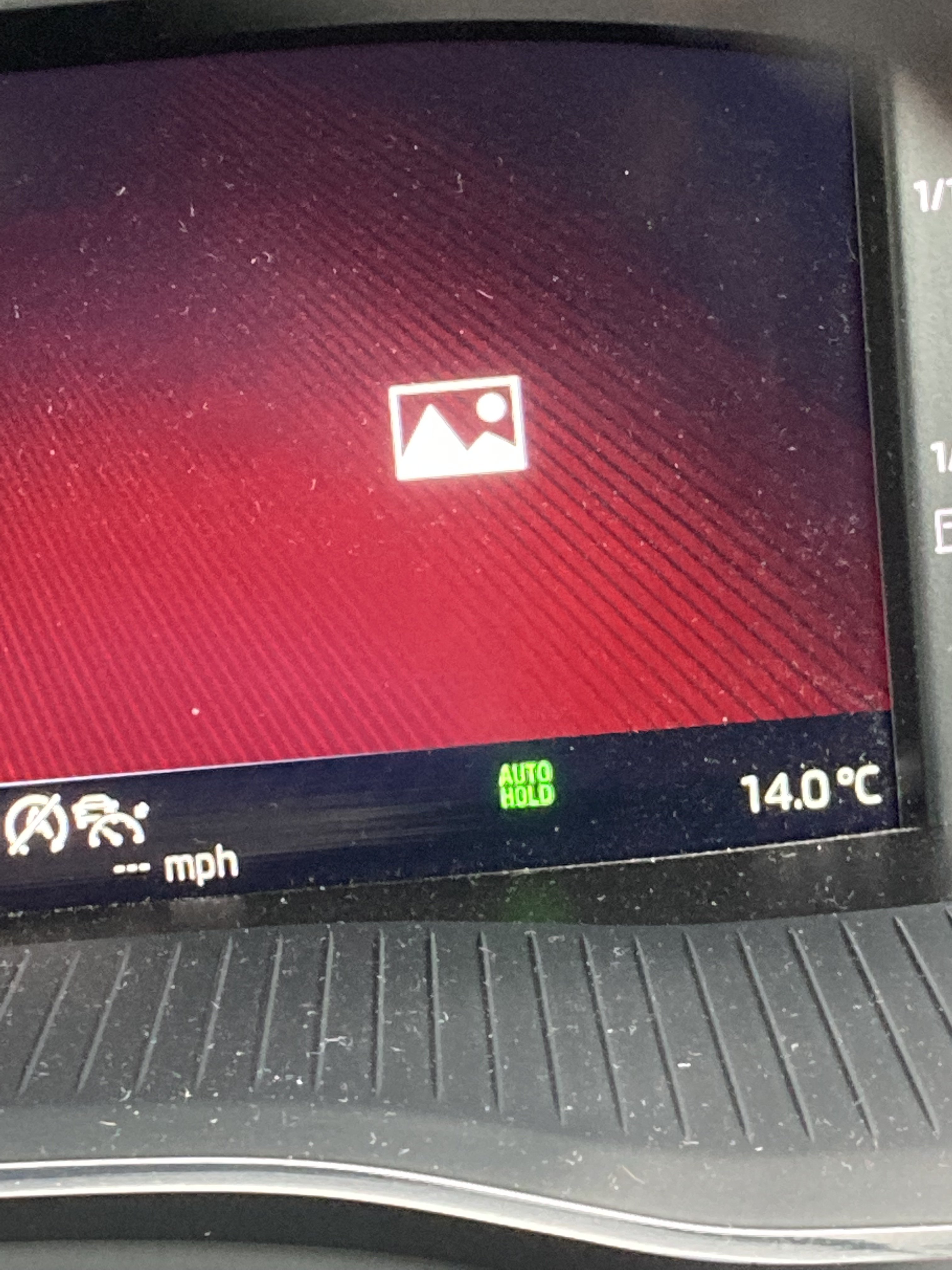

What does this mean?
It's  a placeholder icon for a picture file. Like jpeg.
Missing graphics symbol?
What main menu are you on, not speed cluster clearly
Yes  l agree it looks like a jpeg symbol, but why would that come up on my dashboard? Have been to the garage and they said they hadn’t seen it before. Any ideas for How can l turn it off ? It is on every screen change.
If this is under warranty, the garage that said they have never seen it before needs to send in a Diss report to factory to get further advice.
There are flash files for VC dashboard's odds are a flash might fix, or they need to develop a fix or swap hardware at their expense.
Yeah. Like something in the file library is missing or corrupted. When did it happen. Did it co-incide with anything else happening or being done. Dealer level access, flash etc maybe required to resolve
 If someone on here can support I guess you could try a refresh but not if you are under some form of guarantee..
