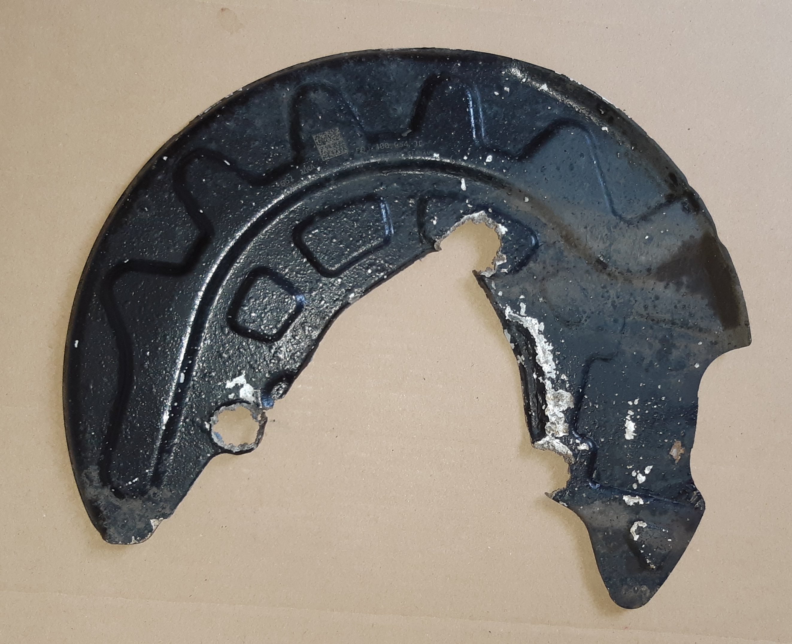

   Update to the original post,the car passed the MOT today with no advisories.But for what it costs I am going to change the rotting backplates,they are mega cheap and I have plenty of bolts in stock.

Yet more Karoq brake backplate woes (MY2019 SE L, 30K miles)! Nasty metallic rattle from OSF wheel. Nice AA man removed wheel and backplate dropped onto ground, 3 fixing points completely shredded from corrosion (incompatible metals, aluminium plate vs steel screws according to AA). Fortunately I caught this before item dropped onto highway, as reported by another member, but I had very little warning plate was loose.
You'd think they could make them out of plastic.
That is not aluminium but a special grade of self destructing steel, you can see a rust mark on the far right.
They do look to hzve some sort of plzting though which is a step in the right direction but it looks like the material specification is still for cheese!

Thanks for all the comments folks. I suppose my main point was a warning to check out any light metallic rattle from a front wheel pronto. The backplate fixings might be about to let go any minute! Dreadful to think what might result with a metal frisbee getting chucked out at motorway speeds! BTW, apologies for taking up so much screen area with the massive image of my crappy backplate. I'm a Briskoda newbie and haven't checked out how the forum manages JPEG sizes.
I had to open it in another window and  enlarge it for my current vision so no complaints form me!

My 2011 old S4 has alloy dust shields, even although I know the issues with aluminium alloy heat shields and steel retainers well, I had so far failed to consider that these aluminium alloy dust shields will suffer in the same way, ie dissimilar metals, hum, maybe I should check them when changing the winter/summer wheels over!
That happening on a 2019 car with only 30K miles is a bit much to take, even up here where rock salt is regularly spread on the roads - though I think that councils roads department are now just getting rid of stocks of salt to create space for other things, plenty salt was laid down early Saturday morning it seems.
Edit:- at least the identification marking have survived on that corroded dust shield!!

It's the same with aluminium exhaust heat shields. They often use steel fixings to hold the thin aluminium plates and the plates just rot away around the steel fixings and the plates start rattling or drop down.
Thanks for the comments folks. Seems a wee moan to my dealership might be in order (they'll probably have a suitable answer)! The AA man said from his experience brake backplates don't achieve much and he finds many owners have not replaced them. One thing I'm not quite clear about: are backplates intended to protect the disc from road dirt OR the rest of the suspension/underbody from corrosive brake dust?
They're designed to keep bits of gravel from getting trapped under the brake pad, so they're stone guards.
Thanks sepulchrave. I had a related problem on a previous Yeti, where a small pebble got trapped inside the backplate, making a similar metallic rattle to what I had this time - just less dramatic!
