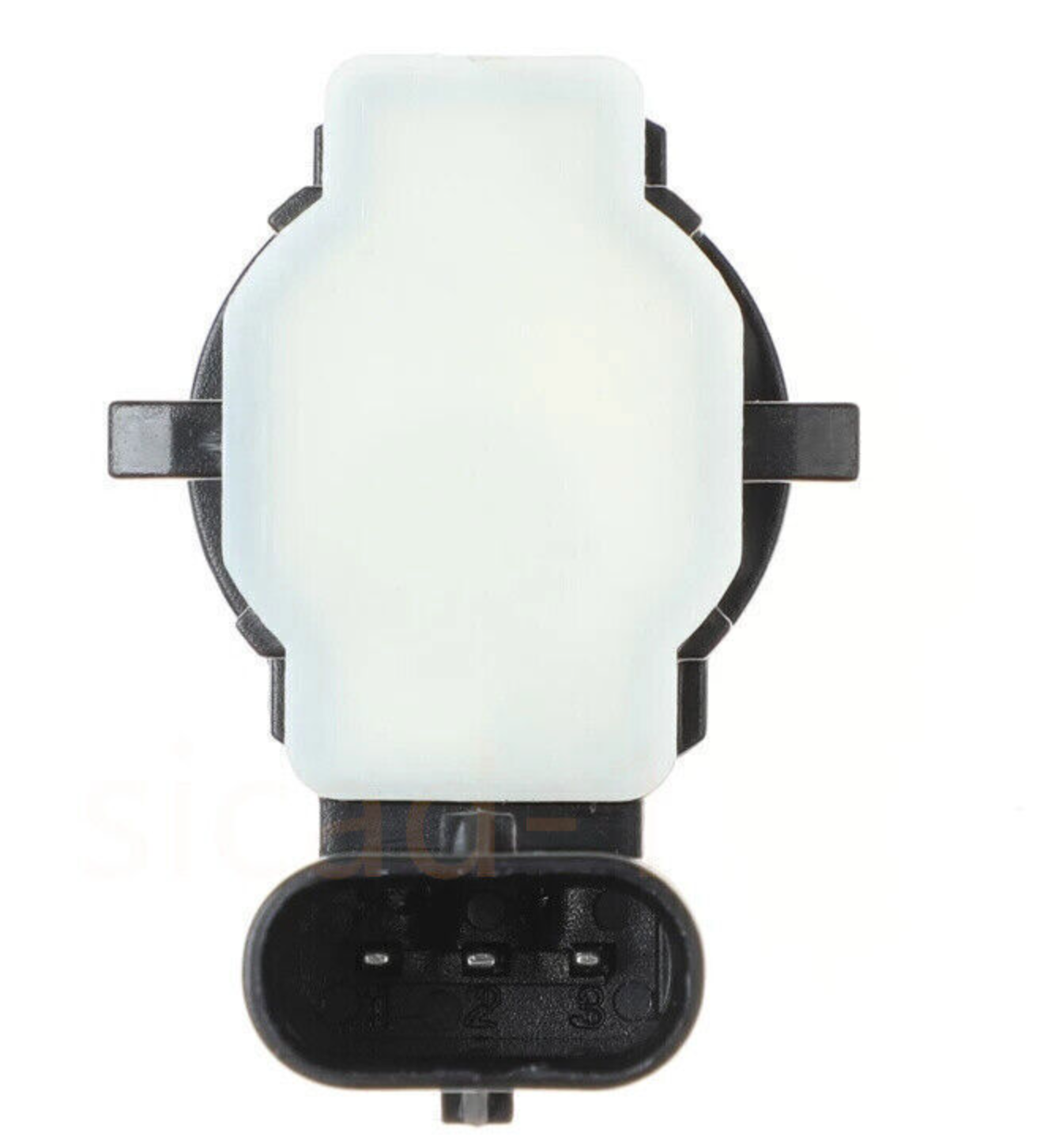

1) Does anyone know the pin layout of VAG sensors ? Not crystal clear in wiring diagram but I assumed : B+ / signal / Ground as 1/2/3

So you are correct that Pin 1 = + feed (single common shared) Pin 2 = s for signal with a wire dedicated to each sensor, finally Pin 3 = - Earth shared on a single feed wire
I had issues myself, as I sourced some new rear sensors from Aliexpress that matched perfectly the VAG OEM numbers, and not one worked at all.  So were your sensors from there, or from VAG/donor scrap car?

Thanks varoom, my sensors are from ebay - 4 of them only 28£ so probably similar sourcing to your Aliexpress ones :).
I think I'll order another 4 from skoda-parts.com - they seem to have relatively better quality OEM sensors.
varoom, thanks a lot - I got 4x new sensors (allegedly removed from a Tiguan MK2) and it works now! I shouldn't have gone for the cheap ones.
