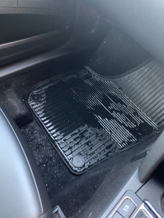

I have had repeated leaks into the passenger footwell of my 2014 Superb II Estate.

To recap - I often get just about a tablespoon of clean (ie not washer fluid or coolant) water sitting on the passenger front floor mat after it has been raining. Occasionally (as in the pic in the original post) it can be more, but it has been very little lately.

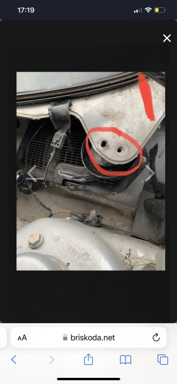

Recommended reading another thread, it’s in one of your pics but mine had a short bead of silicon to direct water away ( can’t see on your pics)

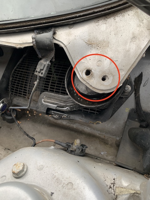

OK - old thread. I put some silicon into the two screw holes ringed, and covered them with duct tape. After leaving the car outside in the elements for four weeks whilst I was out of the country, it looks like this has solved the issue...🤔

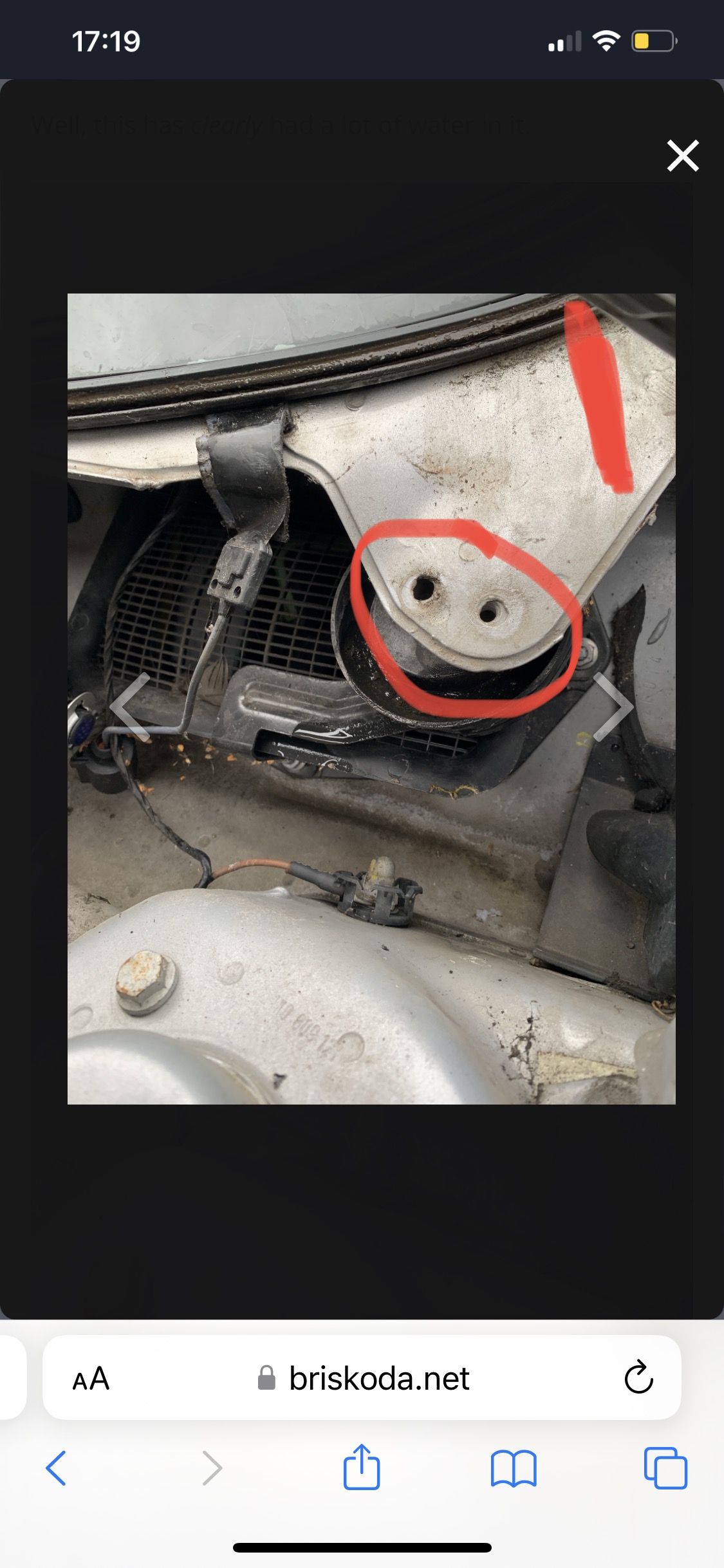

Yes I see you’ve sealed these holes
but when I was looking mine it had like a bead of silicone roughly in the area I’ve marked to what I think was to divert water from them left hand drive wiper motor holes
