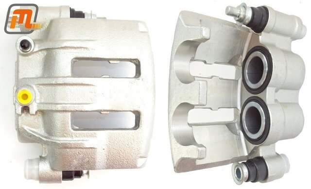

If you want a real brake upgrade, it's a good time for you to consider Ford Sierra caliper + larger diameter disc upgrade. This upgrade requires 14" or larger rims. You already have this.
