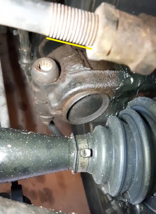

So I've looked in more detail underneath and seen this on offside. Screenshot_20221021-162232_Gallery-1.thumb.jpg.57a419fec2ae72d151db57e7ee0af732.jpg
(You might have noticed the brake flexy pipe is on the wrong side of the suspension leg  yikes!)

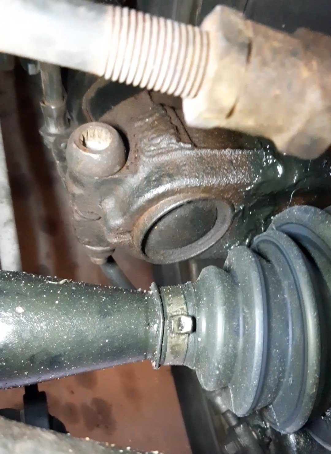

And the nearside is this....
I can see about 6 mm of difference between sides.
Now this does look like the cause of the steering wheel position skewed to the right and the new pulling to the left.

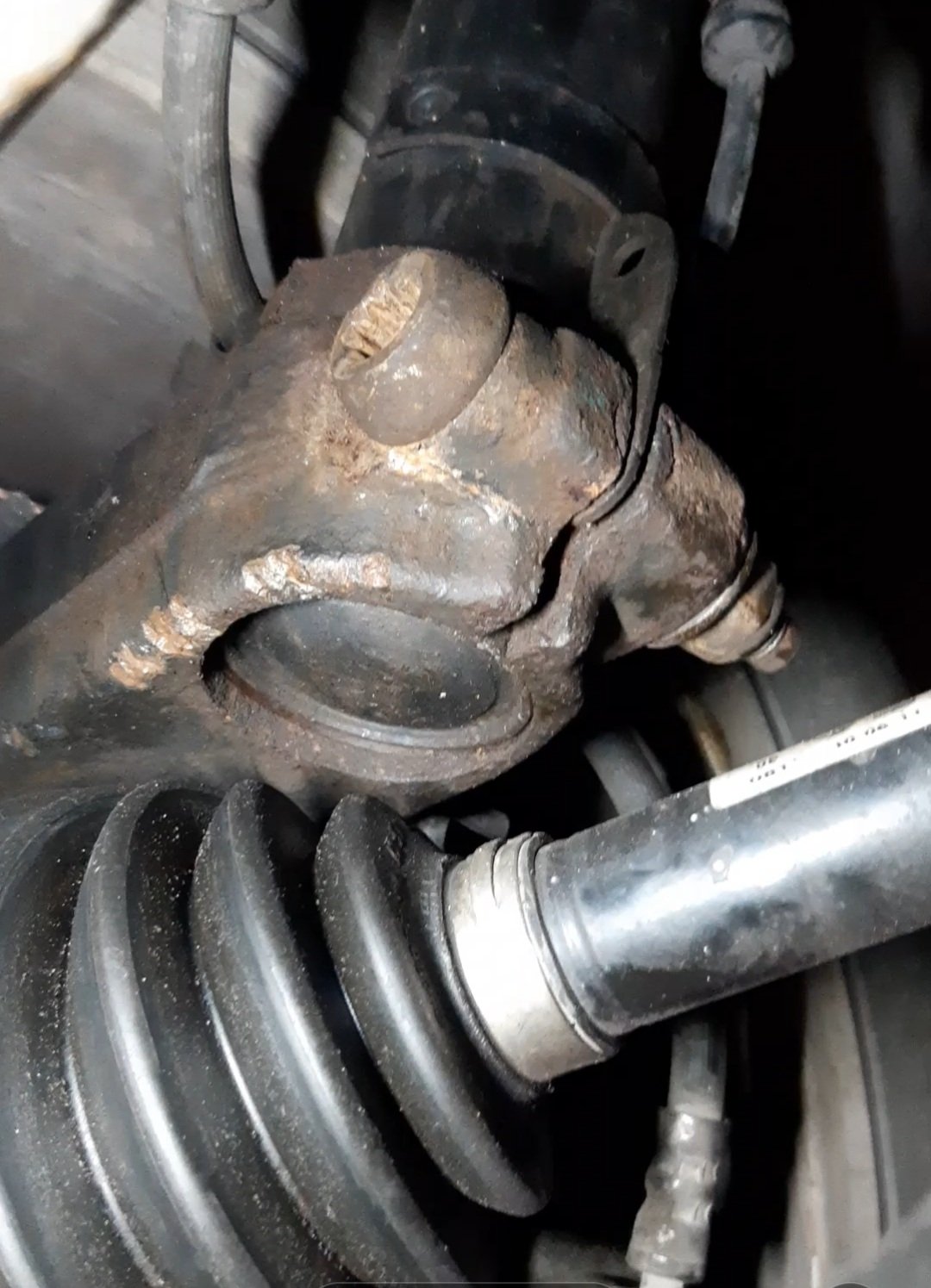

I think I might be answering my own question here. I've just sketched out what I think might be going on. Purple colour exaggerated.
The suspension leg compresses OK to equal length both sides (weight of car), but the nearside stubaxle/hub/wheel-bearing-housing they'd positioned it much lower than the offside one. You can see the markings in the rust clearly that it's not been put back as they found it.

If the nearside strut was dropped relative to the steering knuckle till the hole in the plate lined up with the pinch bolt it would be sticking way out the bottom and hitting the CV joint.
Unless there is another hole which we cannot see, it really needs both photos to be taken from the same angle, the better of the two is the second one.
Most expedient is to follow Sepulchraves advice.
The 6mm height difference would not explain the steering wheel angular position nor the pull to one side.

The two photos are one of each side from about the same angle. They're still from a video I took.
If this 6mm difference isn't enough to cause the problem then there must be something else bent or twisted or missing , and I expect it's beyond reach of Sepulchraves advice.

The strut not being pushed far enough down in the hub carrier has got me puzzled because the pinch bolt won't go in unless the hole in the plate on the strut is aligned with the hole in the hub carrier.

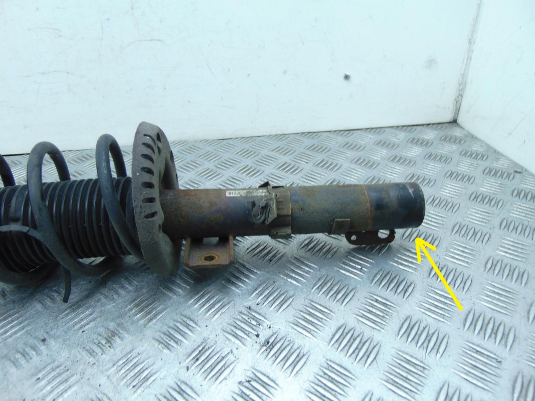

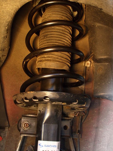

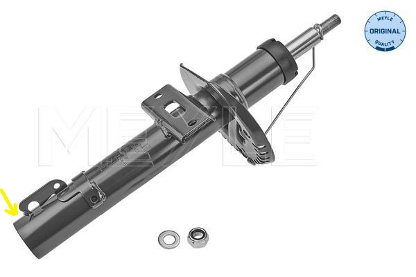

It does appear that some replacement non-genuine struts have slightly less tube length at the bottom after the bracket (it won't affect function, though).
Genuine VAG...
Aftermarket...
Edited by TMB
Won't be any aftermarket parts on this car this is the first time had mechanical work, the car's like a time capsule spent most of its life garaged. The only thing been replaced is pair front tyres and one tyre at the back which had full tread depth but had an age crack (MOT advisory each year). Low mileage it's still on the original front brake pads. Why I'm now doubts whether there really was a fractured spring in the first place, they refused to show me the ones they took off said they "threw them away".

I see on the strut photos posted above, there's a hole the clamp bolt passes through. I guess the hole is to help get the wheel alignment in the ball park during assembly (and I guess the hole's position might even be calibrated at factory?). In my case I suspect the idiot mechanic wouldn't had respected that at all, likely bent it out of shape and render it useless.
Well, as I said, judging from your pic, the strut has only ever been pushed into the hub carrier another few millimetres, because you can see the clean ring where it's been. If it's a genuine strut, I can't explain why it's like that when the other one is pushed down much further, as the hole in the plate dictates the position.

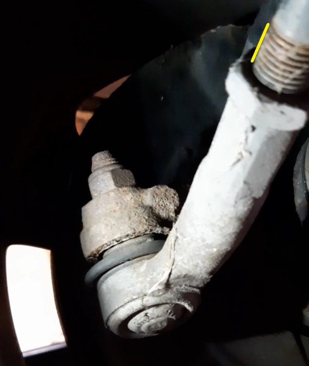

I notice that one of your track rods has quite a bit more threads exposed than the other (I count about 13 threads on one and about 8 on the other). That means the steering isn't centralised as there should be roughly equal threads on both sides. The steering needs to be centralised before setting the tracking. Then, during adjustment, both trackrods should be turned equally, otherwise the steering rack won't be centralised. I remember years ago, having cars tracked by 'mechanics' who only turned one trackrod and you ended up with the steering wheel way off centre. The angles on turning are then not right.

" If it's a genuine strut, I can't explain why it's like that when the other one is pushed down much further, as the hole in the plate dictates the position."
Me neither. The hole in plate dictates position is probably bent or distorted out of normal place by the big hammer or crowbar or whatever car mechanics use. What's clear is the car hadn't been reassembled correctly so all can do now is speculate.

"one of your track rods has quite a bit more threads exposed than the other (I count about 13 threads on one and about 8 on the other)."
Yes as you point out there's quite a difference in (8/13) threads. I'd not considered this because I've not seen signs the track rod end threads been disturbed, there's no tooling marks on the nuts or rod hexagon sections, in fact signs of disturbance right here was the very first thing I'd looked for.  If they had disturbed the track ends (somehow managing not to leave tooling marks) then it beggars belief why they would even want to disturb the track rods anyway? Unscrewing one right off the rack would be more time and work for them to do than popping it off at the joint with a popper. ...Unless they were deliberately trying to muck up the car for some reason. I certainly hadn't asked for toe setting. Just wanted the minor MOT failure (supposedly) fractured spring done nothing else.
