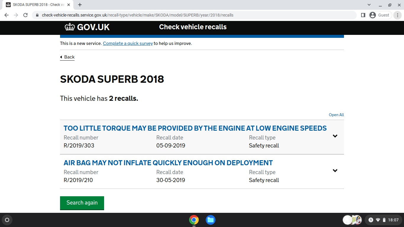

@Paul211075There was indeed a Software Update and it was a DVLA Safety Critical recall.
Check with Skoda or a main dealership if there has been another 'Recall Action' or update available.
*** Make sure you are reporting to a Main Dealership & Skoda UK that the car is behaving as it is.
there might still be issues needing addressed, but they can say, 'never heard anyone complaining, we dealt with the issues with the Recall.***

Are you checking this VIN checker.   If so it is hopeless, There can be TPI's and software updates and nothing shows there.
http://skoda-auto.com/services/recall-actions
The 2nd Recall in 2017 on DQ200's 2013-2015 never showed there, or the World Wide Recall 2012 that excluded Europe until 2014 when a Recall Action Service campaign was called.
Not a RECALL.
That was the one I checked.
