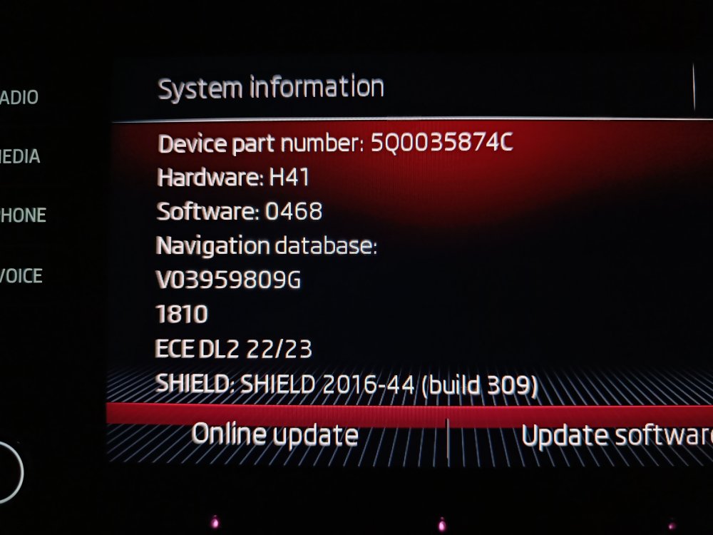

Thanks guys, Here is the info...
Would be great if there was one for my headunit. I believe there we no faults in the system when I took it down to my local independent but like you said ODIS will not have been checked then.
You should hold down the Menu/Setup button for 10 seconds to get into Engineering menu, there will be the Software Train MST2_EU_SK_ZR_P0468T and you can update to MST2_EU_SK_ZR_P0480T
This is also the correct menu for the update of the firmware itself, you will need an SD Card.
Message back if the Software Train value is correct, and if you wish to do the update itself.

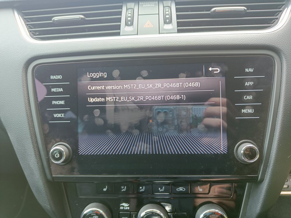

Hi sorry i'm not seeing the '480' update, is this the correct one?IMG20221103125106.thumb.jpg.093f00f35013013bbca36b8fee07bc57.jpg
You won't see, as mentioned you will have earlier version, 0480 is the update available.
Let me know if you want it sending.
I did think how the car was getting the update hahaha, I do apologies.
Yes that would be great if I could get the update.
