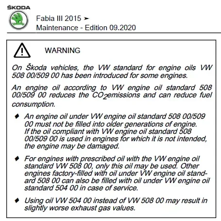

This shows from 2015.
image.webp.b48e6771853b15b770e956a10ec5660b.webp.2721e5e275bfd9c6b35e39bef234c58e.webp

Well it does but then again not fully, the "German engineering excellence" is rather restrained in the Owner's Manual, as well as on the cars, yes it's VW 504 00 for fixed servicing, this is from my wife's 2015 book (p153). -
And in keeping with VWs or warning messages. -

No, well Dealerships didn't write the Owner's Manuals.
