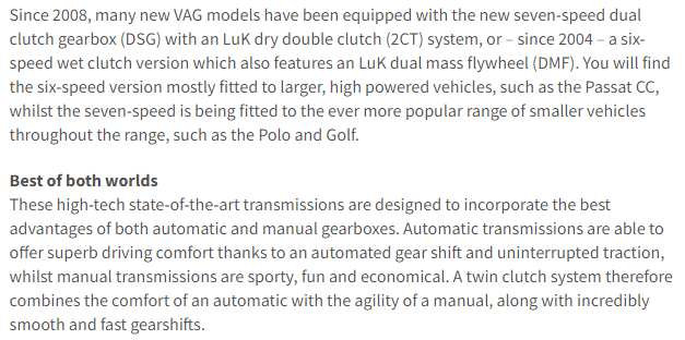

If your car has a DSG gearbox it's going to have a torque converter not a dual mass flywheel and clutch.

Pretty sure it's the other way around. The Audi is an old shool auto & that's got a torque converter.

I had missed that it was a DSG vehicle, they do indeed have a dual mass flywheel but no traditional plate clutch, instead each of the twin layshafts in the gearbox have an individual wet clutch, the next gear is preselected and a gearchange is effected by disengaging the clutch on the layshaft of the gear currently engaged while simultaneously engaging the other one for the next gear.
Does anyone know if the DSG uses a different DMF and if it is a lot more expensive as the cost of this repair still seems very expensive.

I've just been googling and the DSG gearbox DMF's are different to a conventional clutch & DMF.
