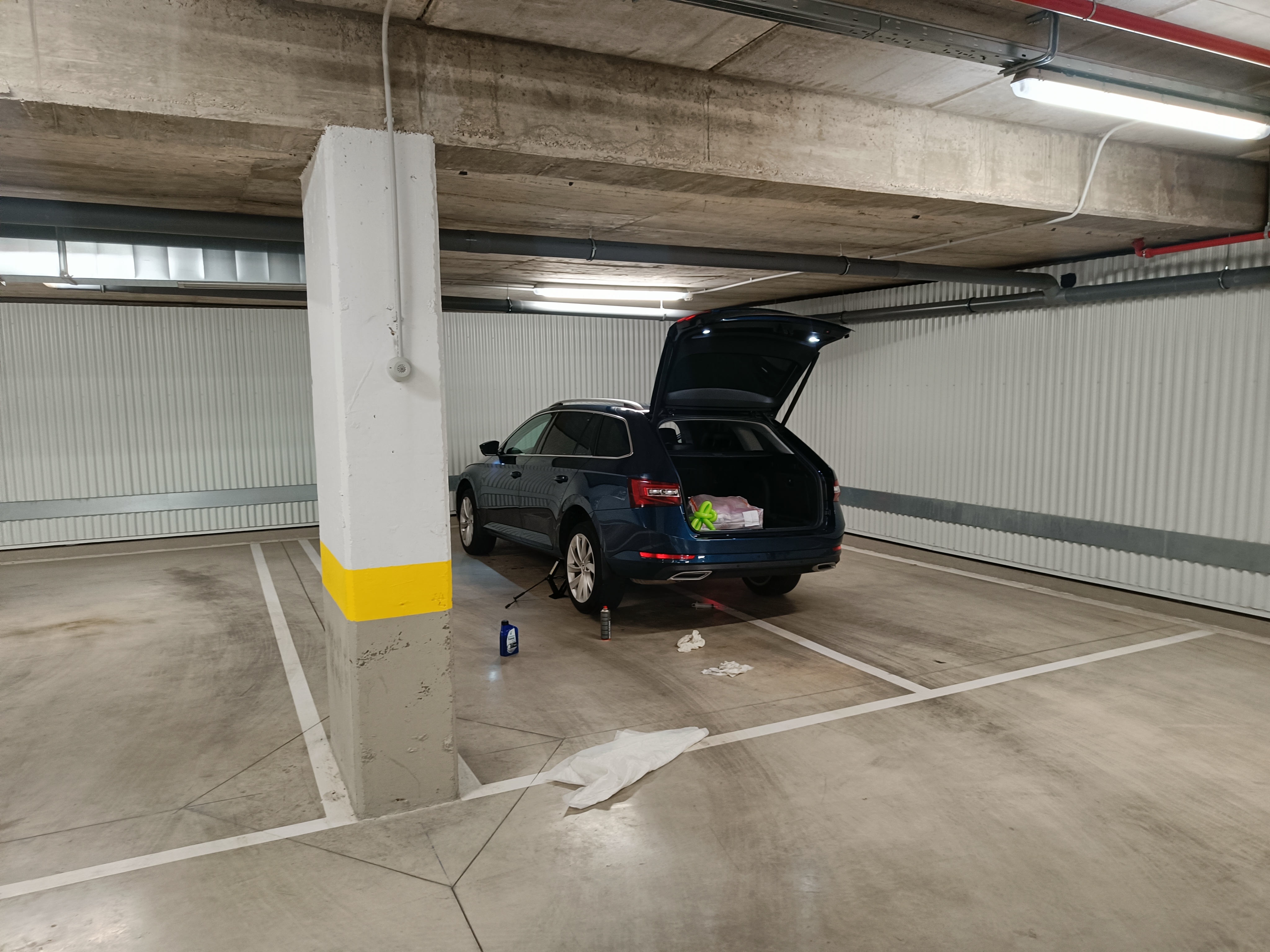

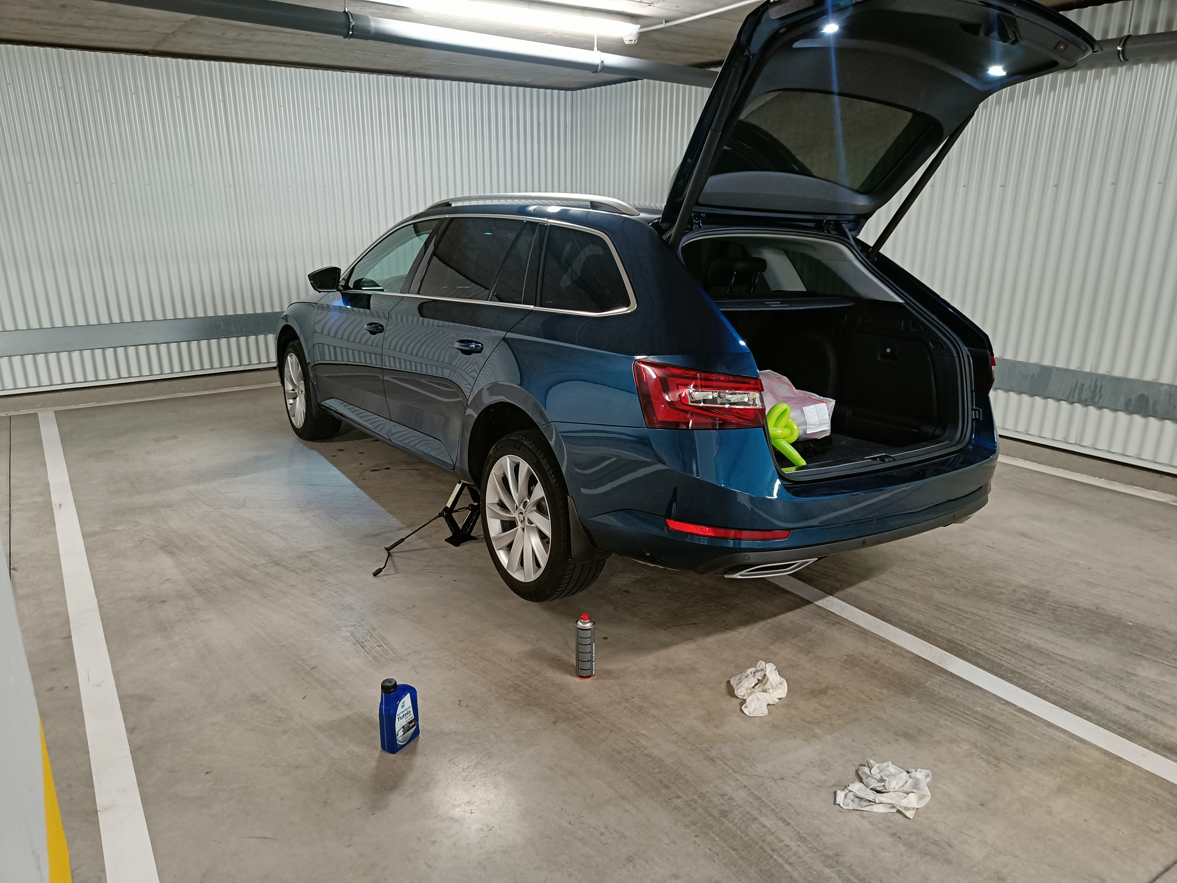

Haldex maintenance is well done, refilled and well done but I got confused and drained the diff reservoir.  Try to put hojaldex oil but of course through the tank through the drain hole.  I have driven approximately 20 km like this, and now I have left the car in the parking lot of a supermarket I am desperate to find the oil and fill it up even with the car jack
Try to drive it home at low speed. I don’t think 20km is enough to completely ruin your diff.
However, to take less risks, try to jack the car and start to refill the diff a bit.
Then refill it correctly in proper conditions, once back home.
I have a liter and he wants more.  I'm back in the store for more, and I'll go back to the supermarket to refill.  Tomorrow I'll go to the elevator.  Do you know how many liters it takes? 1,2 litres...

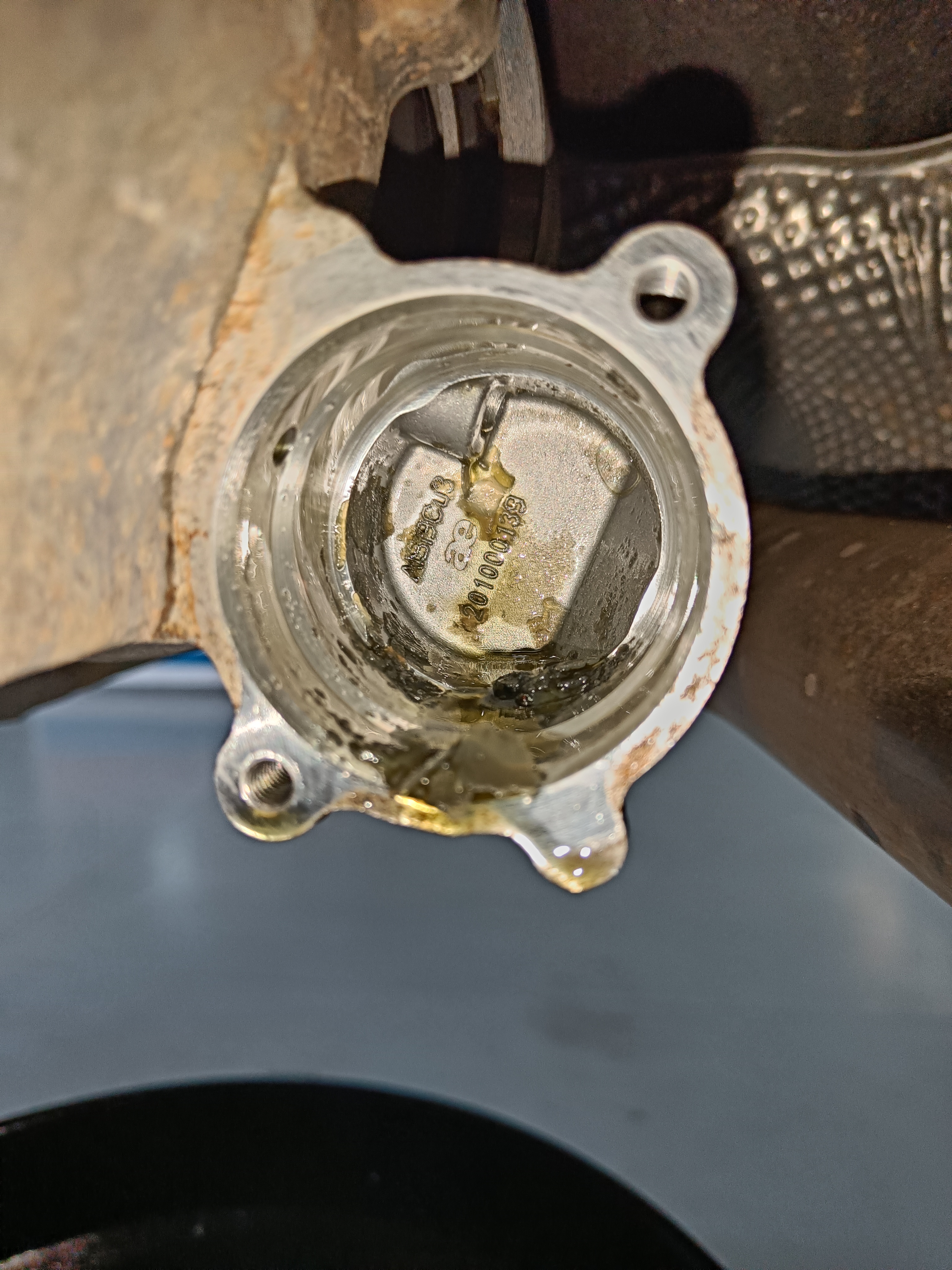

5 hours ago, ApertureS said:
You have drained the diff, not the haldex!
don’t drive the car until the correct fluid is in the correct place
Thank you very very much!!!

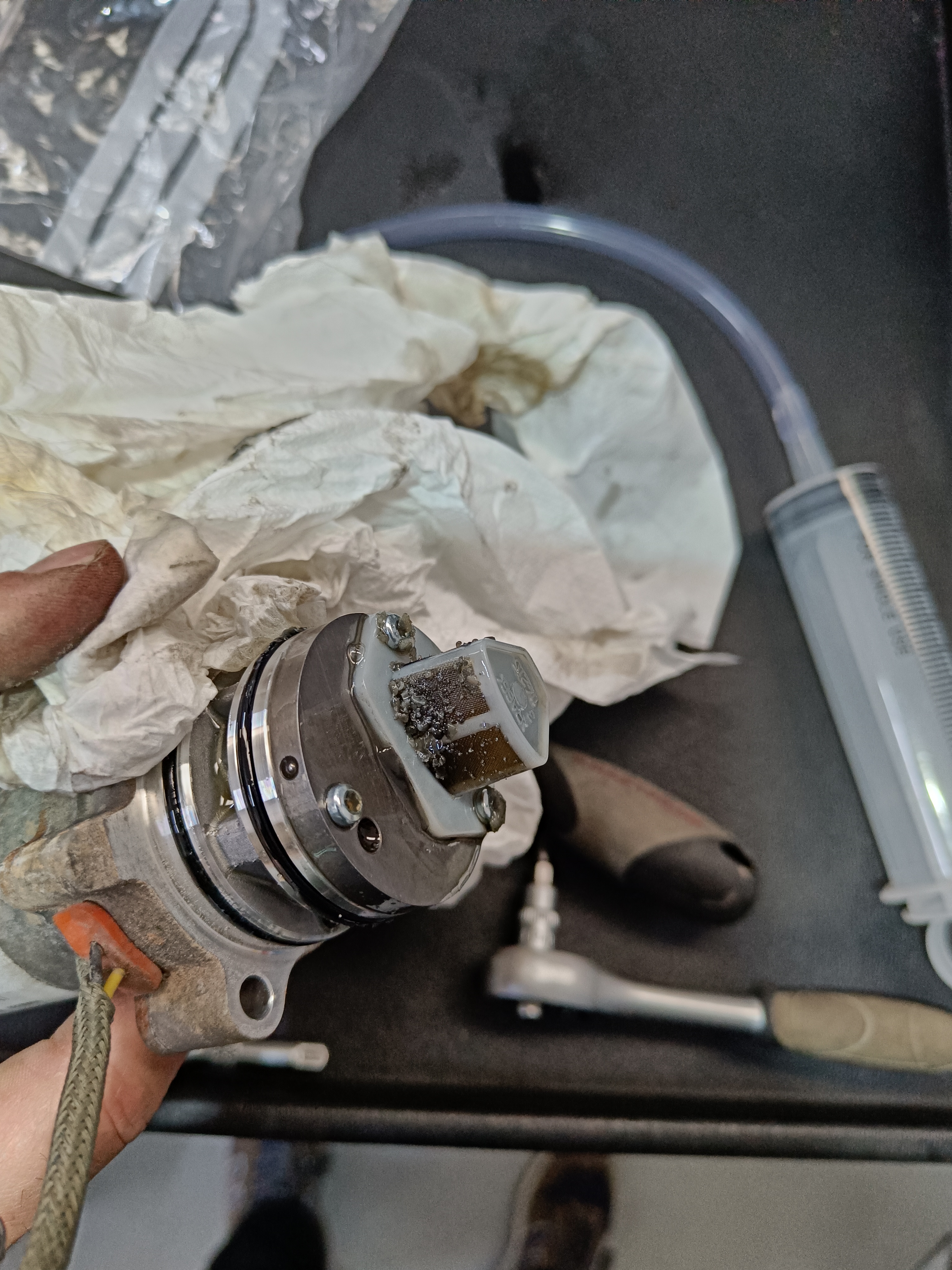

the photos of the haldex.
Not that dirty for a first cleaning of the pump strainer after 70000km.
Good news.👍
Regarding the oil quantity in the diff, take a look on cardiagn.com.
You´ll be able to download all workshop manuals. Chapter « Propshaft and rear final drive » should contain the required oil quantity ;)
