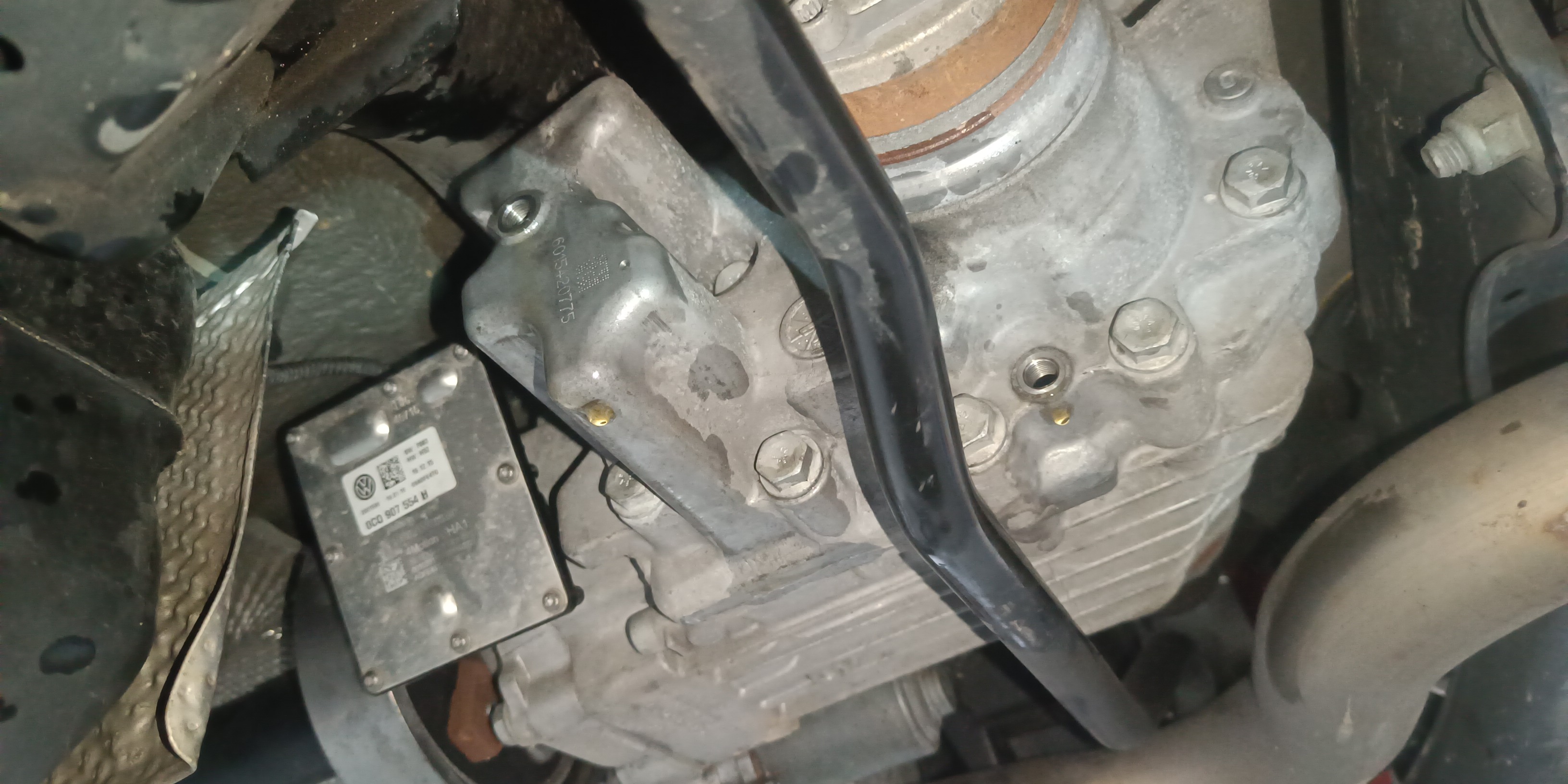

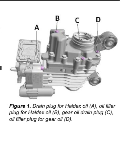

I'm doing it right now and in fact I need urgent help because it doesn't take oil from the filler cap, even removing the drain plug the oil doesn't come out there.  I have started the car but it still does not get oil from the filler cap I do not know what to do.
God how stupid!!  I have removed the one that is not!?
53 minutes ago, Gabrielem said:
You have drained the diff, not the haldex!
don’t drive the car until the correct fluid is in the correct place
Well, it's done! Except for my stupidity when confusing the drain screw, I have not had any complications. I have removed the cable supports, the pump ... I cannot say how much oil has entered but after starting it they have entered just over 50cl. In general it is quite simple, even more than a change of engine oil. The car has just 70,000 km and is the second oil change of the Haldex and the first cleaning of the filter.

It is filled in the same place, right? Que el haldex,no?
Eh, no
I have to drive a few kms like this to the service...
You really need to fill the diff with the correct oil before driving anywhere.
Listen, DO NOT DRIVE IT.
you have messed up somewhere, drained the diff and either filed that with haldex oil or you’ve drained the haldex via the pump as well. In which case you’ve done something big time wrong.
if you drive it you risk £1000s in damages with a destroyed haldex pump, clutch and rear diff….
