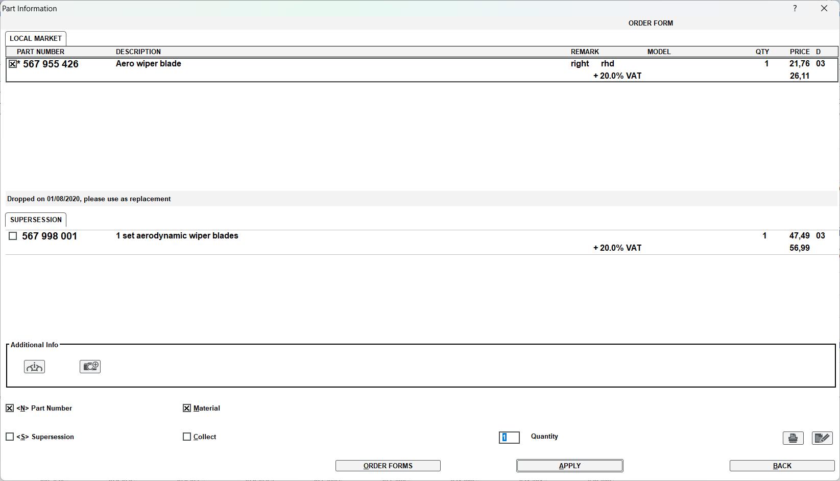

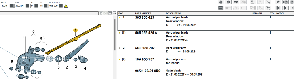

When checking on the parts program, you can see 2x entries for the rear wiper blade.
565 955 425 - Pre facelift
565 955 425A - Facelift (I have not found which Bosch blade fits)
If you look here you can see that the same blade part, the OEM number should be 565 955 425 for a Bosch A 331 H
Which you are saying doesn't fit, so you might be needing a facelift blade

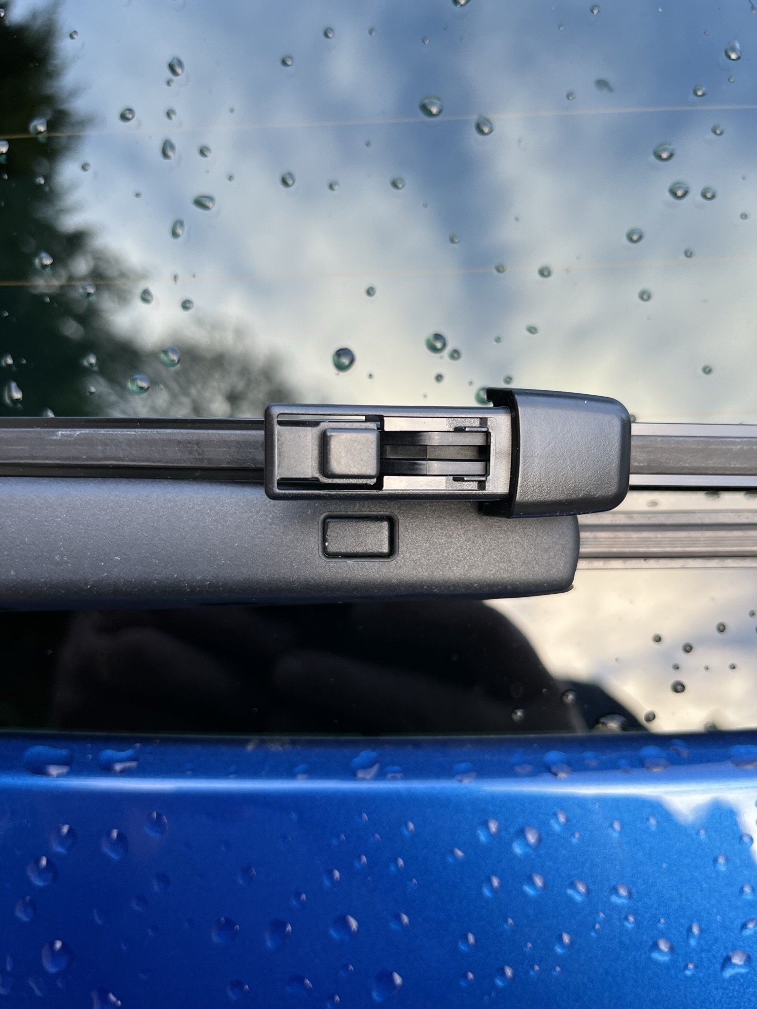

I had a Bosch A 282H 11” 280 mm rear blade I’d bought for my previous Yeti lying around so thought I’d try it.
The blade is the correct size but the cut out in the Kodiaq rear wiper arm to locate the blade locking button is now oblong , and a different design,and the button on the Bosch blade is square. So it looks like Skoda have the monopoly on rear blades at the moment.

Here is the OEM number, that has now been superceded
Part number 567 955 426 has been replaced by 567 998 001, but that new number is hard to find in any catalogs yet.
Using the old number, it appears in Autodoc
https://www.autodoc.co.uk/valeo/13774292
3 hours ago, varooom said:
You are bang on the money as usual.
This is really confusing.   The 1st part number you quoted is a single blade.  The 2nd part number you quoted is for a pair of blades - it's two differnet things.
But as I understand it, Kenny R is saying the front wipers haven't changed - it's the rear wiper that has.
Or am I just being an idiot?

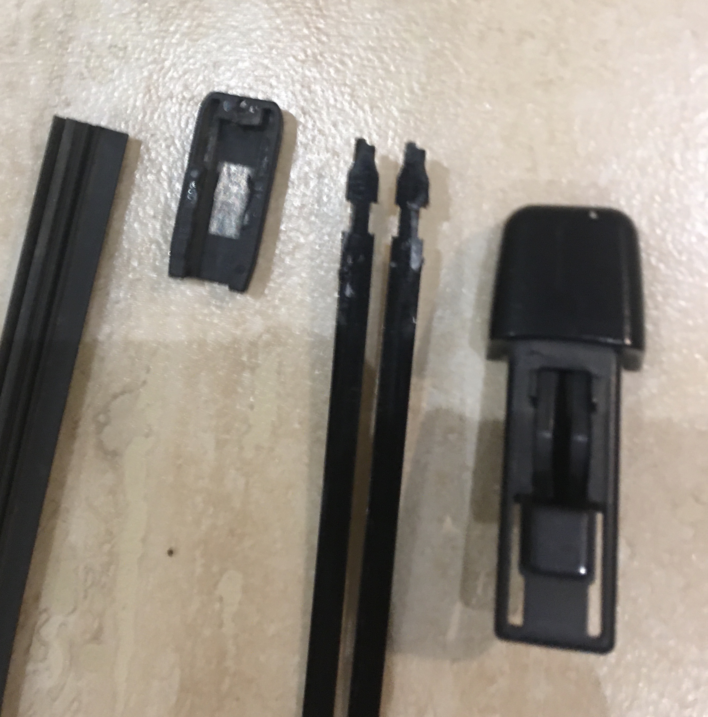

Update on this. I ended up buying a Skoda rear wiper blade. On inspection of the old blade, the wiper rubber can be extracted quite easily from the end.
I then removed the 280mm rubber from a new Bosch yeti blade I had lying, and with a bit washing up liquid to help inserted it in the Kodiaq blade.
Wish I had thought of this earlier, but there you go, if you don’t want to pay Skoda prices , just buy a Bosch Yeti rear blade and replace the rubber in your Kodiaq blade.

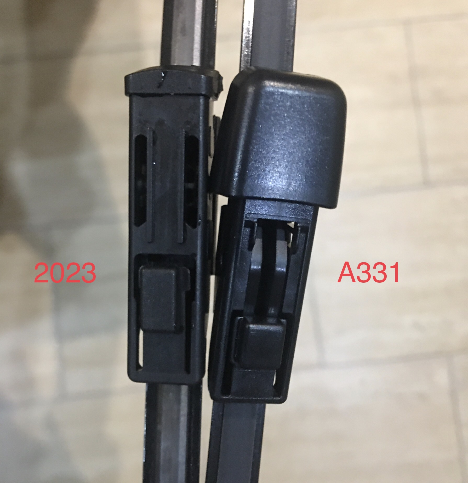

Having just received my new Kodiaq, I’ve joined this club - “my old spare blade won’t fit”.
No obvious reason for Skoda changing the mount.
I’m disappointed my 2 spare A331 blades won’t fit.
But, considering the above tip regarding renewing the rubber blade only, that’s option 1.

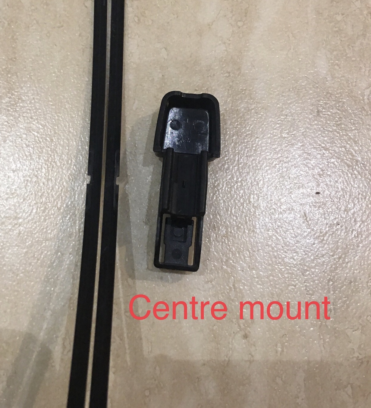

Having now dismantled an old 331 blade, I think it might be possible to simply remove the 2023 central mounting piece and refitting it to an old style 331 blade.  Option 2 for consideration in future at blade change time.
ps - the front screen blade mounts remain the same so my stock of Polo / Kodiaq Bosch blades can be used in future, even though Polo and Kodiaq come with different lengths
