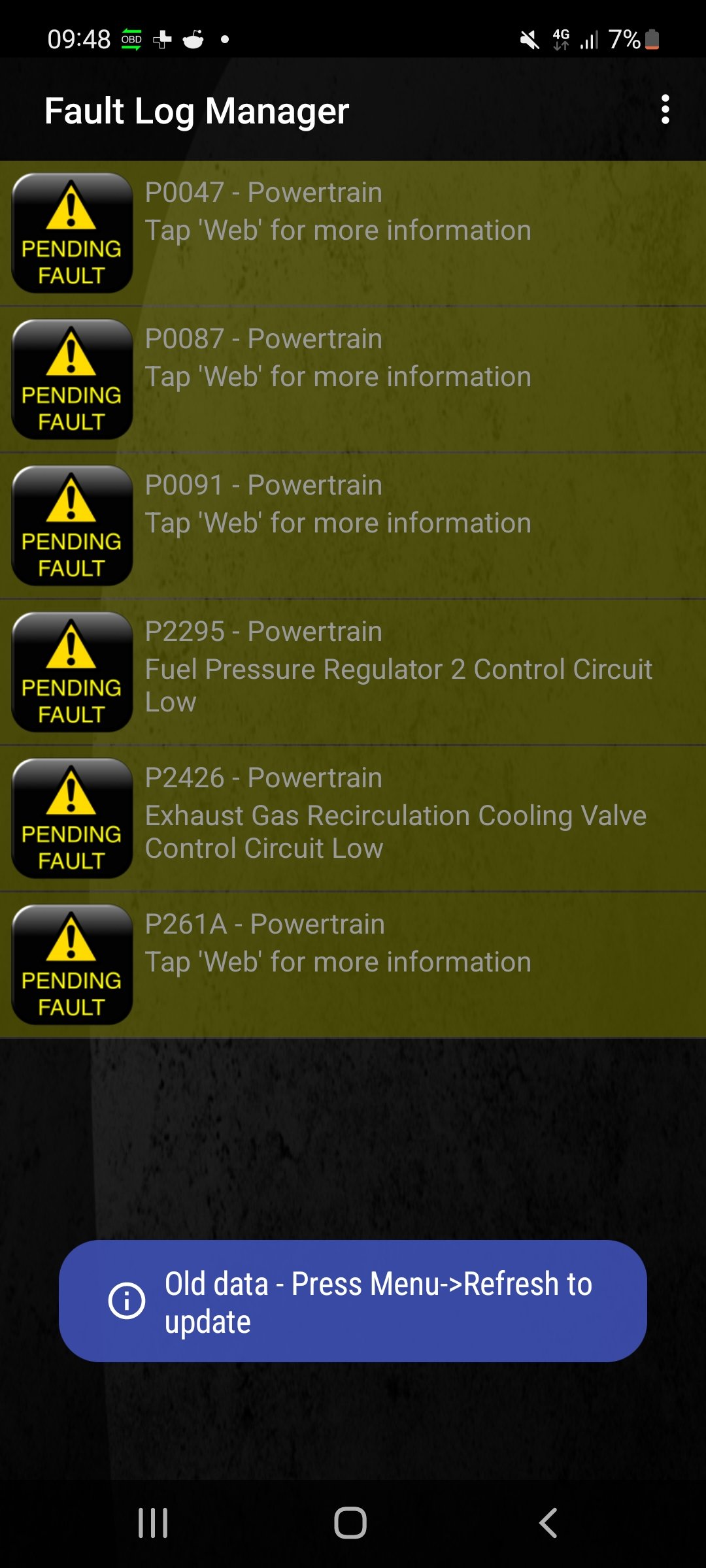

Did pull codes and this is all that came up.
It also keeps blowing the fuse for the injectors.

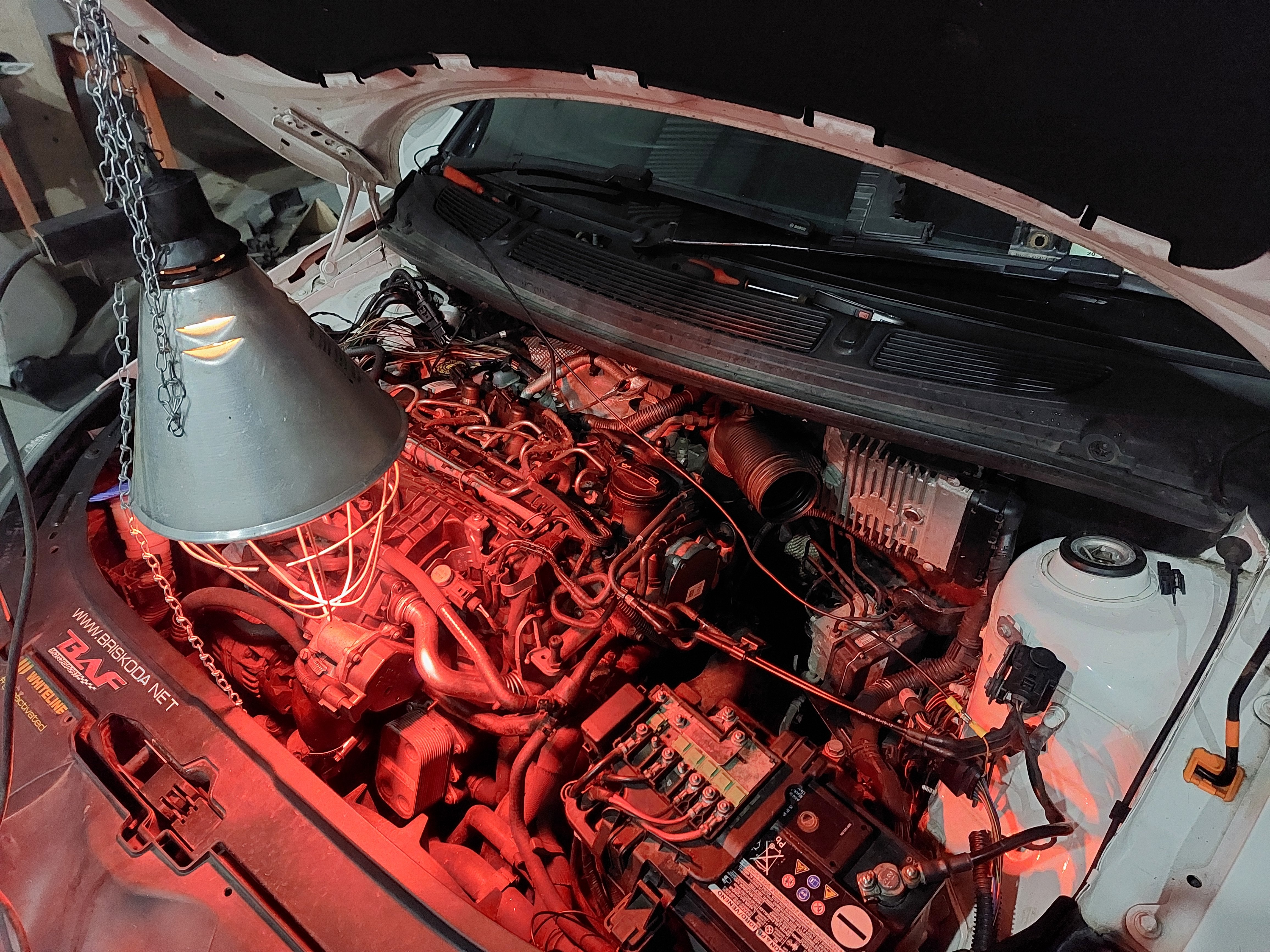

Progress! Found the wire that ran from the fusebox, traced it to a point and as a test ran my own wire around to see if that fixed it.
It did, and that fuse no longer blows.
However, It still won't fire.
Pulled codes again, found one for the high pressure fuel pump.
Pulled the fuse for it and it is blown too.
Replaced fuse, twisted ignition and it popped.
Hoping it's ""just"" shorted itself out too.
Should note that I can hear the in-tank pump priming.
So far as I can tell I have power to the injectors now too.
