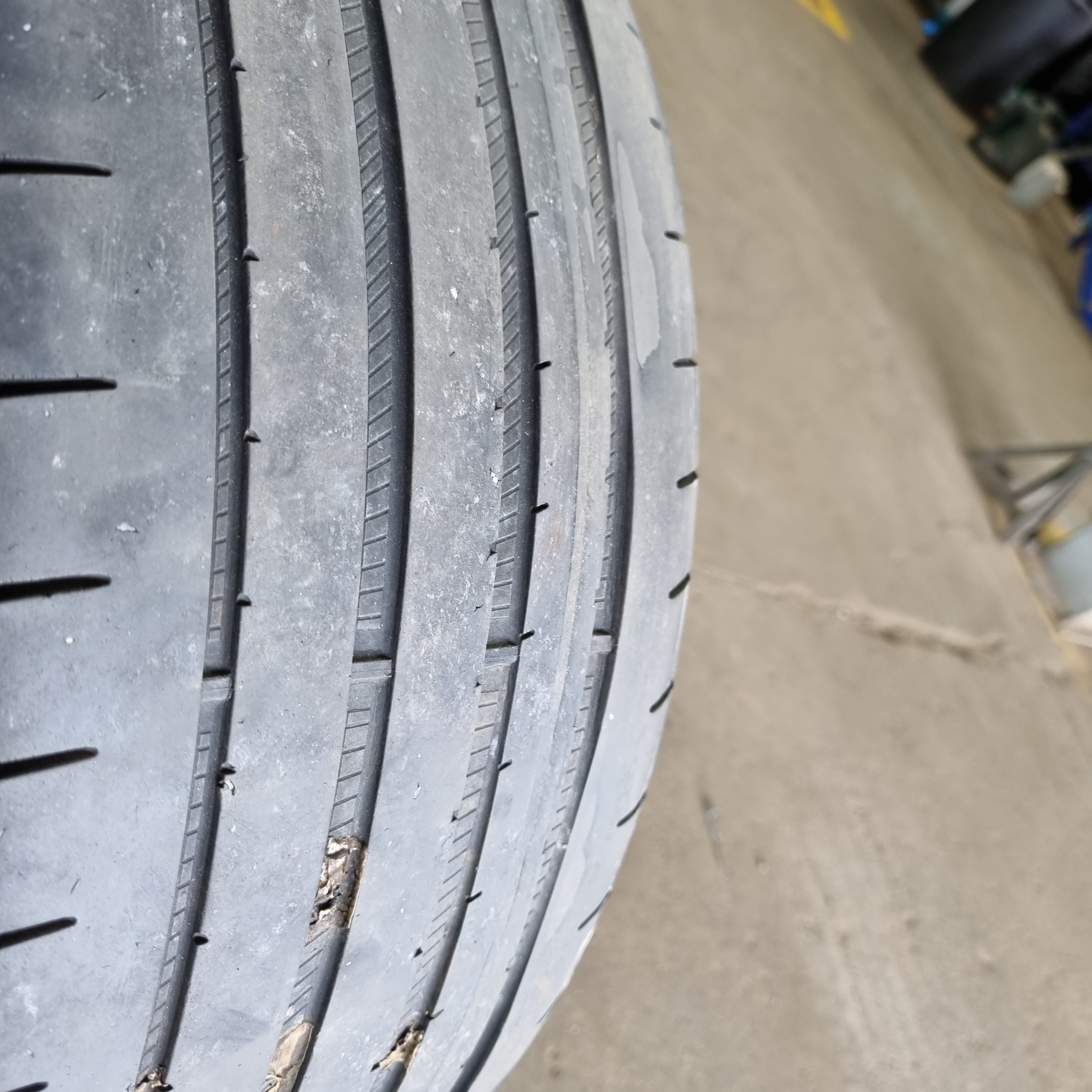

Creaks lock to lock, most symptoms point to front topmounts. Rear toe adjustment is often seized as the bolts were not greased from factory. This can lead to tyre wear. If you get a helicopter or thrumming sound at 40mph+ it may be badly worn tyres on rear which can flatspot (see photo from mine before I changed them)
Octavia's display alot of road noise which is normal but this sometimes masks other sounds.
