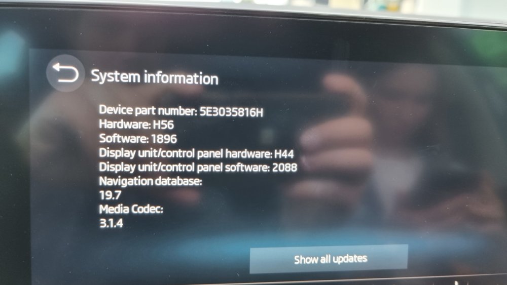

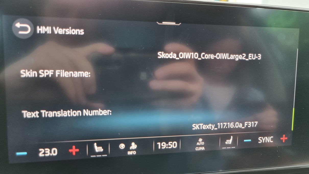

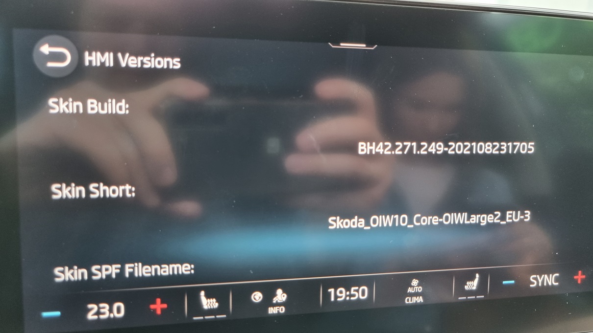

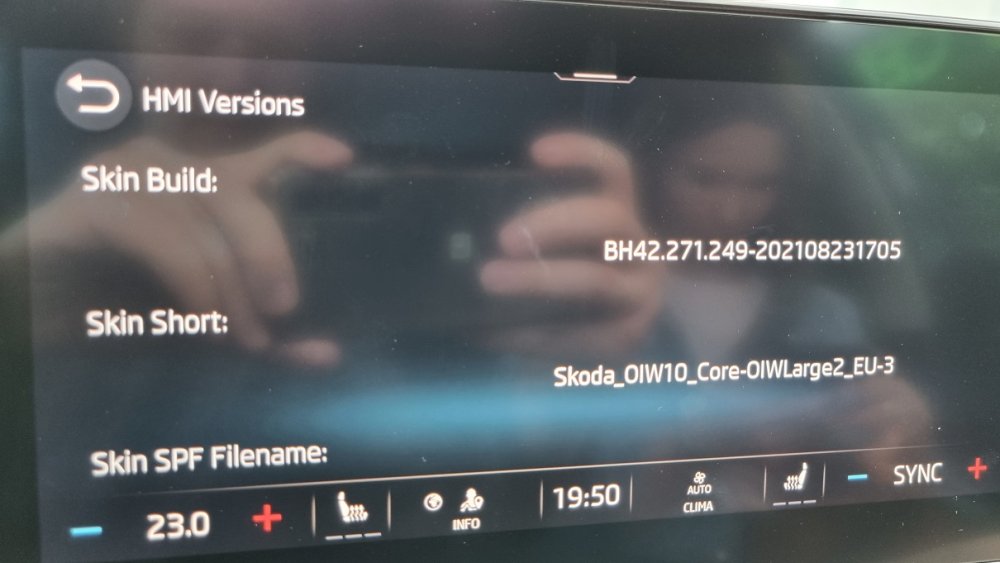

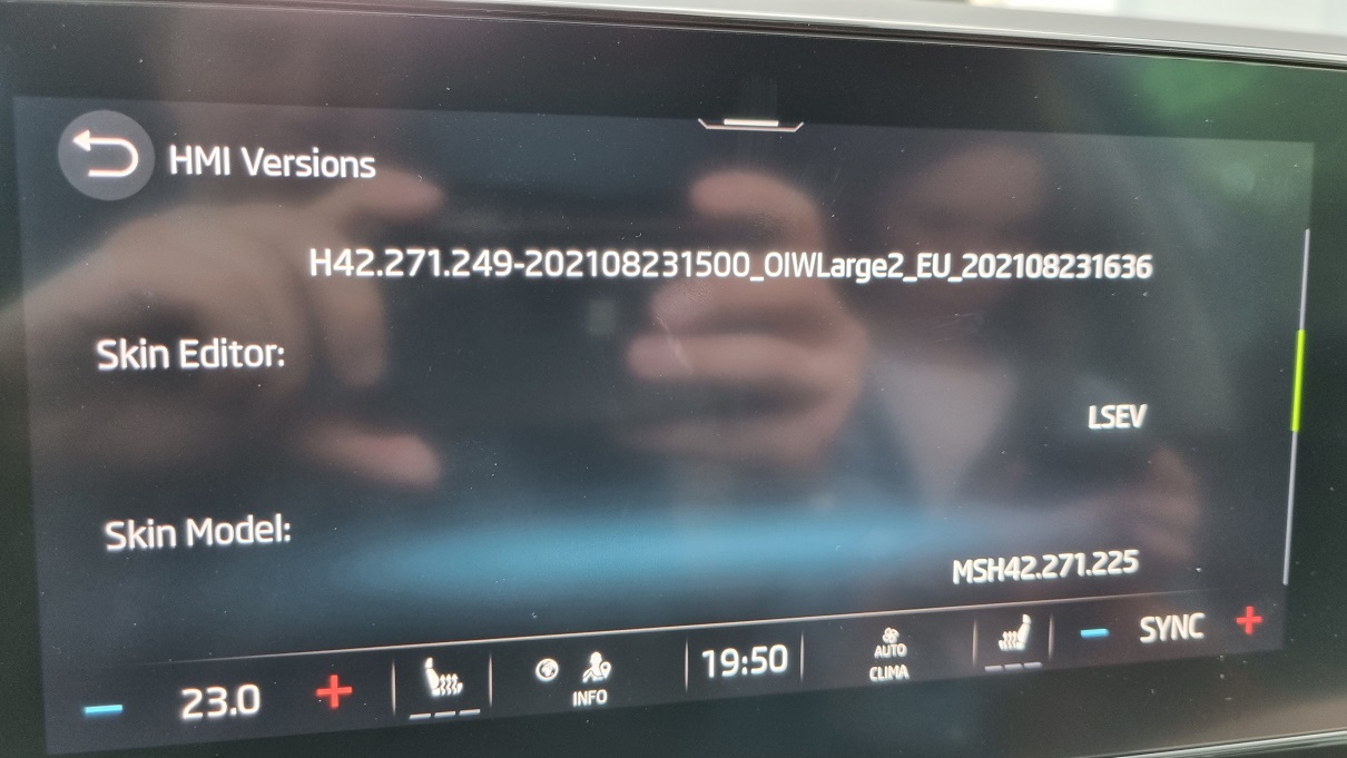

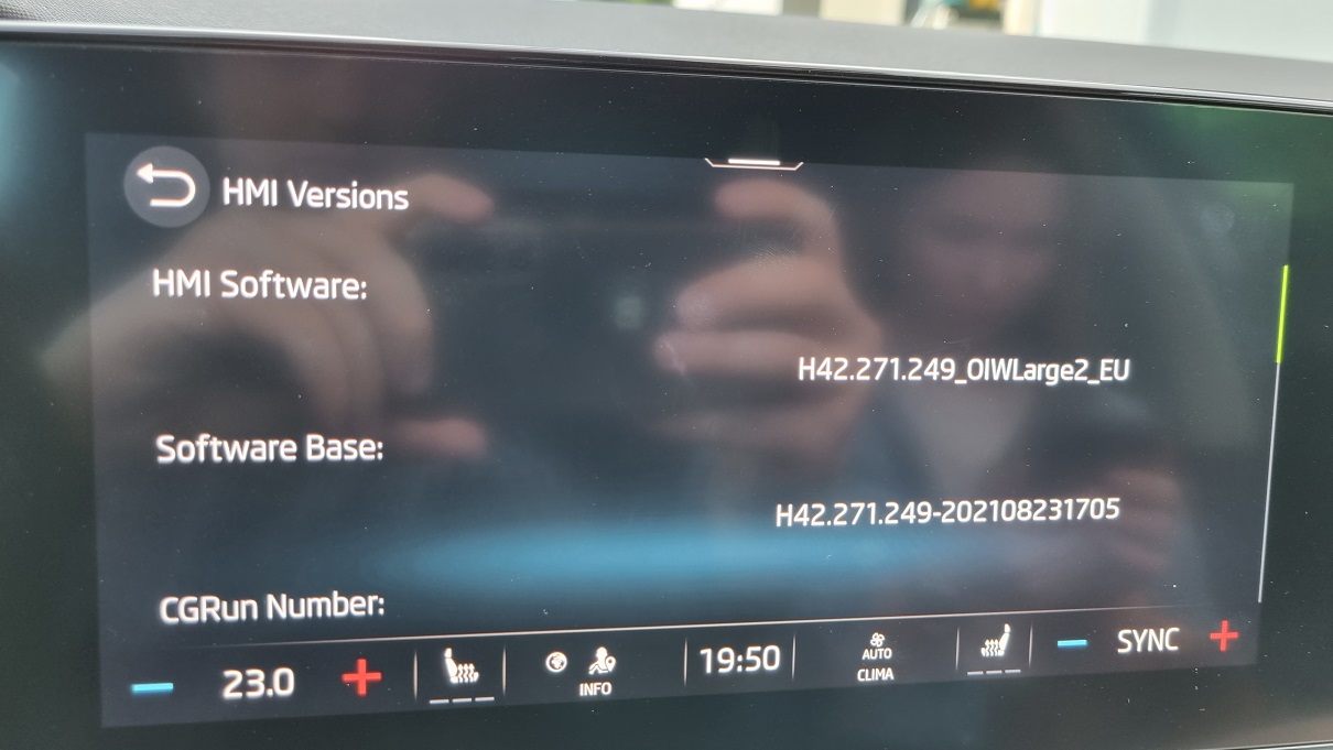

Unfortunately, I don't have OBD. All I can offer is these. In System Information I see no changes.
