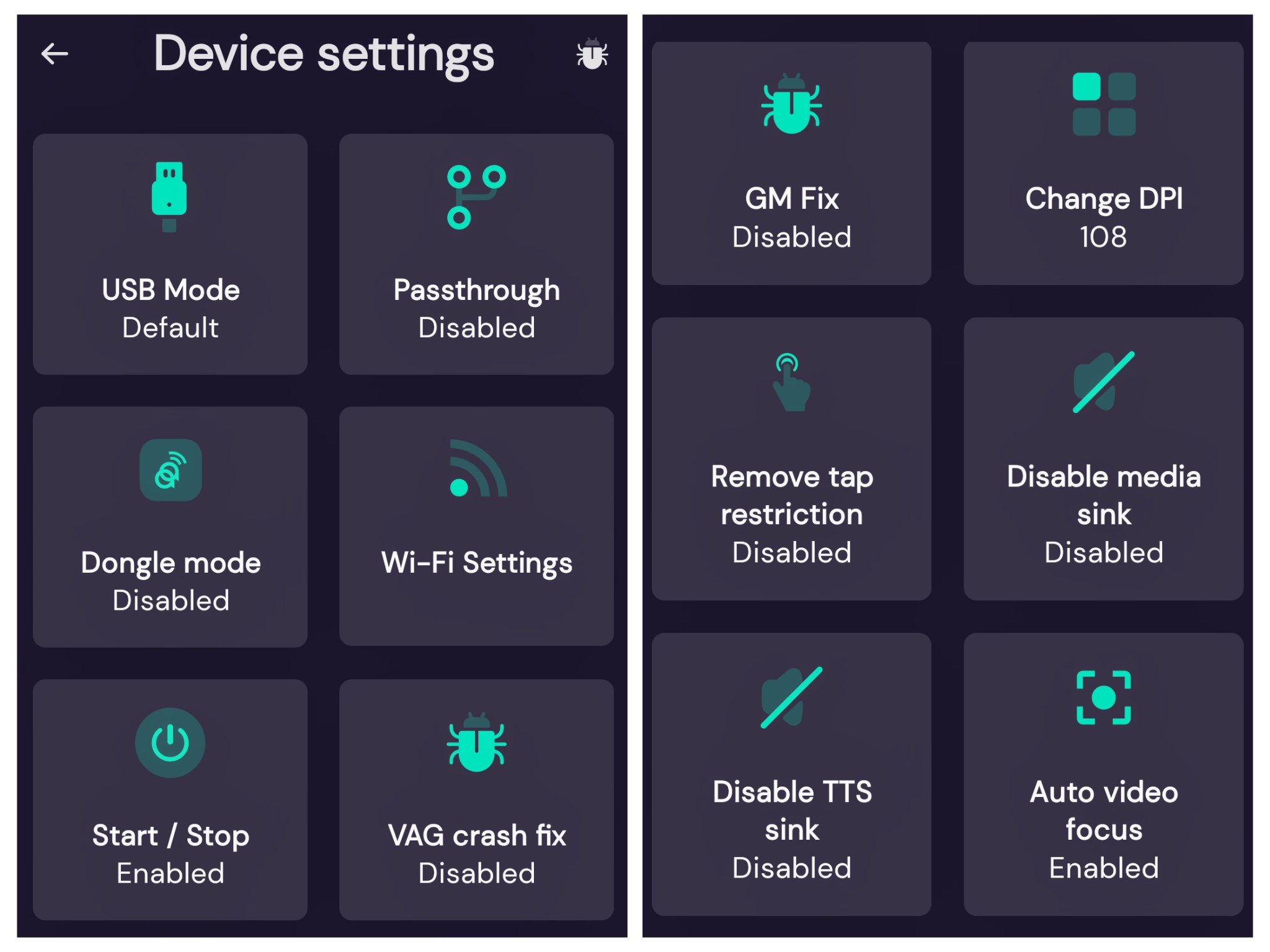

Do you have a special config in your AAWireless? Saw yours and bought one, but mine is always rebooting for no reason
No, nothing special config wise.
Only thing I've changed is the shut off timeout (WiFi Settings) and Start-Stop settings.
My AAWireless device has been really good - no issues whatsoever.

VAG crash fix option disable or enable?
Im not so lucky with mine 😕
These r my AAWireless settings.....
Edited by JR RS
