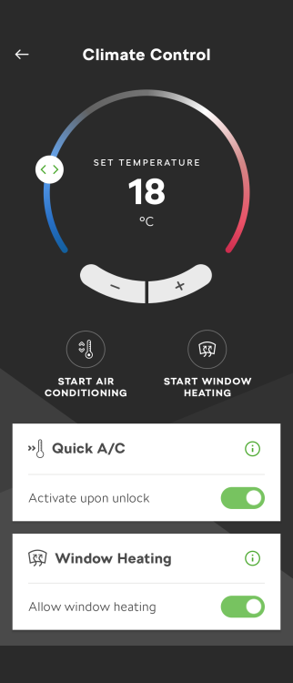

I have noticed when ever I open a door including the tailgate on my Enyaq, the heating / climate control comes on I find this wasteful as I'm often out to my car during my working day to get stock from the boot. My question is is there a setting I'm missing to turn this off and has anyone else noticed this feature. Thanks.

You have it set to come on when doors are opened. This can be turned on or off in the app. I can't give the exact details as my app has not worked for the last 2 days.
Ah thanks Helipilot my app has stopped as well, I will look when it's back up again.

You were right and thanks again for the guidance I've put in a screenshot to help others
Does this turn the aircon off by default requiring the driver to switch it back on when they do want it?
Cheers.
Hi Nicky.
I just stops it coming on when doors are opened. I found this quite wasteful as I'm in and out of the car during my working day
