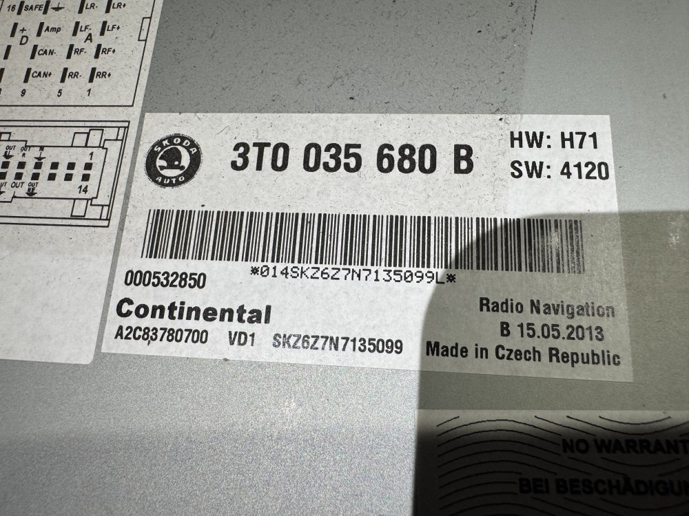

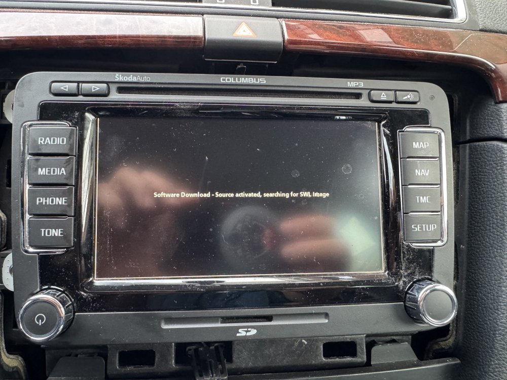

Hi there, gents!
Anyone still here that could perhaps help me? I have the same message in my Skoda Superb 2012 on my RNS510 Columbus. Can any of you folks help me with the firmware, please? Perhaps you guys are still here @pab567 @varooom
Here is my upper case label (3TO 035 680 B).
Much appreciated!!
I'm sorry but what is th emessage you see?
Software Download - Source activated, searching for SWL Image
Can you please help me with the firmware for the infamous error Software Download - Source activated, searching for SWL Image? My upper case label is 3TO 035 680 B.
Thanks so much!
sent in PM
