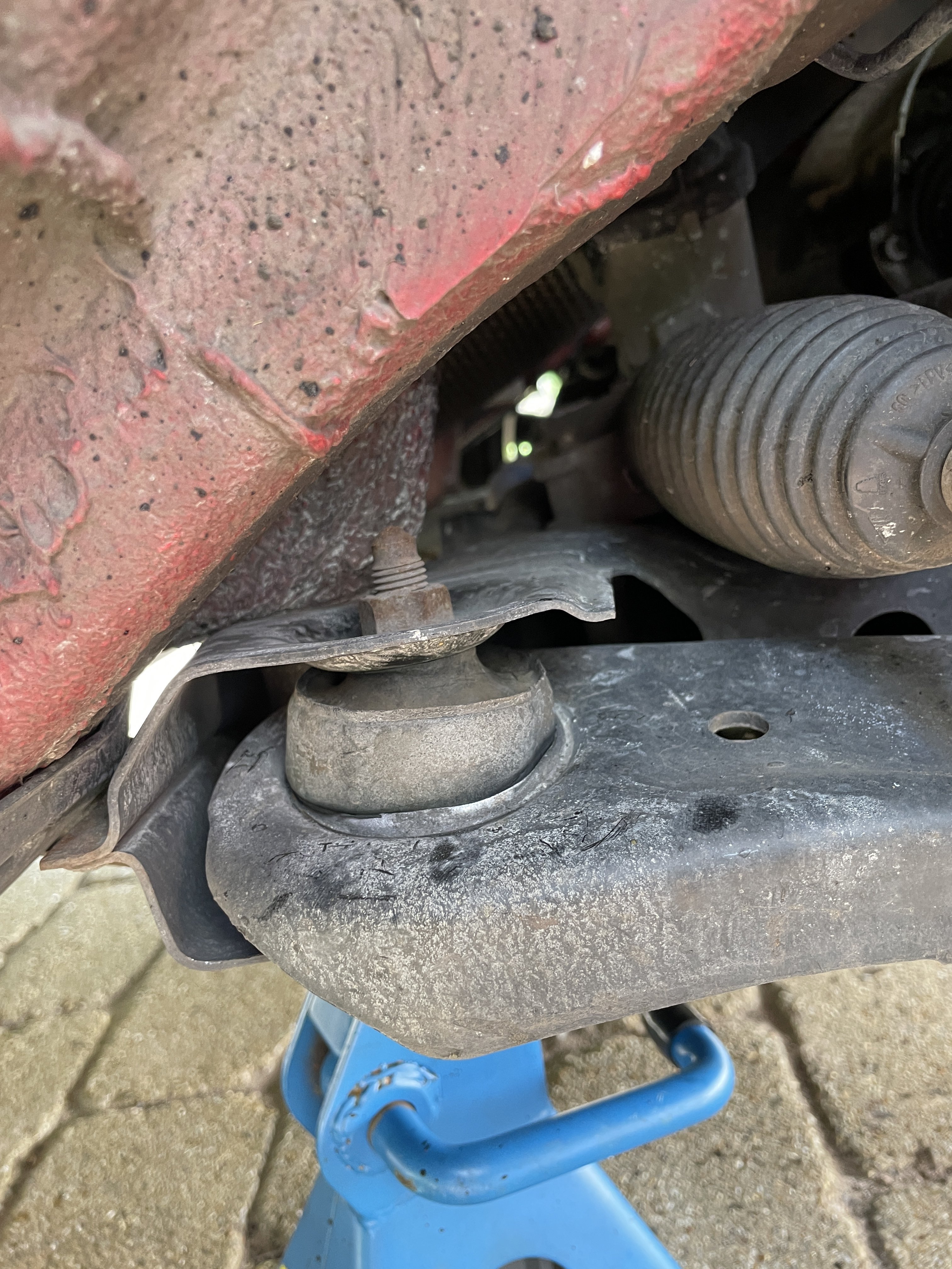

Old forum I know. For anyone reading on this, I've had this problem since ownership of my car in Nov 22. I found out it was my bushes on the front control arms. Dealer quoted me £310 repair for one side, Euro car parts served me nicely with £15.99 for 2 bushes. Did both sides in a day. Would have been WAY easier to replace whole control arm, but hey ho.
Sound has since gone, although it hasnt been cold enough to know for sure. Until next winter!

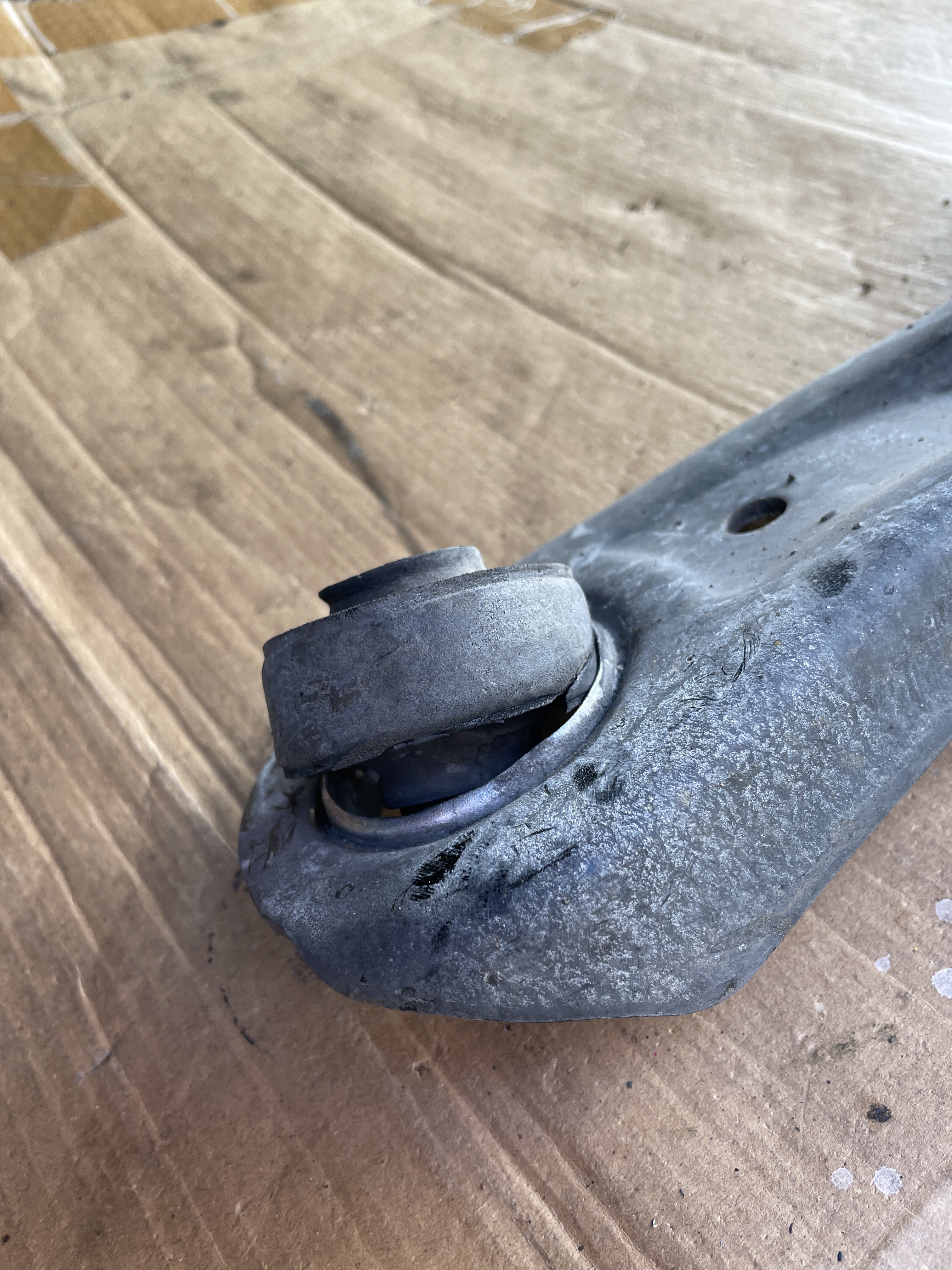

how bizarre! it happened on my mates old mk3 fabia too, must be a common issue. I pinned it down to my bushes as, well, see the picture…

 The complete rubber part had detached, when I removed the control arm it just popped right out.
I replaced them with great difficulty, At first me and my mate tried to use a Erbauer Holesaw to push the metal ring out, then we gave up and I found a bespoke press that my dad had used on my sisters mini cooper bushes. Although it was slightly too big, We managed to push it out using the Holesaw wedged between them.
Getting the new ones in was far easier, Just greased it up, lined up the new one & used the old ring to push them down into place. Took us about 4 hours to do the totally f**ked one, and about 30 mins on the other side as we knew what to do that time!
Thinking about it, I couldve taken that opportunity to upgrade my control arm & bushes to S1 or Ibiza cupra ones. Oh well!
Putting the control arm back in was a bit of a battle, But with a few kicks and shoves we got it all aligned and bolted back up.
I believe the creaking noises i was experiencing over speed bumps or deceleration from a slow speed (ie 20mph to stop) was down to the rubber grinding and the metal ring grinding too, as the pushed up rubber was pushing the control arm down into the frame.
