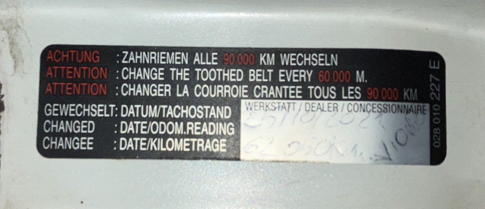

Today looking under the bonnet to have quick check, I've noticed an official VAG sticker, which I had never paid attention to before. It mentions: "Warning: Next timing belt replacement in 90000km". 😳😳😳
What the h*ll is that!?!?!  😬😬
Fundamental change in VAG replacement interval or wrong sticker put on my car?
Now, I can't figure out what's the right interval for timing belt replacement. Every 90000 or every 210000km?

What did the sticker actually say in French BAP33?
I can read what you have written in several ways, the best being that the belt will need to be changed when the vehicle has done an additional 90000km = at 152000 kms, the worst being change again at 90000kms = after driving only 28000kms on this new belt we have fitted.
Was the 90000kms printed on the sticker with a space for the current kilometrage to be written?

Here is the sticker :
To me, next replacement shall be done in 90000 km (at 152000km for me), not AT 90000 (after only 28000km in my case.
Otherwise, there would be no interest in writing the replacement milage / date on the sticker.
But maybe I´m wrong…

I used that part number... and it has not been used since a 2011 car
I smell a rat myself from the dealer drumming up business.
Taken from Superb I factory maintenance... this is the only 90,000km seen in all the books

Looks like they've got a box of old stickers they're trying to get rid of without checking the contents thereof.
That would be an overly forgiving interpretation.
I would say that Varoom is bang on the money, hats off to him for sniffing out the rat!
1 hour ago, Bap33 said:
@J.R.
That makes sense, no ambiguity unlike what you had written which I appreciate was not intentional hence why I asked the question.
As Varoom has pointed out they are on the make!

I discussed with Master Tech from my local official Skoda dealer this morning. That’s exactly what happened. He said it’s bullsh*t. His guys should never have used this sticker.
He was quite nerved to see that his mechanics still use stickers which are outdated for years.
He confirmed me I could remove this ugly confusing sticker and that correct timing belt replacement is every 210000km without time limit.
Just wanted to make a feedback with official information. ;)
