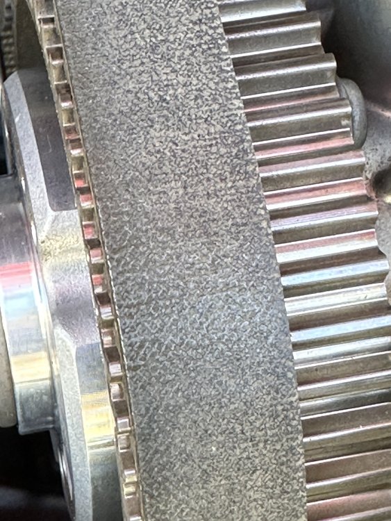

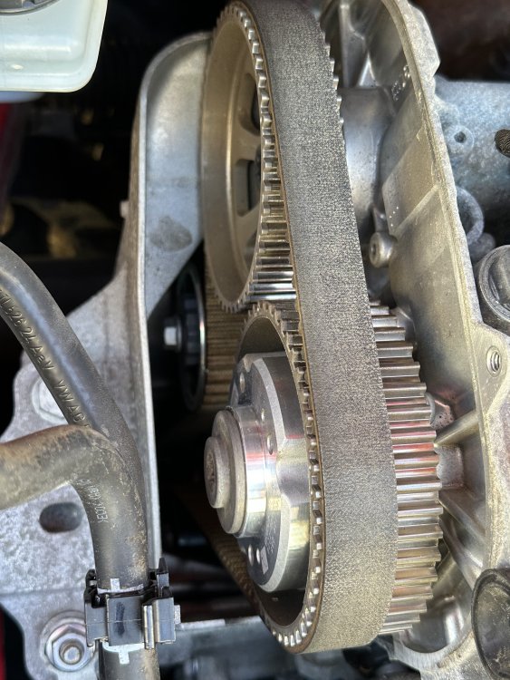

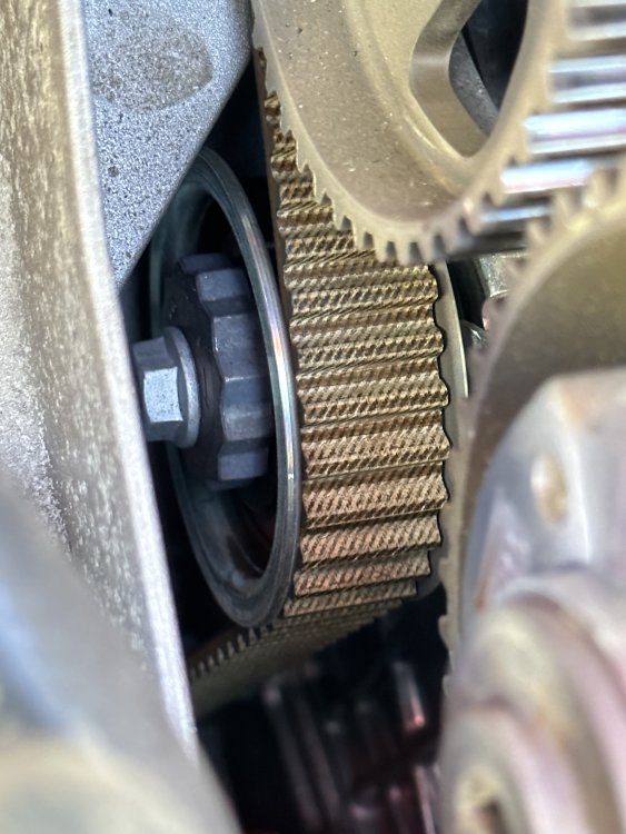

I need an opinion about the state of timing belt
I won’t give any details about age or mileage of the belt yet so it won’t influence your visual opinion about it, I will be grateful for any answers . So what do you think? It looks ok or not, I haven’t seen how different a new one looks like

Are you worrying about the roughness of the non-toothed side?
I can dredge up a pic of a newly-fitted genuine belt fitted to my Polo at a VW dealership that looks identical.
I'd want to see the engine barred-over so that I could see the entire length (inside and out) - but that looks fine to me. Go on, you're going to say that it's original and done over 100000 miles. 😁

77 000 miles on it, probably it is the original one so it should have 8 years and this is why I am worried. I am thinking to use it for another year until I’ll change it 🤔
It looks in good condition, but it does look aged.
But as it is, I see no damage and no sign of it looking like it's on its last legs and about to fall apart.

It looks remarkably clean and schmoo free in there, take care to locate the cover correctly and close all the over centre clips and it should remain that way.
By coincidence I checked mine this week, similar condition, original belt, 120K miles.
The engine manufacturer of the CHYA & B engines, VW, recommend inspecting the cambelt at 240k km (160k mile) intervals, and to replace if necessary.  There is no time limit.  All covered in the service manual (below).  My 2016 cambelt is on 95k miles and running as smooth as silk.
