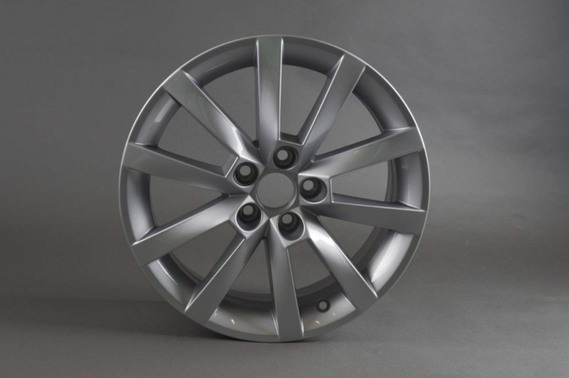

Basically, I'm a complete noob when it comes to rims. All I know is that I have 16'' default ones. These:

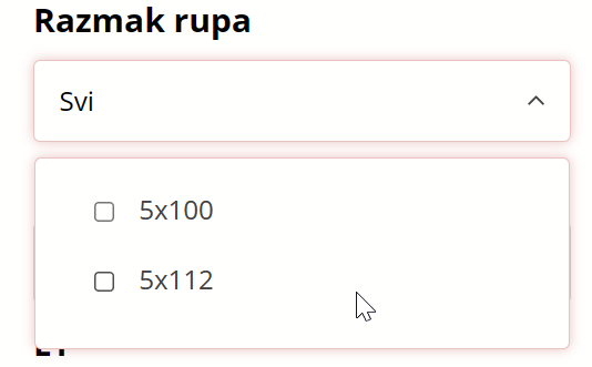

The specs I need are "spacing between the holes". I have these two options:

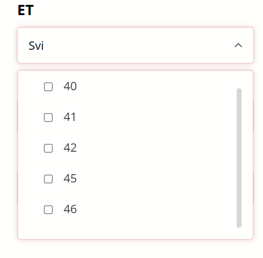

I also have "ET". I have no idea what's that.

Hello Iggy, I'm pretty sure your wheel bolt PCD will be 5 x 112 x 17mm. If your wheels are standard, ET details are moulded into the inside of the rim. Try (Google) a website called 'Will They Fit' a very useful source of data for all things wheel related.
PS. 'ET' is the distance the rim projects from the centreline - giving an indication of clearances to suspension or wing.
CORRECTION - I just checked - Wheel bolt PCD is 5 x 100.

@Carlstonmight be along.  Scala are 100 x 5  though. Same as Fabia & Kamiq.

This seems to be your wheel, 657 601 025 B
Style is called "Alcaris"

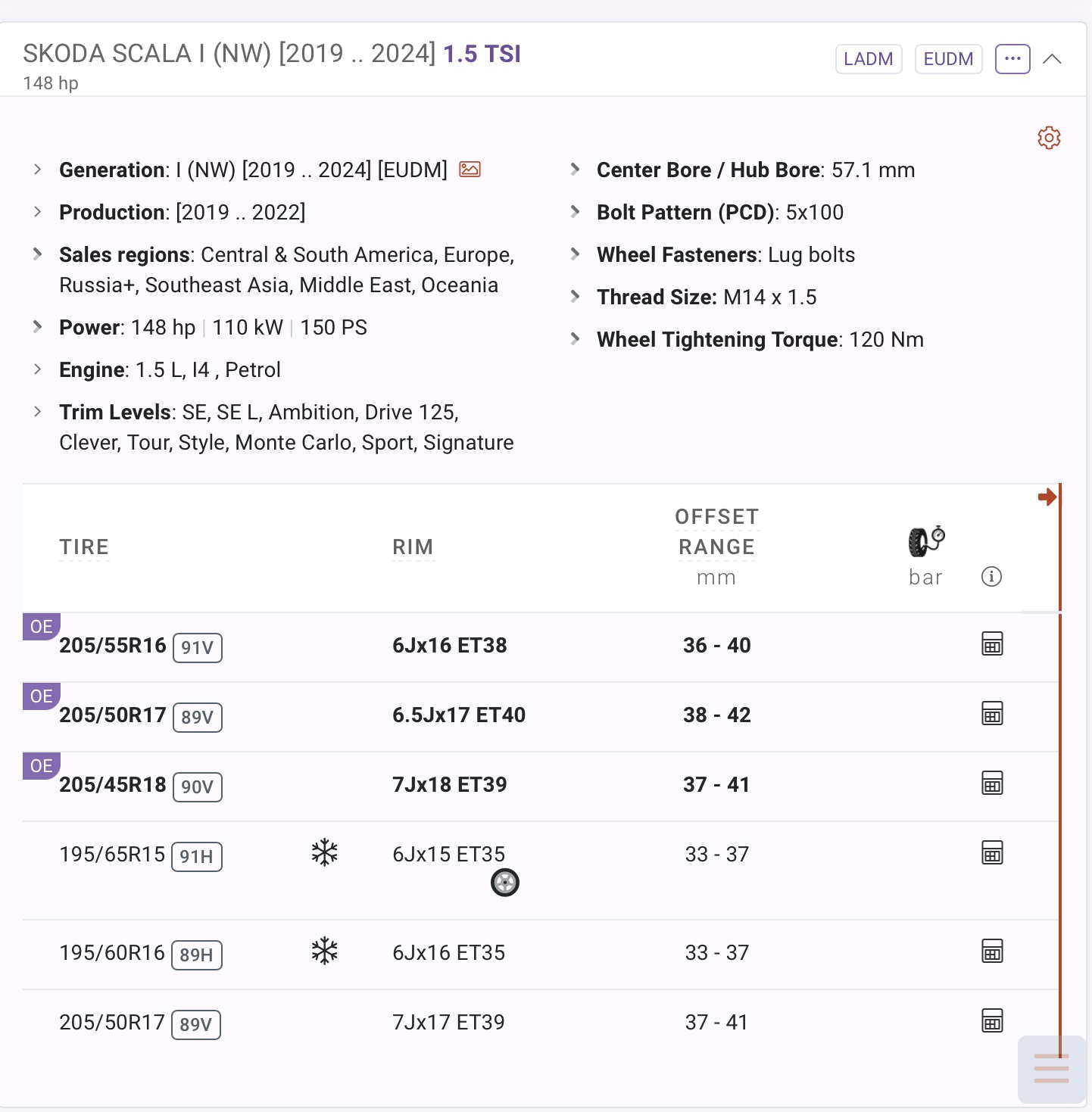

6Jx16 ET38
If you go for 17"
6.5Jx17 ET40
If you go for 18"
7Jx18 ET39
These are the ideal size/offset dimensions, you can stray a little out, I am sure someone will check your choices for what you find.

The 15" wheels on the Fabia MK3 have a specification of 185/60R15 6Jx15 ET38 5/100 57.1
The outside diameter of the 185/60R15 tyres is far too small for the Scala, but you could use those rims with the 195/65R15 tyre size.
The 195/65R15 is a winter tyre size on the Scala and is normally fitted to 6Jx15 ET35 5/100 57.1 steel rims. The ET38 rims from the Fabia MK3 will push the centre of each wheel
3mm further into the wheelarch compared to the ET35 offset.
