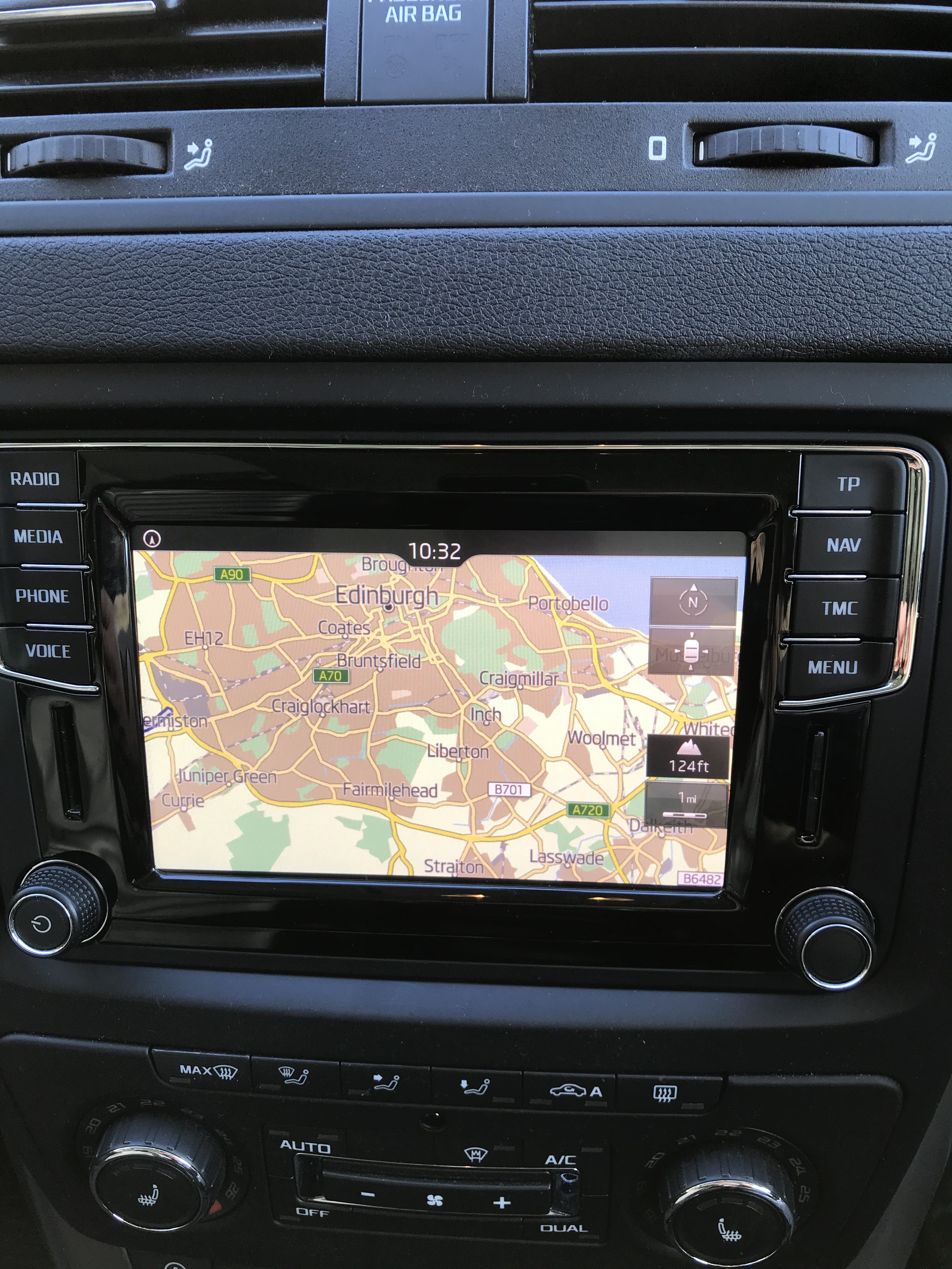

Hi,
I know this isn't a new issue, and I have looked around the forum for specific answers, but the Infotainment head unit in our 2016 Yeti has gone off the rails! It flashes around all functions and will randomly dial telephone numbers as well as switching radio channels etc. The touch screen seems dead and the menu selection buttons do nothing. Safest thing is to turn it off!
Talking to the local Skoda dealership, it looks like they want to sell me a new unit, which would be fine except that they'd like to charge me £1450 for the privilege. I think this is 'slightly' too much, so I am asking the forum two things
Could this fault be repaired at a reasonable cost? Is there anyone in the West Midlands who you could recommend?
If not, are there any after market solutions which people have fitted and which do the job? I'd like to retain functionality of steering wheel operation and the parking guidance malarkey.
I know you are going to ask me what model, I really don't know!! I will attach a photograph...
Thanking you in anticipation

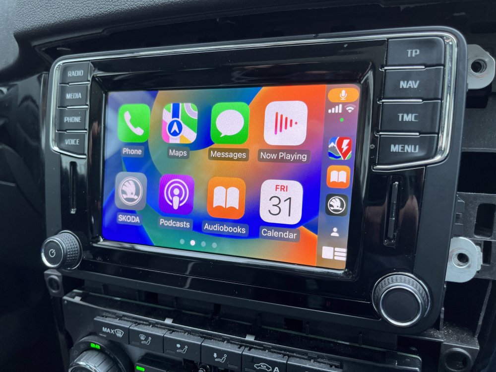

Agreed - just fitted mine this morning - genuinely can’t tell the difference from the original. Very happy with that. Photo taken before I put the trim back on.

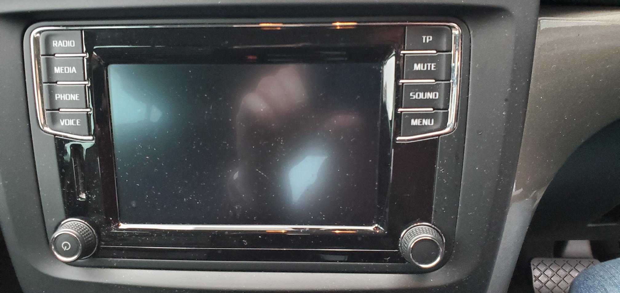

ok, a few days in now. My one observation would be that the original screen must have had an anti-glare coating that the one I ordered does not - the reflection is quite noticeable. The touchscreen itself works perfectly - I may look for some kind of coating to add. I don’t know if @Jamieframer’s slightly more expensive screen might be better for that. I’m not overly bothered as I’m selling the car next month when my company car arrives - just very glad not to be paying top dollar to a dealer to fix this on a car I’m about to sell.
