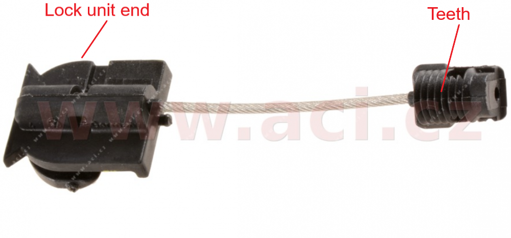

only had my mk1 octy apart a few times, but i imagine theyre not that different. its the tension of the outer handle is pretty critical, gotta count the little thread grooves before and after ;)
If the little bowden cable going to the exterior handle is adjusted too tight it won't work properly.
