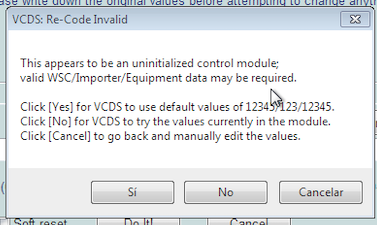

I forgot to say, VCDS says next message, so I copied from old one the numbers:

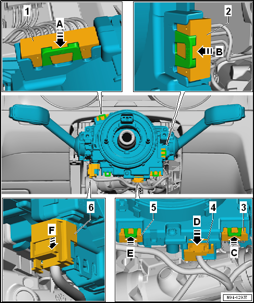

Hi all, I have the same issue on my 2018 Superb. Is there any good video anywhere that shows how to get the clock spring out?
For same part number 5Q0953569A or B there 2 versions for VW and for Skoda. They have hardware difference, Skoda version contains elements for ACC handle.
In most cases, you’ll buy the VW version, which means you won’t be able to code it properly and it won’t work.
Edited by zacko_O

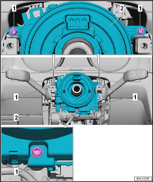

Thank you, I've read the entire topic, I'm aware of the different versions of the clock spring. I am looking for a video that would be as close as possible to the Superb, on how to remove the clock spring from the steering wheel. I've watched a few on other brands/models, and wouldn't want to break anything attempting this 😅
27 minutes ago, zacko_O said:
Nice one, thank you! Would you have same images for the airbag?

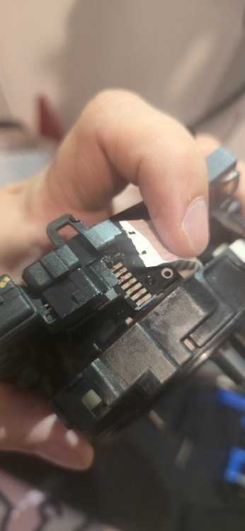

Opened that bitch up, the ribbon cable was snapped, wound it back up, soldered the broken connections and it's all working again! The way the original connection is made, it's just a single point, tiny spot weld, no wonder these break all the time.
These things are totally repairable.
