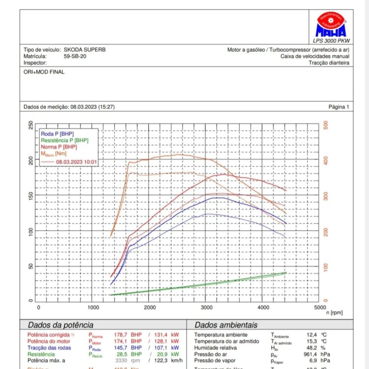

This is mine last week, frim 150hp to 180hp. It feels like the car is way lighter 😃
333327589_1271047933839892_2604746671294575576_n.webp.thumb.jpg.e3f8dbf34efe0f594ad1e8b6d09c6723.jpg
The car feeling "lighter" is a great way of describing it. Look at the gain on your torque curve.
