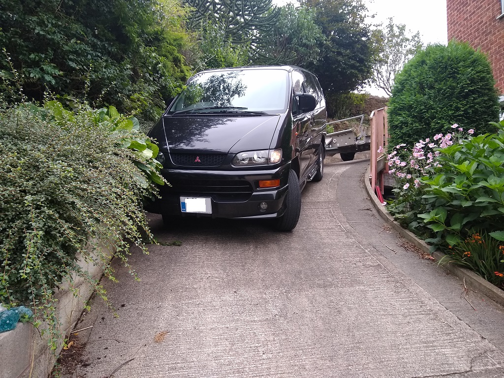

Dug up a pic of the "situation" here. Even this doesn't give a true appreciation of how ridiculously steep it is!
I would think a Yeti 2.0 TDI DSG will be perfect for there & anyplace else.

Yeah, it's a light enough tug with an empty trailer (Ifor Williams single axle transporter, listed at a net weight of just 350kg!)
I've long since resigned myself to the fact I have to load it "up top", although it would be nice to find a combination that allows me to pull up in one precise movement, with the Delica and it's oil-tanker like turning circle, I actually have to stop half way, drop a pair of additional jockey wheels, and shunt the trailer sideways.
There's just no getting away from the hill being a bit of a nightmare for most vehicles, and 2wd things faced with it in the wet will soon start spinning a wheel, there's no doing it slow and steady in a manual, you just have to take your line and go for it to avoid bogging down.
