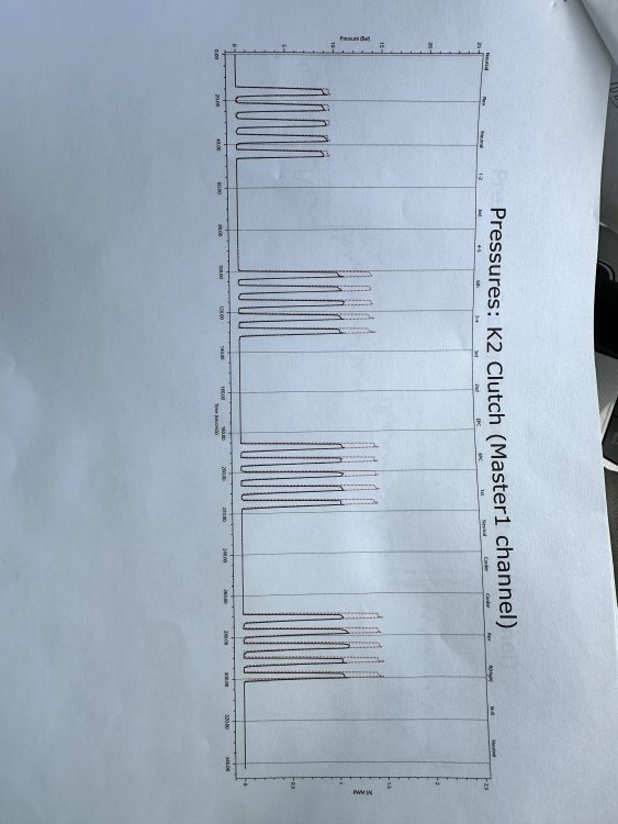

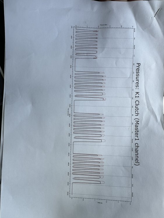

Update. So after they replaced the clutch nothing changed with the car so the same symptoms gear disengagement in 2-4-6 gears (especially when coasting) and lost of reverse gear until stop.
The reason why I accepted the clutch replacement was because I thought the car would be like before with no errors but it will wear the clutch in time due to mec unit being not able to keep it in gear.
The garage told me that the pressure on k2 clutch is too low and this will cause the gears slipping of.
I have attached the photos with the tests done by the garage.
The funny thing is I took myself the mec unit out and send it to ECU Testing and they couldn't find anything wrong with the unit. I just explained them the situation and what the garage told me and they accepted to retest it so I'm waiting for further news from them.
I'm in a very strange situation as I don't know what to believe. Maybe it was a mechanical problem inside the gearbox and the garage wanted to rip me off, maybe is something wrong with the mec unit so I'm totally confused.

I just finally found the problem. The mec unit was ok the problem was inside the gearbox with the output shaft speed sensor wheel G502 faulty. It was spinning around the shaft and I believe that the mec unit took wrong readings from the sensor and that's why slipped gears.
I believe the garage knew the problem as the results provided telling me that the mec unit has low pressure was fake but it was more time consuming and the fix a lot cheaper for them so that's why they told me the cost will be £3500+.I have managed to weld that sensor in place and now the gearbox is working again.
