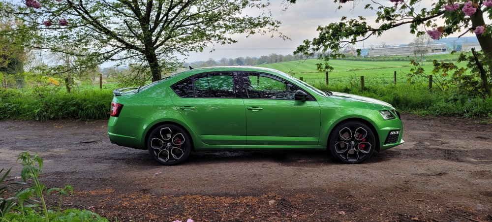

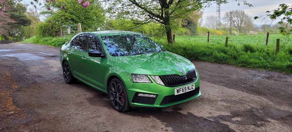

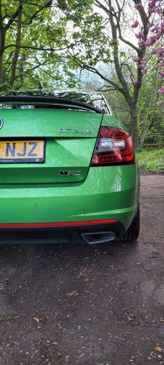

  • There she is, for anyone interested
  • So, im now the happy owner of a mk3 254 challenge 😁 First impressions are, its a cracking car. Love the heated seats!! Only used to the seat pad being heated in my old car. Also, wasn't aware the

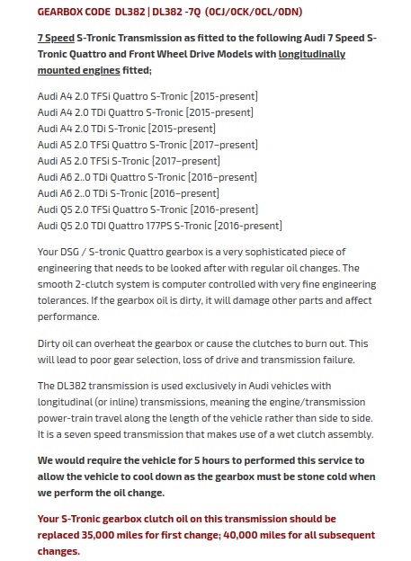

A 7 speed wet clutch DQ381 DSG as might be fitted to newer 2.0 TDI's or TSI's FWD or AWD have a Service Schedule of 80,000 miles then again at 80,000.
(If you think you could actually leave them that long, as in car maybe ready for the scrap yard on a low annual mileage car and the DSG never got to a second service.)
Edited by toot
Not seen them listed like that. Can we assume that the 382 is a variant of 381? So why are they different schedules? Like you suggest, just don't leave it that long. Considering how sensitive the 250 is to it's 40k service, just call them all 40k. But then you get the other man's going with differences again. I'm sure Audi did the 250 at 38k.
The DL382 is the revised version of the DL501.
Audi's 38,000 miles S-tronic service intervals is probably Audi being one up on VW / Skoda / Seat.
I think it was for the USA first and foremost but maybe not.  (i will stick with that though.)

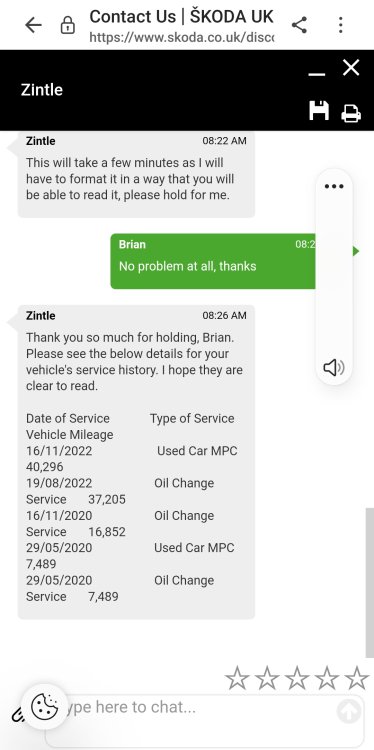

What we're the warranty/service options on the mk3? I'm guessing at 80k, there's unlikely to be a stamp for the gearbox service unless servicing has been kept upto date at a main dealers?
The records are online. No service book for stamps.
You need to be checking for proof of what done when.
Manufacturers Warranty is 3 years unless before first registration the option of 4 years or 5 years was bought.
