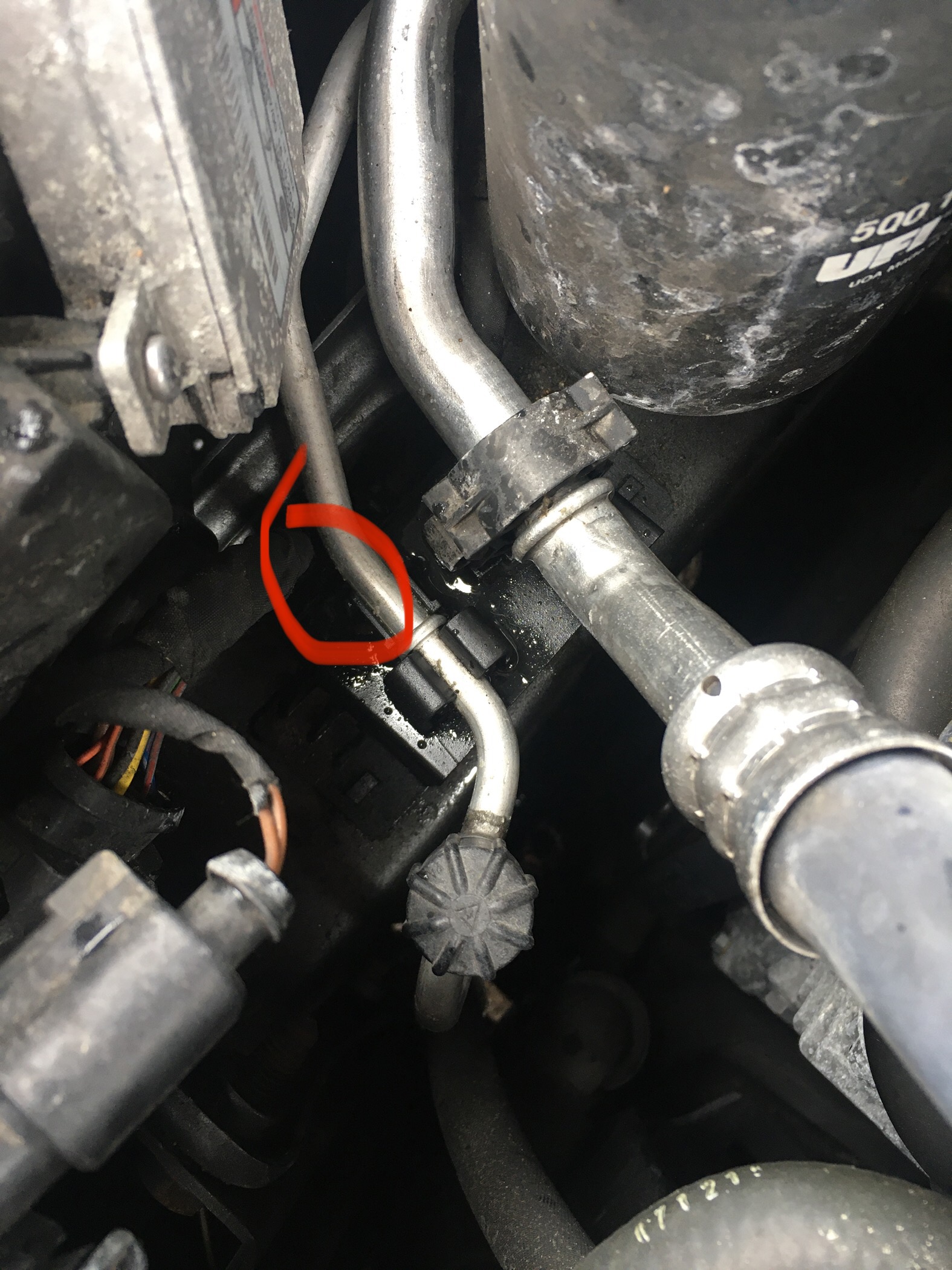

Had my car booked in for a recharge, drone back lovely and cold, lifted up the bonnet to see the fan spinning lovely, then I heard a hissing sound
Saw where it was coming from and it’s by the cable which goes into the back of the headlights moved that and could see it all ****ing out :o
So I do indeed have the first ever problem in the car and looks an ass to fix doh
you can just about see the thicker cables for the headlight, could of have really made a hole from rubbing? :o
p.S on that picture I moved the headlight cable slightly, might be worth everyone here moving the cables just in case.
Heard back from the dealer seems like £720 ish to sort, parts and labour, I hope that includes new refrigerant too

No idea how that passed any sort of vacuum or pressure test prior to refilling, so ought to include refill after repair -  looks like an error in their process.
If you message me your VIN I may be able to find a price for that pipe, if you're curious.
Yeah not too happy about that, I found the pipe and it’s £270 or so on ETKA mine said £299 but not updated price in a while
No idea how much main dealers charge per hour but roughly £330 for Labour which I guess is a good couple of hours to replace as it does look fiddly

Can someone here please take a photo of the high pressure pipe on your car with xenons?
 I’d like to know if the headlight cable touches your high pressure pipe like mine did
