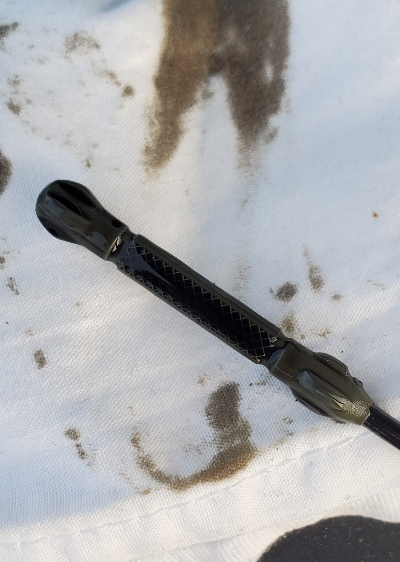

Look at this, to me the top right knobly bit has oil over it... So it's overfilled? Or does it have oil on it? Maybe not to look at but to touch it's oily, or is that where it hits the tube on the way down and up? Haha
