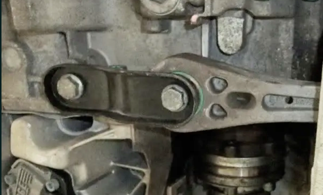

Also have you checked all the engine mounts in particular the restrictor under the car between gearbox and body.
Sometimes the securing bolt shears or can be loose.
Edited by xman
I've not, is it easy to locate? I did suspect engine mount because the engine seems to move quite a bit when it's running. But I would have thought the garages I took it to would have picked up on that. At least one of them anyway.

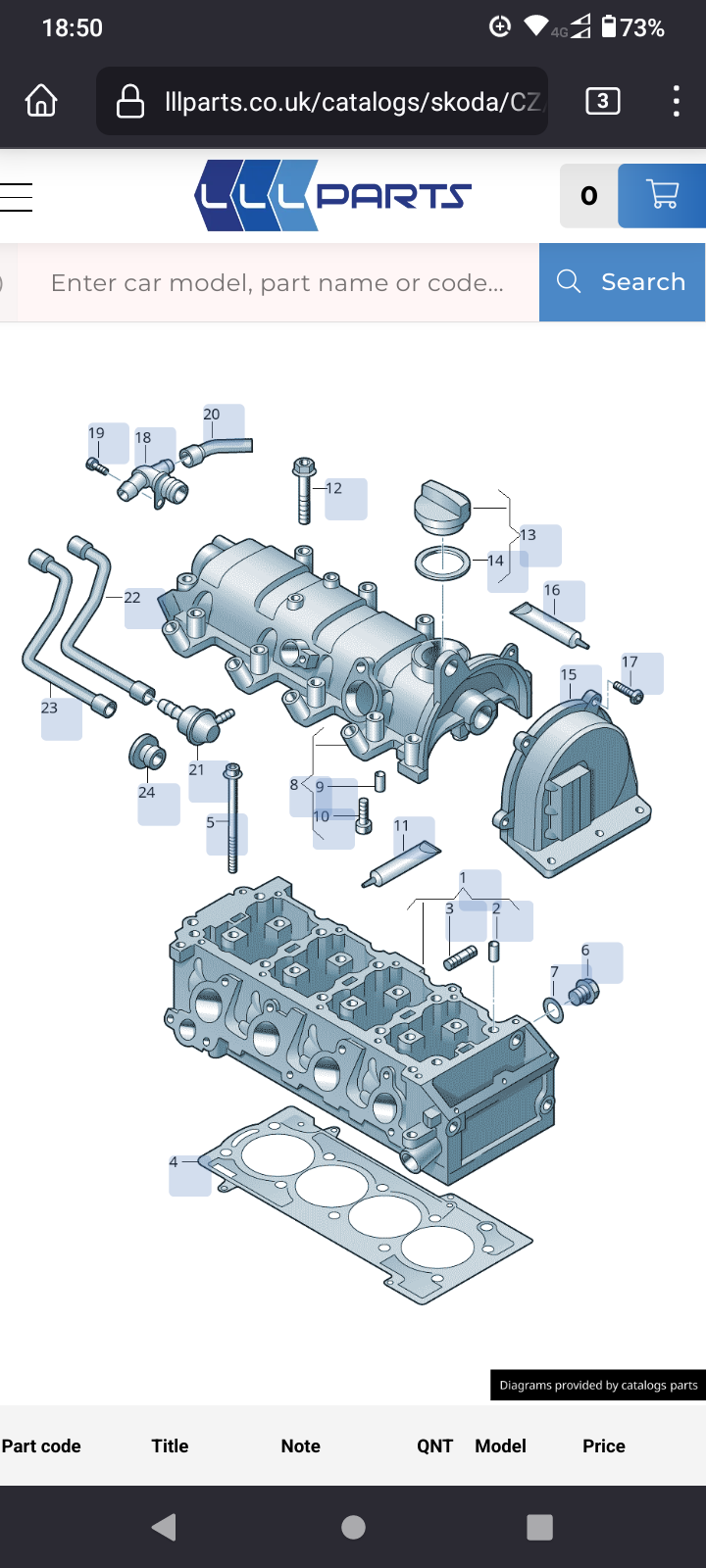

https://www.lllparts.co.uk/catalogs/seat/E/LE/703/1/199/199065
Part 27 on the diagram I think
You need to have car up on a ramp to see it properly. Maybe if you jack up gearbox side, remove wheel youll be able to see it.
Maybe looks like this (looking up from directly underneath)
