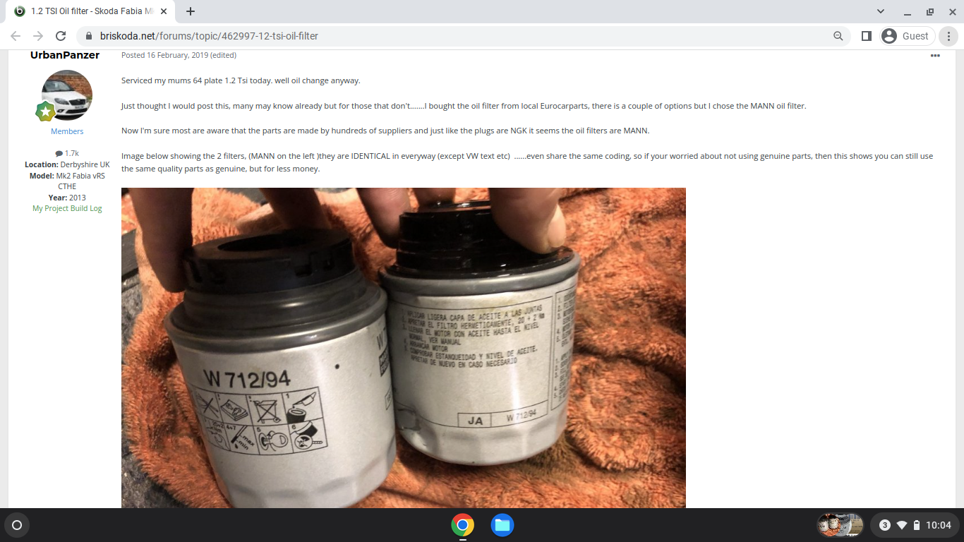

(So they actually had Black Oil Filters from the factory /OME,  as before VW /SEAT, Skoda, Audi went to the silver ones.)
The 1.2 & 1.4 TSI Twinchargers Oil filters were the black ones from 2010 until VW Group went to the Silver ones.
(I kept using Black Mahle filters with Twinchrgers.  £3.45)
As to the 1.2 TSI's.  In 2012 there were threads / posts here when the Oil Capacity changed with the 1.2 TSI's snd there were also ones with the wrong oil filter supplied / fited.
I do not mean black or silver, actually the wrong part number.
http://briskoda.net/forums/topic/442488-oil-filter-replacement-problem
http://briskoda.net/forums/topic/462997-12-tsi-oil-filter
http://briskoda.net/forums/topic/488571-12-tsi-larger-filter
Then we have the threads / posts on over tightened Oil filters and the ones were the old seal was forgotten and there were 2 on.
http://briskoda.net/forums/topic/388209-12-tsi-red-oil-light
http://briskoda.net/forums/topic/450278-oil-warning-light-intimitent

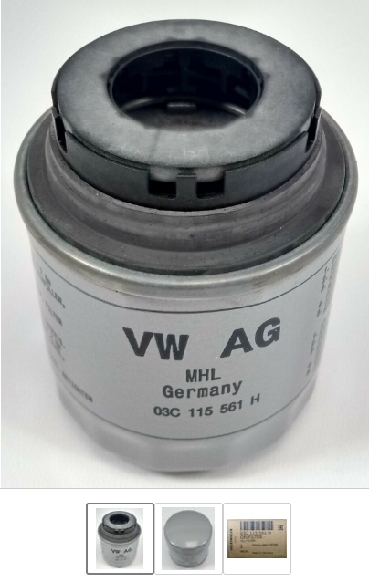

For the sake of around £50 or so and 15 mins DIY I would buy a genuine Filter from a reputable source (not EBay or Amazon) e.g.
Mann W712/94
VAG 03C 115 561 H
Mahle OC 593/3
Change the oil and filter (3.6 - 3.9 litres vw spec 504.00 or 502.01 oil required)
To eliminate possibility of blocked/faulty/counterfeit chinese filter  (counterfeits are more common than most people realise)
