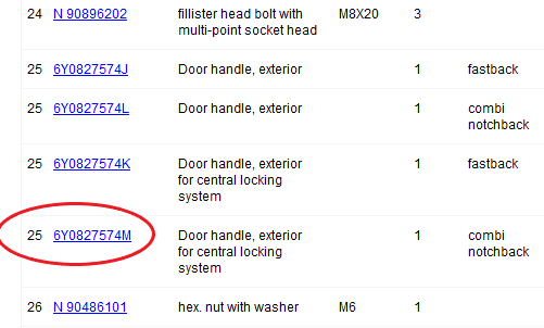

Hello team,I am trying to locate at a sensible price a boot release handle for my 2005 Fabia Combi 6Y5.My problem is that I keep getting conflicting part numbers,for example : 6Y0827574M   This is I think the correct number, but I get lots of search results that say it should be a
……74K or L .In my searches I assume that the hatch back model boot release is different to the combi, am I correct in assuming this.Thank you in anticipation.
Yes, the hatchback ones are different. The first number you gave is the right one for your Combi if it has central locking.

Just to satisfy my curiosity,does anyone know what the actual difference is between the rear boot door handles on the Combi and Hatchback ?

Compare google image results for the two part numbers would be my suggestion.
I have looked at all of the images I can find,they all look exactly the same to me Pete,the only things that can change is possibly a longer cable or the angle of fitting due to different rear doors.
