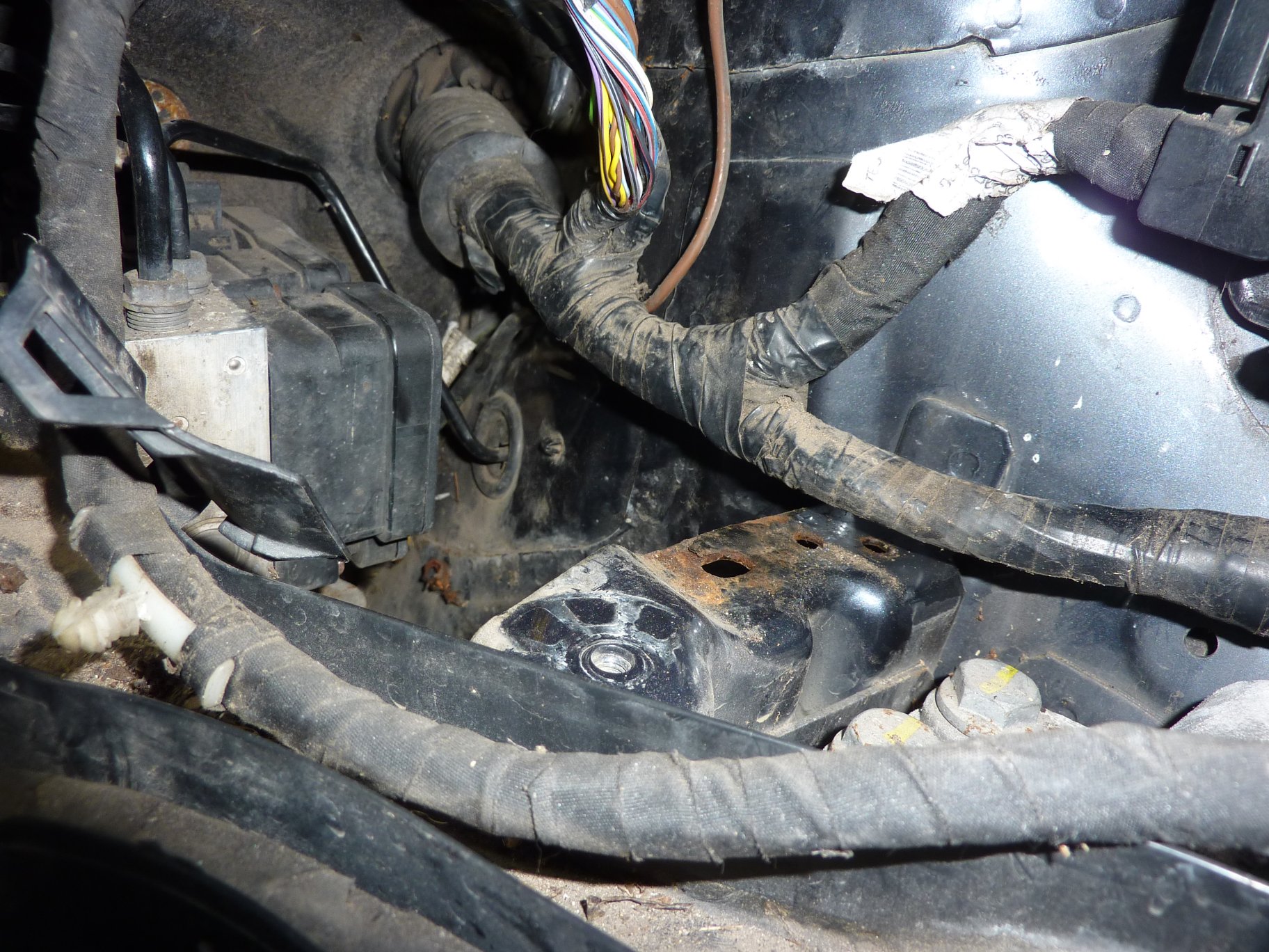

Well I decided to have another look at this problem. I have removed enough stuff around the battery to see that the wires join a big bundle and head off through the bulkhead and into the mass of wiring behind the glove box. You cant really see the cable in this photo - it's on the hidden side of the taped up bundle.
I also cleaned up the ends of the cables and joined them, but the warning light still shows.

The yellow wire continues into the cabin, changing to yellow/green at some point, and ends up at pin 22 of the 36-way connector at the instrument cluster. The red wire should go to earth. When pad is thick enough, these are connected, so shorting is the right thing to do. Earth the wire going into the 36-way, to see if that works.
If not, are you 100% sure the warning light is for pad thickness, not e.g. brake fluid level?

I took the glovebox off, and decided not to mess with anything there, so cut the wires in the engine bay and joined them.
1033589875_BrakewearlightrepairAug2023.thumb.jpg.75b87026d50eadd25b8fa04cabe3003e.jpg
The warning light then went out, so I guess the fault was the corroded wiring near the connector. All good now. Case closed.  Thanks all.
