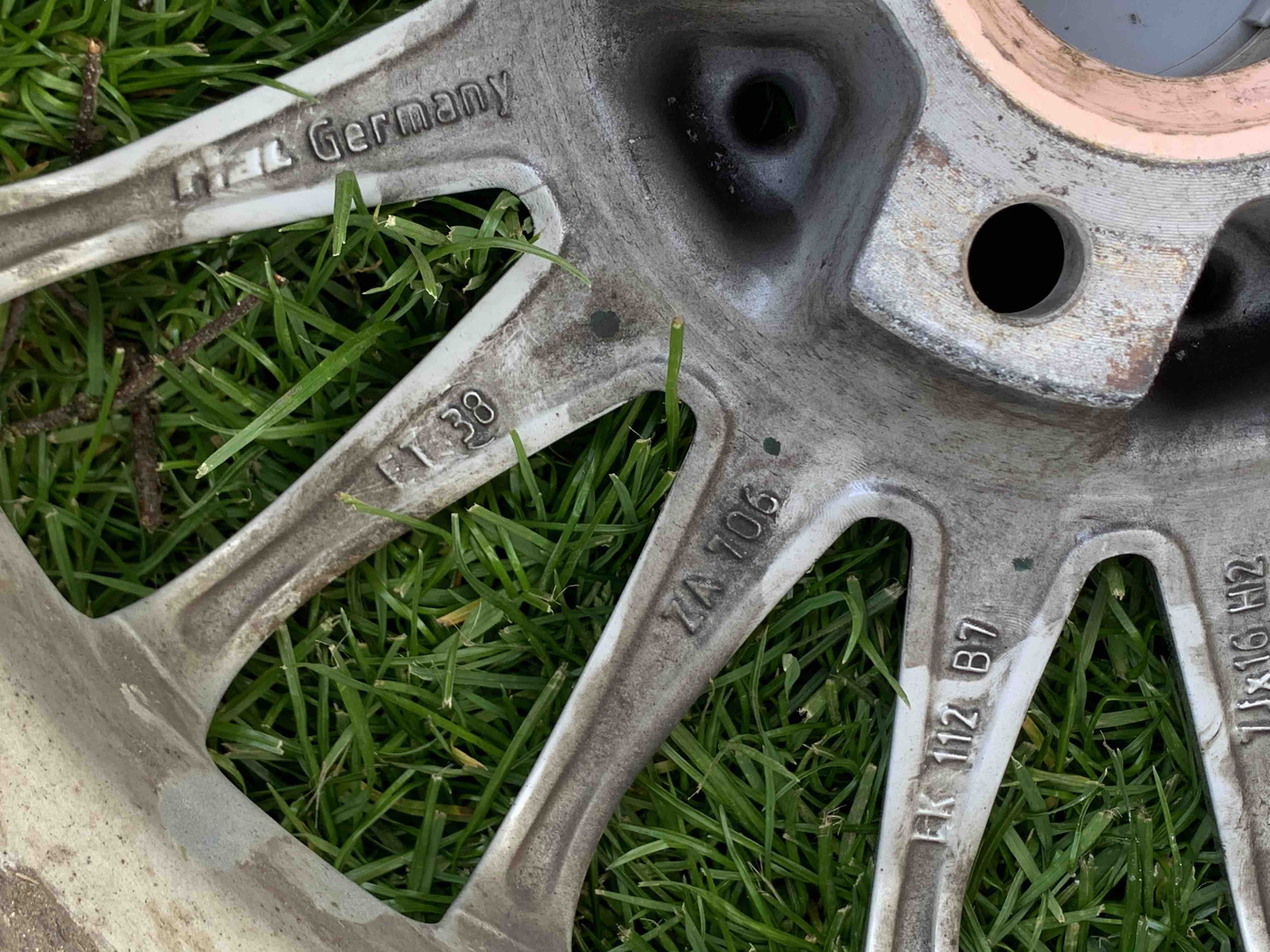

@CarlstonΒ they are aftermarket yes, They are Rial rims not sure what name they are though. they came with spigot rings when i brought them 70.0 - 57.1 and as I'm aware they were installed with the factory bolts, got them installed at a local tyre shop from a mate, so what bolt should I be looking for now do you think ?

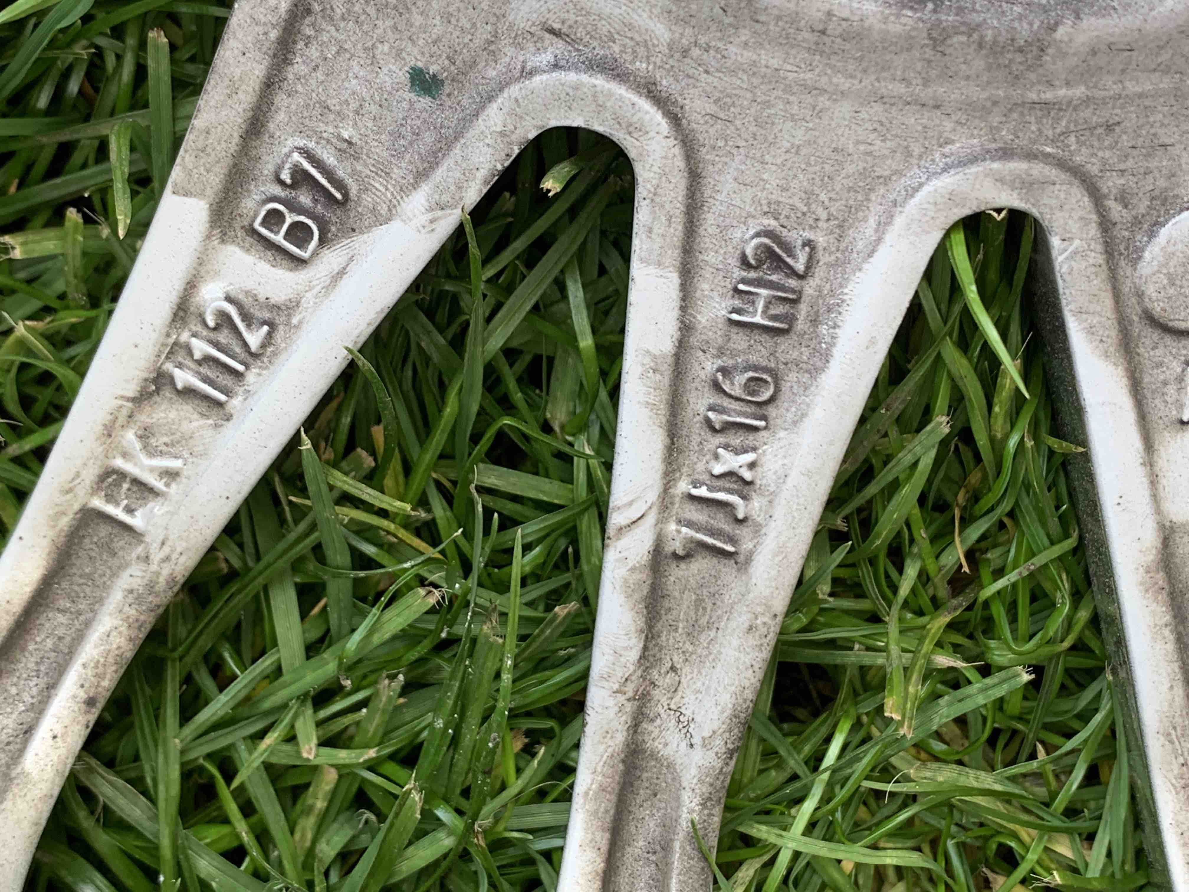

@CarlstonΒ This is a close up picture if this helps.
Β
