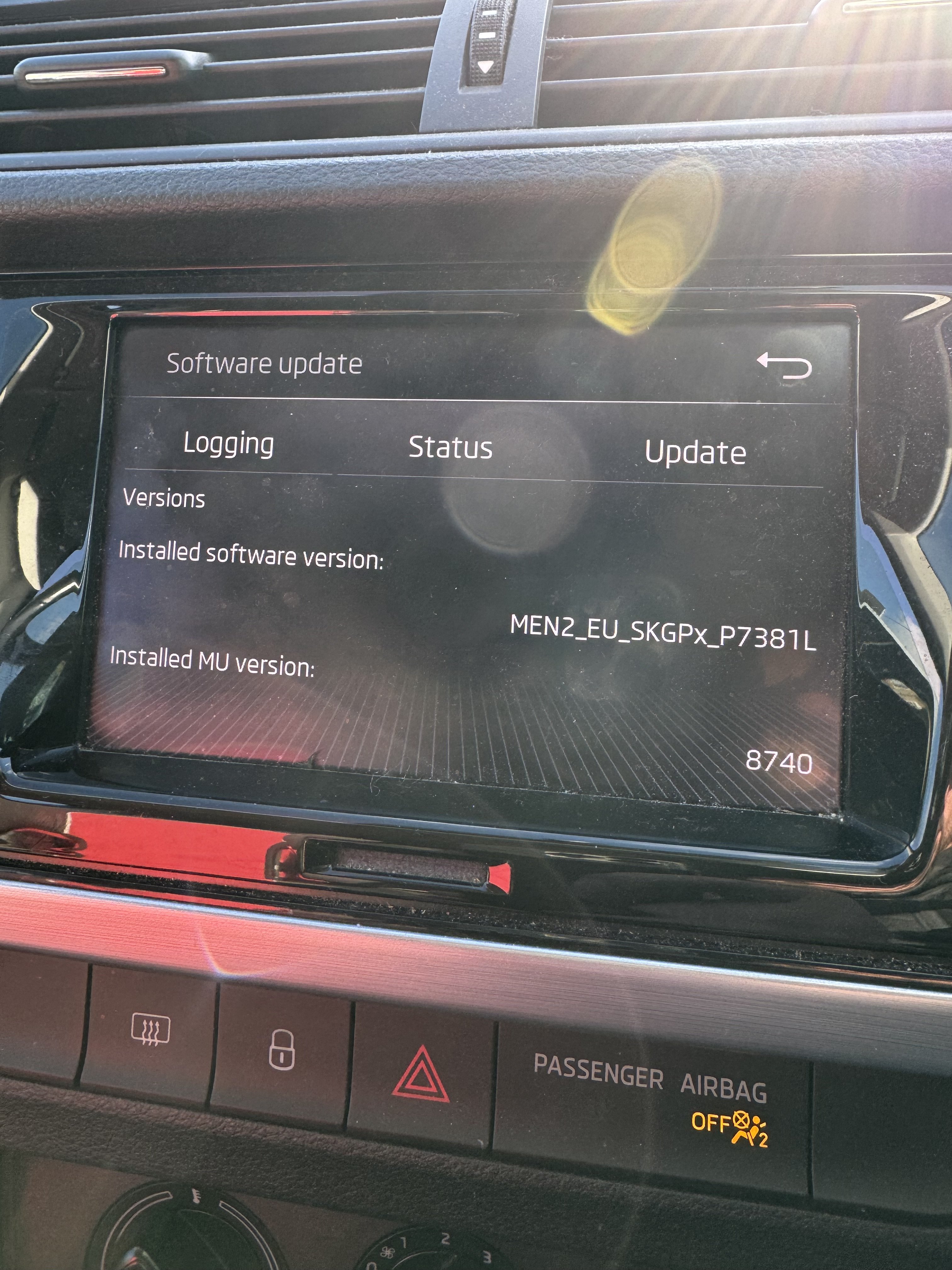

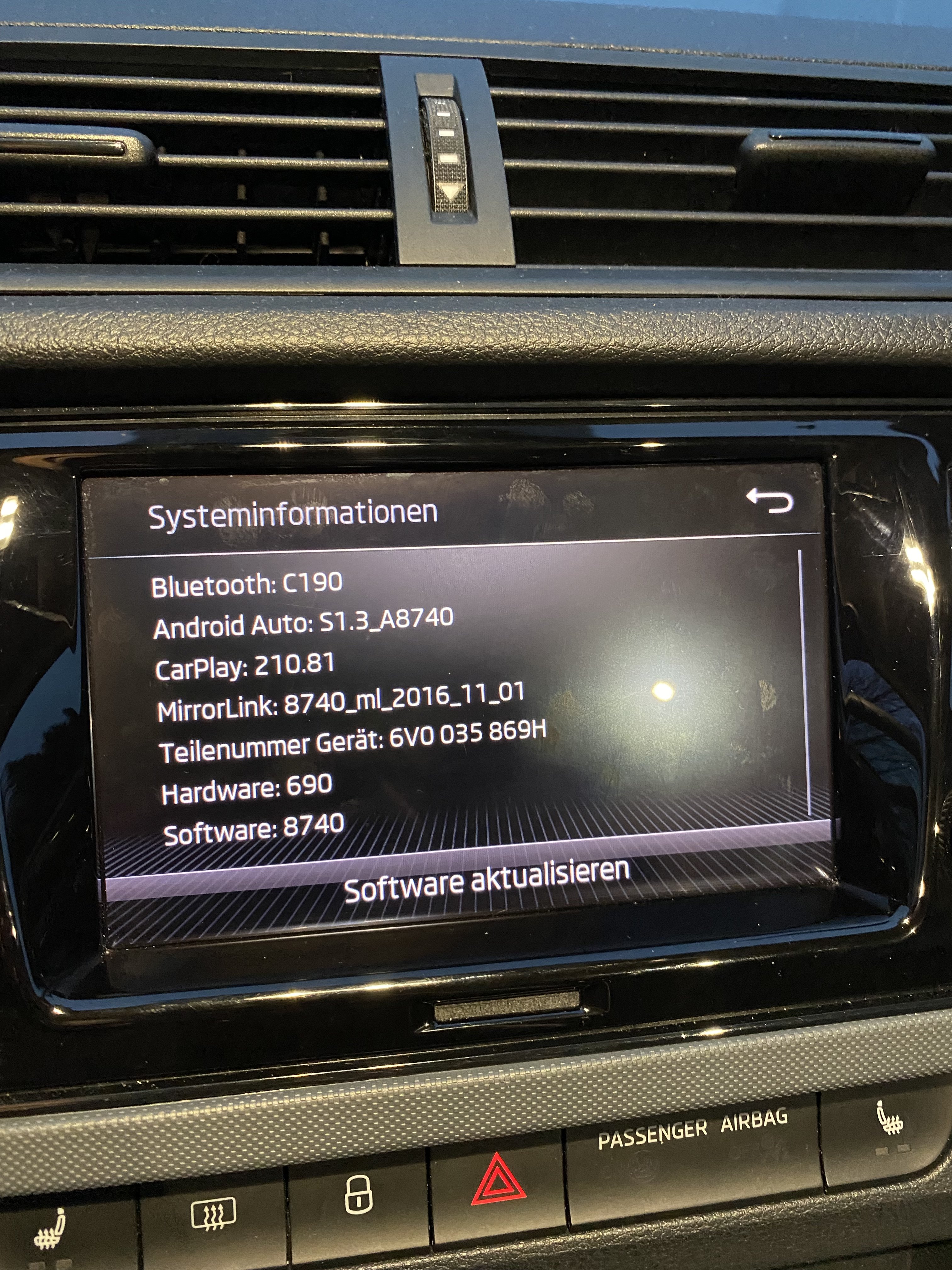

I too have have the crackly CarPlay on version 8740 and need to get to 8766 for MEN2_EU_SKGPx version.
Anyone had any luck obtaining an update?

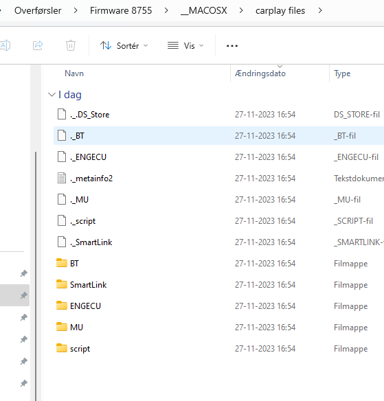

SD card <16Gb, format to FAT32 and ensure Allocation Unit size is 4096.
Unzip the files and put them on the card and ensure the files are in the root (5 folders and the txt file).

holding down the SETUP button until the SERVICE MODE screen opens, software update / version:
here if you find an entry that starts with MEN2_EU_SKGPx_   ,   in my opinion it is compatible.

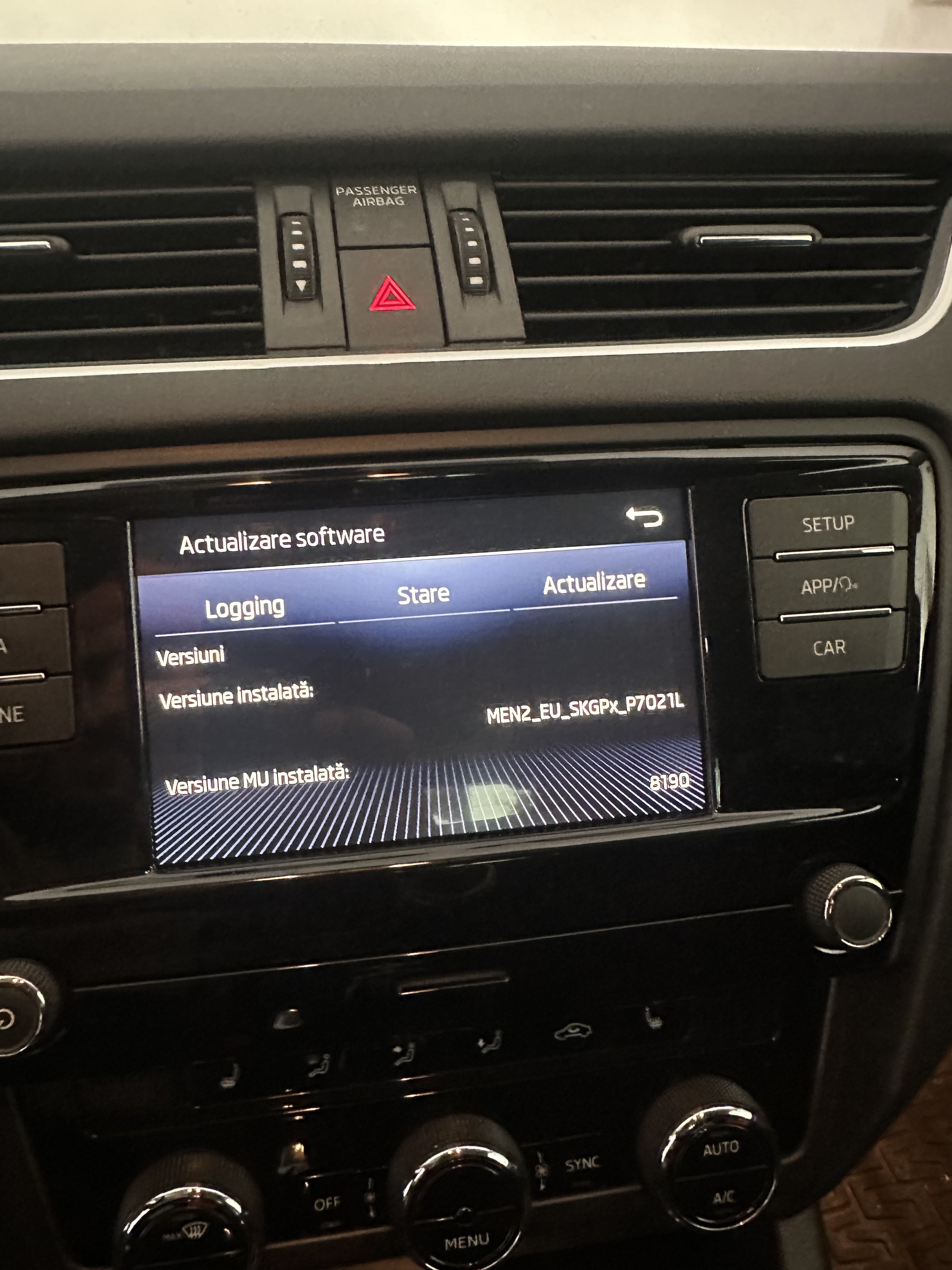

On 22/11/2023 at 18:13, torakiki111 said:
Not working on Octavia my17, signature version eror!
On 22/11/2023 at 17:13, torakiki111 said:

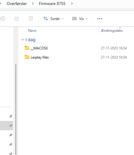

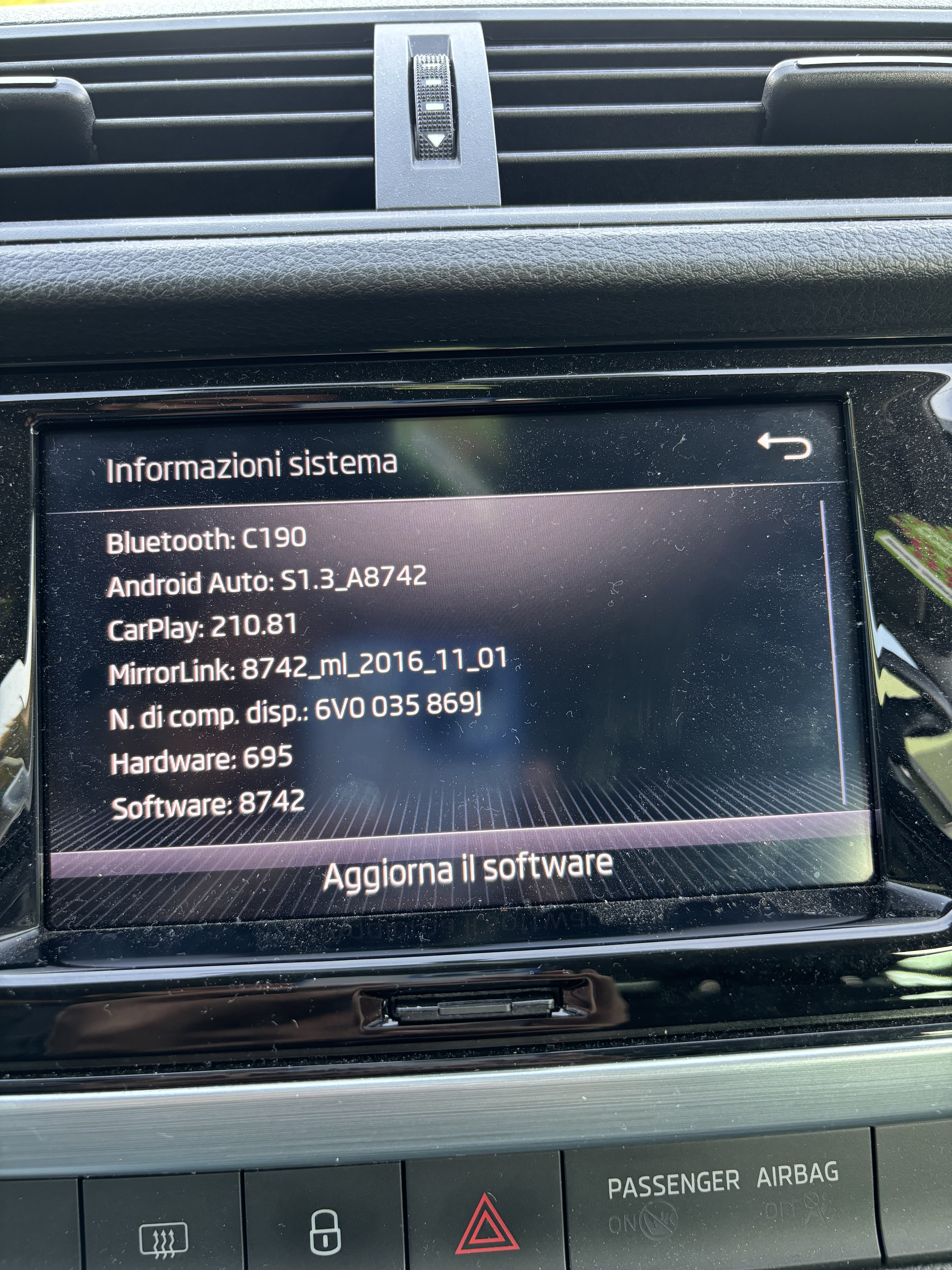

i have downloaded the file, but it contains 2 folders
whick one should i put on the sd card? we use Apple phones

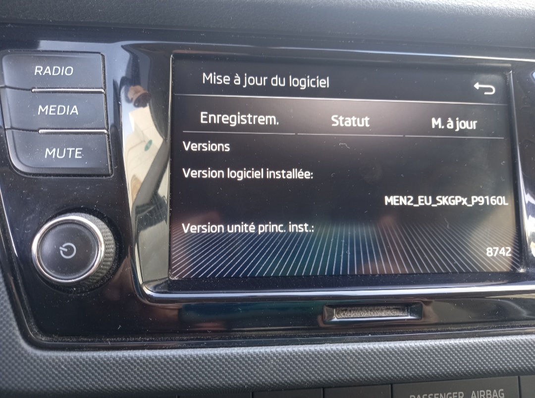

- in the same SERVICE MODE menu check that the longest string of the installed version begins with MEN2_EU_SKGPx_ because if it is not, it is practically certain that this software is not suitable for your radio
- be aware that those who updated had no problems arriving from software versions 8740 and 8742: if you have previous software, we don't know if it will work. Some users have suggested doing gradual updates (not verified if this is correct). If anyone has updated from previous versions please report it here.

- download the zip, extract the files and place them in the main folder of the SD/Pendrive. So no subfolders: just the various BT folders, etc. and the metainfo2.txt file.

Screenshot_20231213-161129_Gallery.thumb.jpg.6aee85bf96820ed4d1cf2d9c737c9674.jpg@torakiki111
my unit is 8742 and I don't have bluetooth, careplay nor smartlink on my unit and I want to install them since they are in my SWaP functions possible. How can I install them using obdeleven? I need to hack the unit ? use the 8755 update ?

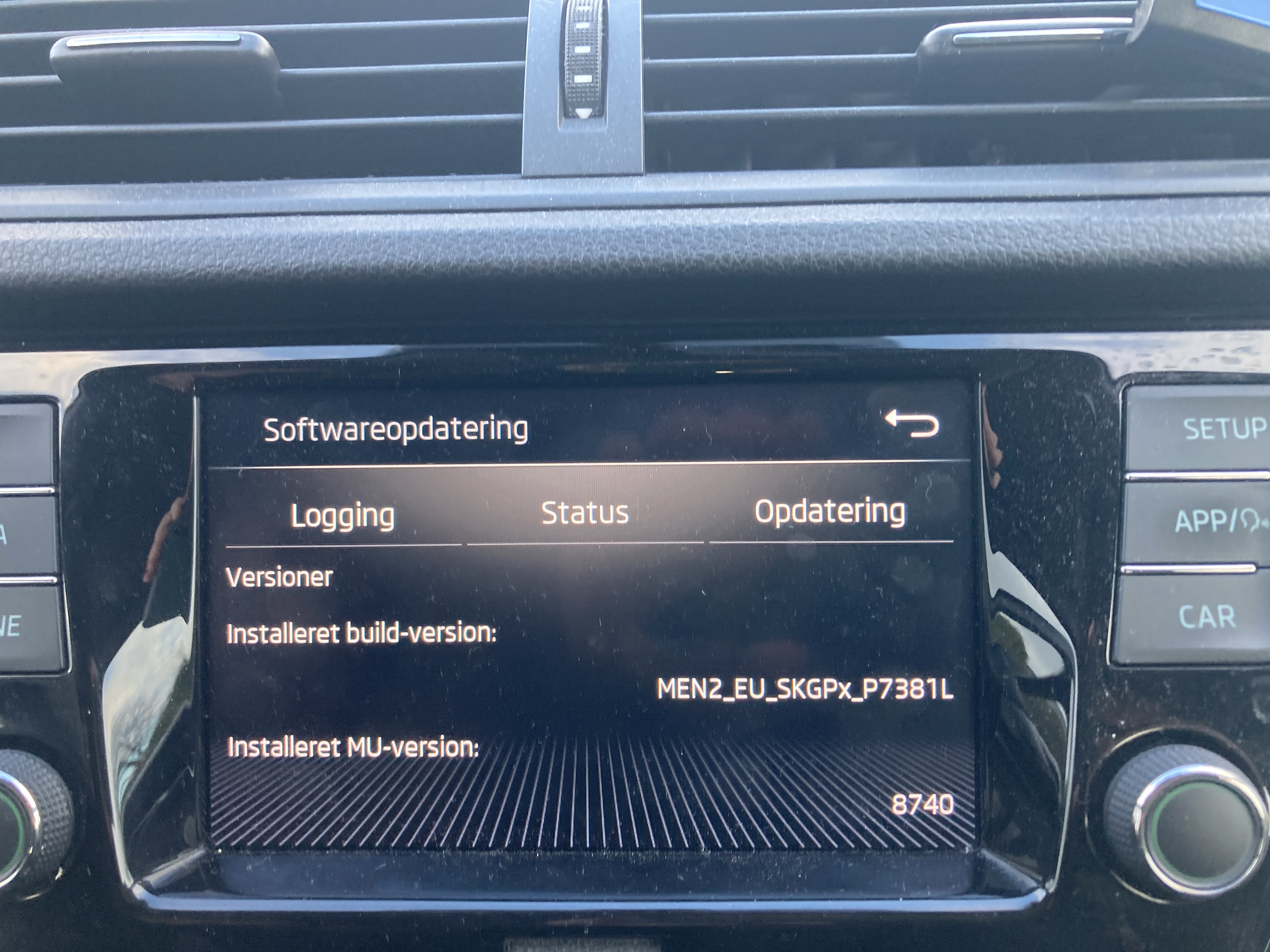

hello i have MEN2_EU_SKGPX_P7130L i want update if help me thank u so much
@benichou let me know your gmail email and i can share the files on googledrive
Hi
my Rapid has MEN2_EU_SKGPX_P7130L firware 8740 . Is it possible to get 8755 for this device ?
thanks a lot
