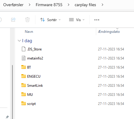

Thankyou @torakiki111 and @Tdawber for your help. I now have an updated and skip free Android Auto.
I made a few mis-steps along the way, but the magic formula for me was:
SD card <16Gb, format to FAT32 and ensure Allocation Unit size is 4096.
Unzip the files and put them on the card and ensure the files are in the root (5 folders and the txt file).
Insert SD card, long press the Setup button - update and accept the options. (I kept failing at this point but the formatting option above solved it for me)
So far, it seems to have fixed all my issues.

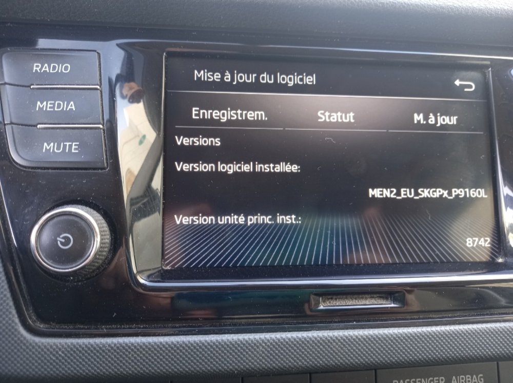

Hello all,
I currently have MEN2-EU-SKGPx_P9160L Train and MU Version 8724 installed and I'm struggling with crackling/static/distorted audio when using the USB link.
Does anyone have a file that I can use to update my firmware and get rid of this crackling?

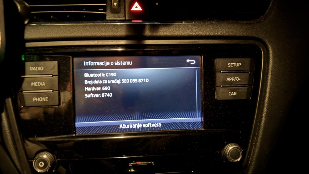

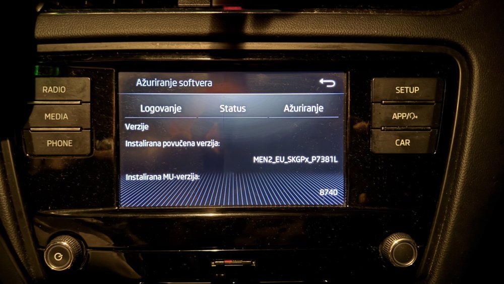

Hi, not sure if I replying to correct topic (saw my version mentioned so giving it a shot), but I have Octavia III 2018, I am having issues with some accessory for wireless android auto. Thought of updating the firmware to see if makes a difference...
Mine is MEN2_EU_SKGPX_P7381L, are there any updates? MIB Helper says that I should look for MEN2_EU_SKGPX_P9160L but unfortunately can't find that version (or any MEN2 version for that matter) on MIB Solutions...
