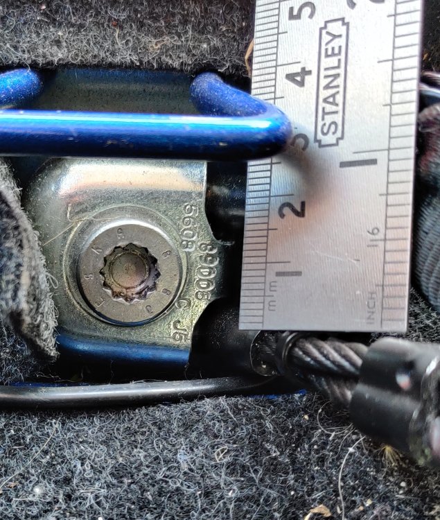

It is held in place by a star shaped bolt. Someone suggested a Torx T50 but it is not that. Has "ESKA" emblazoned on the bolt. Looks about 10mm. Twelve (.?)points on the star.
Does anyone know what these are actually called?

XZN.
Can get the nominal size by measurement and reference to this chart:
triplesquaretable.pdf
12 point triple square.  You will destroy a torx bit trying to use it. Not 12 point double hex - point angles will be different. M10 is my guess.

Well, that is impressive. Both of you. Thanks. I'll probably swap it out for a similar hex bolt and then ask local mechanic if there is an MOT friendly caribiner or anchor clip so I'll never have to do this again.

I did actually look up the requirements on the. Gov.Uk website and both anchors and caribiners are mentioned. It's not important, it just seemed an easier way to offer quickly removing the upright seat back and getting a level storage space. But I got the triple square socket and once I get the bolt out I'll switch it for a standard hex. One down side is there will still be a "fin" sticking up that supports the seat hinge.
Well this is annoying. I got the exact socket which fitted perfectly, then after a little bit of movement shredded the angles.
The isofix bracket is in the way for mole grips. Before I start drilling it out, does anyone know how long this seatbelt anchor bolt is so I don't go too deep?

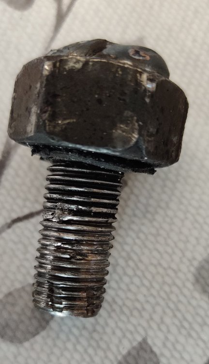

Right you are. That is the before picture. Nothing done to it.
It never occurred to me about Imperial sizes. I got a full set of metric and the 10mm fitted with no slack. The bolt turned about 20° then the metal star just shredded. The socket wrench is still perfect.
It's not some sort of reverse thread is it?
Anyway it now looks awful and frankly I just want to get that bolt out and put a fresh one in. Hence drill out with left handed drill but dont want to go too far.

With the help of a mechanic friend we sheared the head of the bolt off. Leaving a 1cm stub sticking out. So off across the hills to a keen welder called Franky who welded a nut on and with lots of heaving got the bolt out. It had been cross threaded. Don't know how because it had never been touched before.
He also retapped the hole. What a champ. I ordered the bolt online by part number but on arrival it still seemed too short. So I opted for a hex bolt that was still 7/16th at 20 tpi and was 50mm instead of 25.
I thought I would have to trim it down. But it fits right in.
