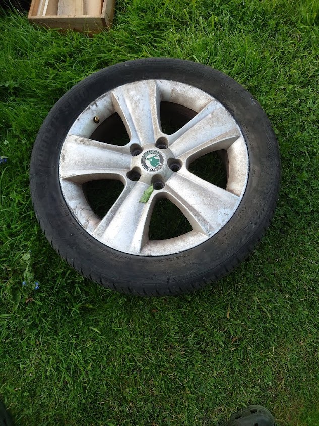

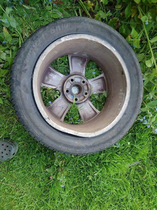

My Dad managed to hit a kerb today whilst driving our Yeti and damaged the rim. On the bay I cannot see anyone local selling Dolomite 17" rims and would rather buy local so I can inspect it. So in lieu of that I was wondering if it is practical to repair rims? There are quite a lot of peening marks on the inside of the rim so I guess that would also need to be repaired as the metal looks a little thin.
Has anybody had this done?

The damage is on the inner rim, it is flattened, it must have driven right over the kerb!
Peening marks indeed!

I believe the peening marks that are present are from a prior incident but they were also a cause for concern.
1.  I don't think that is a Dolomite... I think that is a "Moon",  but I could be wrong.
2. I would not be considering repairing it... the inner rim is bent out of shape,  and the inner rim diagonally opposite that damage looks as if its been hammered back into shape previously   (is that what you refer to as "peening"?)
       On safety grounds alone I'd be looking to replace it,  either with a secondhand one,  or else I suspect new replacements are still available.
OK, I understand what you mean by peening marks now.
They must be very weak inner rim sections for it to have bent twice but leaving no witness marks on the outer rim, cast alloy fracures easily with deformation, I'm surprised that it was straightened once without cracking and being weakened, a 2nd time would really be tempting fate.
Have you had the tyre checked for damage?
How long have you owned the vehicle? Could it be that the damage to the inner rim was already there and the peen marks were someones failed attempts to straighten it?
After all when your father hit the kerb it would have been with the outer rim if it was a normal glancing blow, both rims if he went right over it, in either case I would have expected to see impact damage on the tyre outer sidewall and the outer rim.
Something worng when a rim can be damaged but the tyre not, especially if it was two times.
Our posts overlapped, that has made it clearer to me now, must be very weak to have deformed twice without any damage to the outer rim and in at least one case no tyre damage.

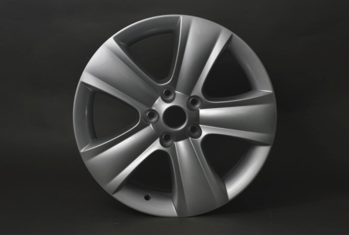

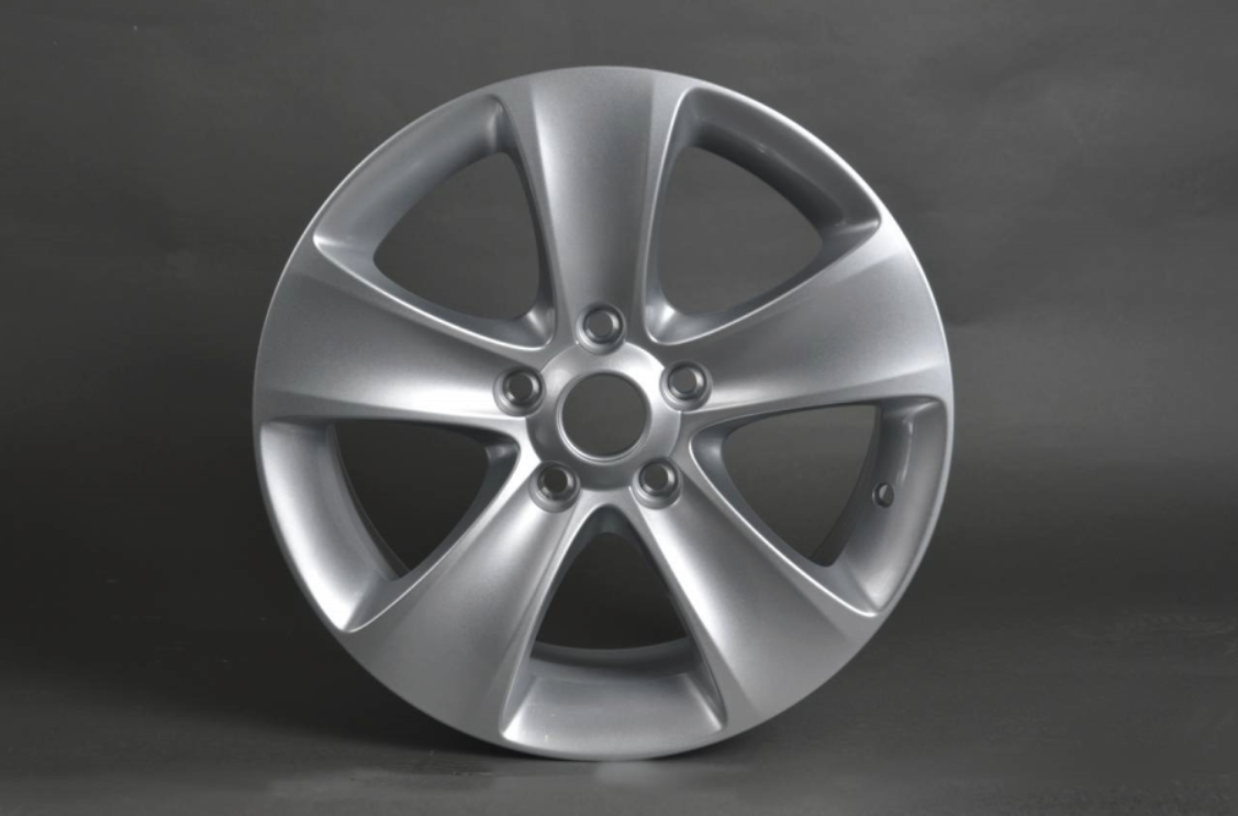

Moon is 16"
Dolomite is 17"
Moon
Dolomite (has a sharper crease line)
And the hole lines up on the air fill point also
Easily confused though 🤝

The tyre looks okay but I'll probably change it anyway. When I took it to the tyre shop they were able to seal it enough to inflate it but advised that it really shouldn't be used for high speed anymore.
This is the second time my Dad has managed to mess the wheel up in as many years - it was brought just before lockdown Christmas so December 2020.
I'm not quite sure of the specifics of the accident this time but it involved hitting a road island with the wheel so it is possible that the inner side received the brunt of the impact if the island was small enough.  So it wasn't kerb like I had mentioned earlier.
I guess my question has been answered, do not try to repair this. I will find another and will definitely consider moving to a 16" set as it seems I'd then get more tyre meat and 16" rims seem easier to come by when I next need to replace it. I know this will happen again with my Dad's driving. He is at the point where he is considering giving up driving but there is no public transport and he has a dog so taxi's are difficult. I drove him exlusively during the dark winter months and it was difficult as it heavily impacted on my life.

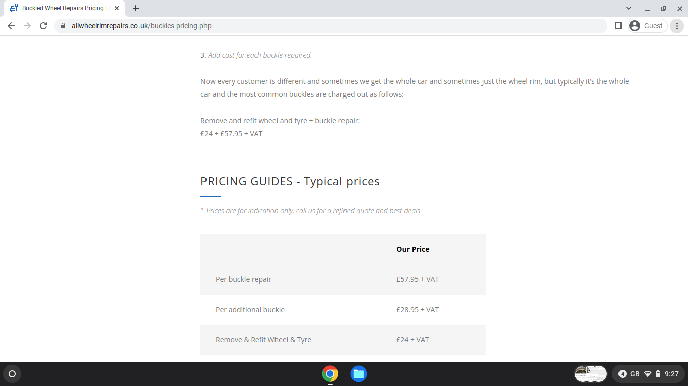

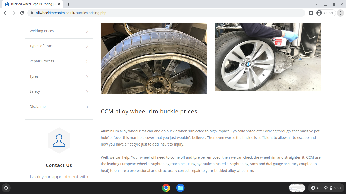

That wheel is totally repairable by any reputable alloy wheel refurb place.
And will be just as strong as a new rim at a fraction of the cost.
It might be totally repairable and safe and it might not be, but just looking at a picture is not going to be how you know. Those that do repairs need it to check.
