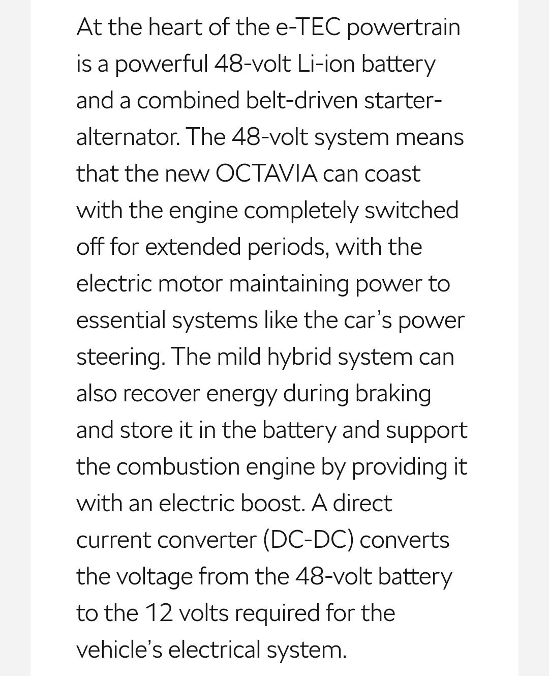

Admittedly this is referring to the 1.0  TSi in an Octavia, but would appear to suggest the mild hybrid system does in some way provide a 'boost' to the engine.
'The mild hybrid system can also recover energy during braking and store it in the battery and support the combustion engine by providing it with an electric boost
My take after driving the e-Tec 1.5 TSi DSG Kodiak was it felt noticeably 'snappier' from a standstill than the 1.5 TSi DSG Kamiq.
Quote
Well, yes the mild hybrid can obviously provide additional power. Looking at the specs though, the maximum power and torque of the hybrid and non-hybrid engines are the same. What may well be the case is that the hybrid provides additional power lower down the rev range, so in effect you get more torque at lower rpm. Without seeing the torque curves for both hybrid and non-hybrid, its difficult to say but that could certainly be why it feels 'snappier'.
