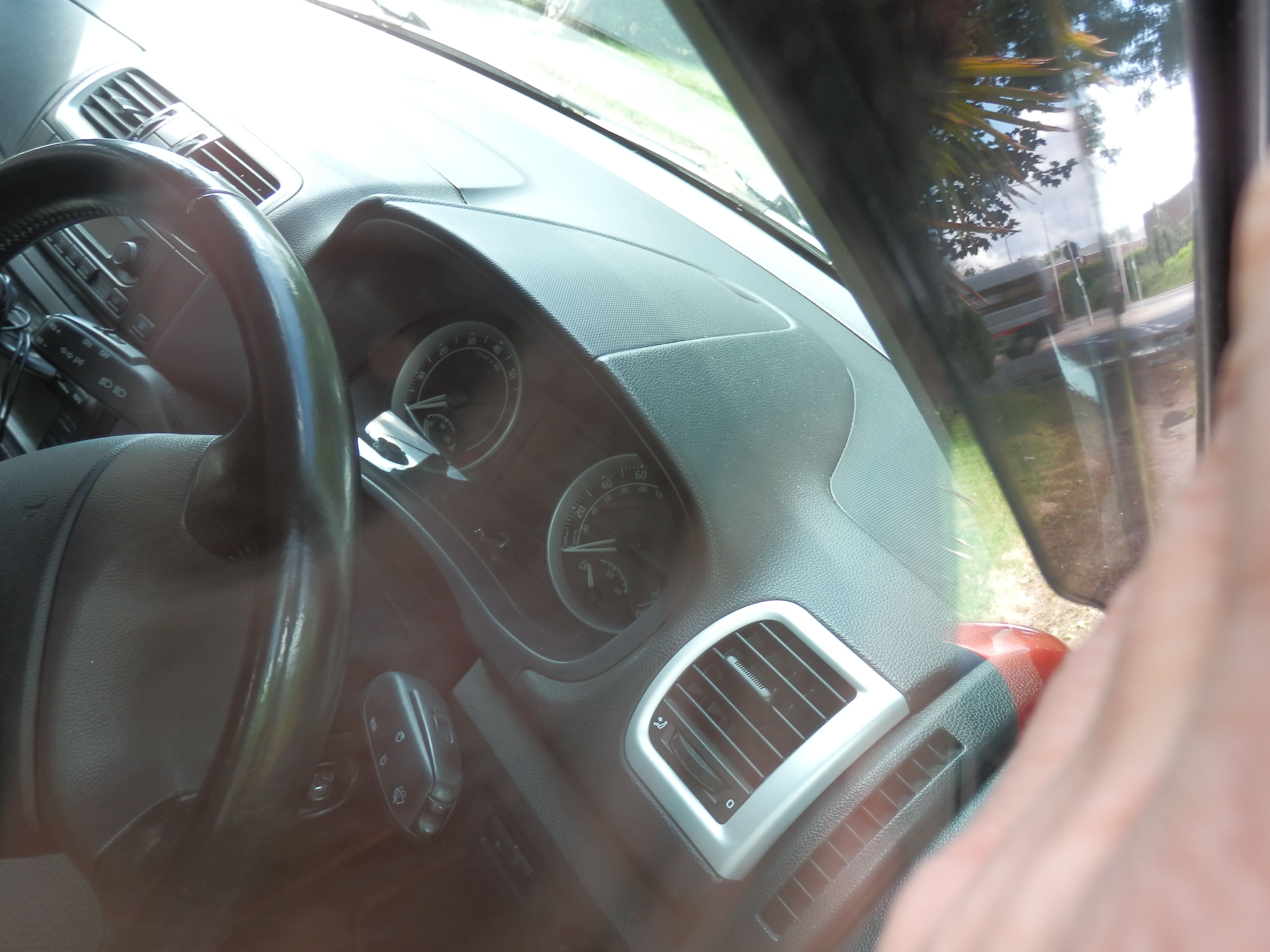

I noticed yesterday that the following display is permanently active in the instrument cluster, with the doors closed and the vehicle locked - even after a whole night:
Unfortunately, I don't know if the behaviour has always been like this (regardless of whether it would be normal or not - I simply have no valid basis for comparison). But I guess the answer would be: No, not normal.
Therefore question 1: Is it normal that the digital display remains active?
If not, then the following additional information / question 2:
Yesterday we replaced the door lock on the passenger side; this also has an electrical contact (closing contact) - do you think this could be the cause?
Strangely enough, I also installed the old lock again and the behaviour is identical.
And what's also strange: if I don't connect the electrical contact plug to the lock at all, the behaviour is also identical!
Thanks in advance
I checked my MFD and though different from yours, it stays on when I lock the car. However, if I go back sometime later it has shut down.
I take it when you say "even after a whole night", you approach the car without pipping the locks, as this switches my display back on.
Exactly yes - I do not have a remote unlock, I have only the mechanical door opening. So yes, I approach the car and lookin through the windows and the display is still on ... ;(

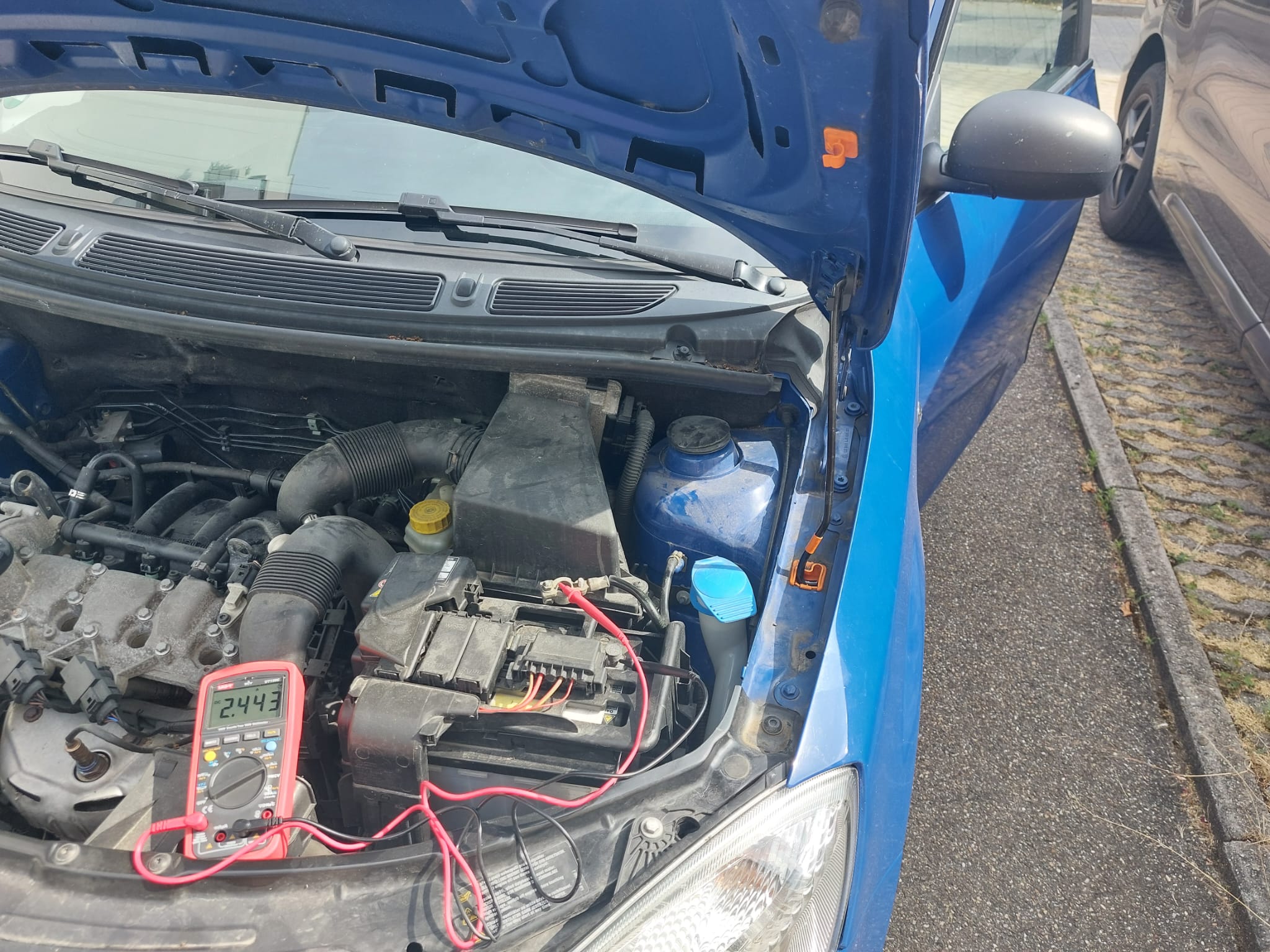

I measured the idle current.
Roughly 120mA when locked and after waiting for 10 minutes...
When I pull fuse 22 to completely shut the display off, it drops to 0.000A, i.e. Fuse 22 is the only fuse where some permanent 12V devices could possibly be used over :) Very interesting!!!

Yeah sure. Lucky the battery is right under the hood. So it's easily accessible while the car can be locked.
So I opened the hood, disconnected minus port, and inserted my multimeter in-between. I went and unlocked and opened the door to wake things up - afterwards closed and locked the door and waited...

When doors opened, it looks like this, 2.44 A:

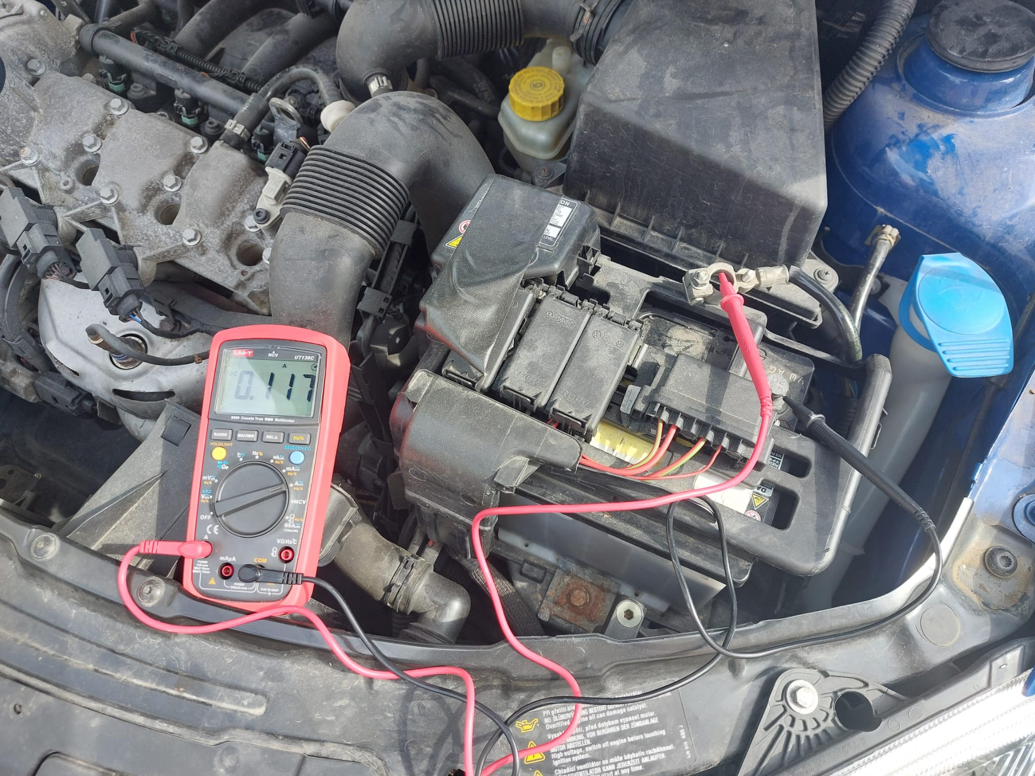

And after closing and locking, as described, like this:
But I'll do another test and will check after 30minutes..
  • Sponsor
A healthy result is maybe 15mA in full sleep.
If you have the deadlock LED flashing on driver's door, expect it to jump around by a few mA in sync with flashing.

117 mA is a lot for a shut down FII - I think.

Yes 117ma is about 100 too much. Can be a BCM fault, in my experience, if real. An update from the OP on the measurement after 30 mins of allowing to go to sleep would be good.
