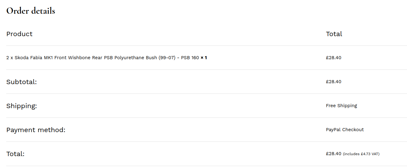

Don't buy a genuine console bush, get a PSB bush, really easy to install and better handling as a bonus.
Look up Fabia PSB bush on eBay, vastly superior and no special tools needed.
2 minutes ago, sepulchrave said:
Yes, those.
Cool ordered

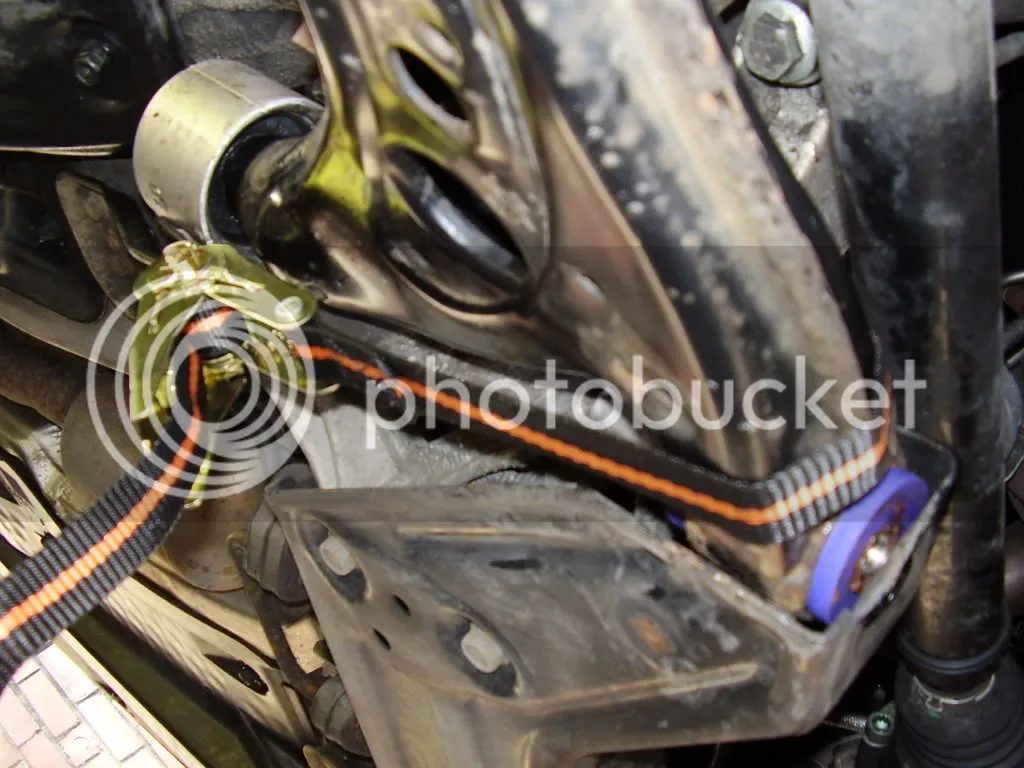

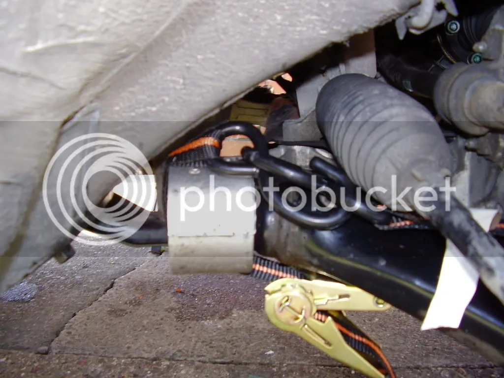

Got the PSB bushing installed but couldn't get the control arm to slide in, used plenty of lube, any tricks? Binds up about 2cm in
You can use a ratchet strap. Only usually needed for the standard bushes but it will work for the PSB ones too.
Ratchet strap is genius, will give that a go
Couldn't quite get the ratchets in a good enough spot to crank down, any chance you have a pic of how you had them hooked up? I'm being beaten by a fabia 😭 haha
Couple of old pics from the briskoda wishbone guide. Sorry about the photobucket watermarks.
