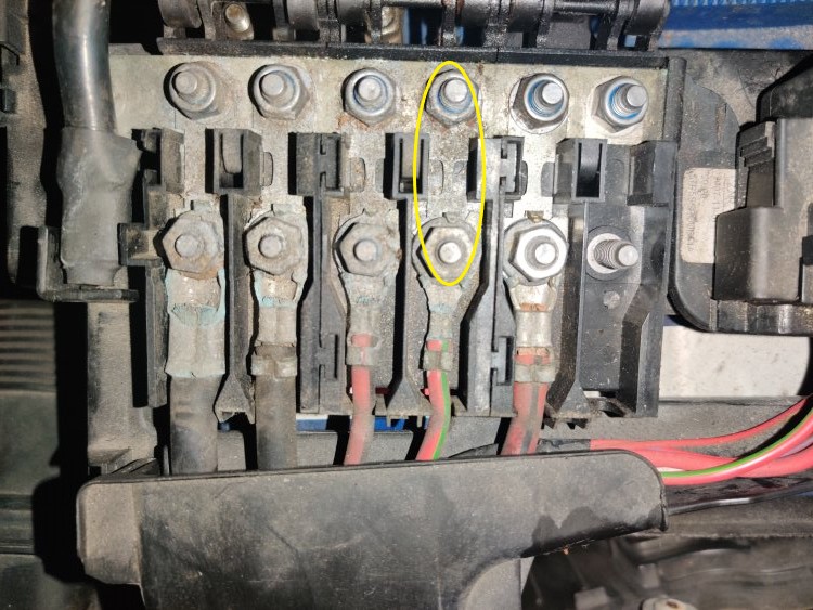

You need to look at the big strip fuses on top of the battery. Post a photo here if possible.
These....

Edited by TMB

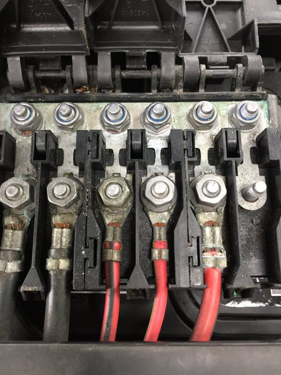

Here's a photo of those ones. Hopefully everything is visible, despite the flash.
Maybe the strip on the one with the red and green does have a crack in it. I'll have to check in the morning.
The ABS one looks potentially cracked but it's hard to tell. Give it a poke.....

Rain has interfered with plans today, but I managed to get out during a break and loosened the nuts on that strip fuse. It is definitely in two parts!
Will any VW 40A strip fuse work as a replacement?

I switched the broken fuse with a 40A from Halfords, warning lights are still on, so I guess another trip to the friendly VCDS person is in order?
The product code for the Halfords part was FUSE 298, which is apparently the same as FUSE 133. They are in the process of changing product codes. FYI
  • Sponsor
Drive the car a few metres and the warnings will magically disappear.  :thumbup:
