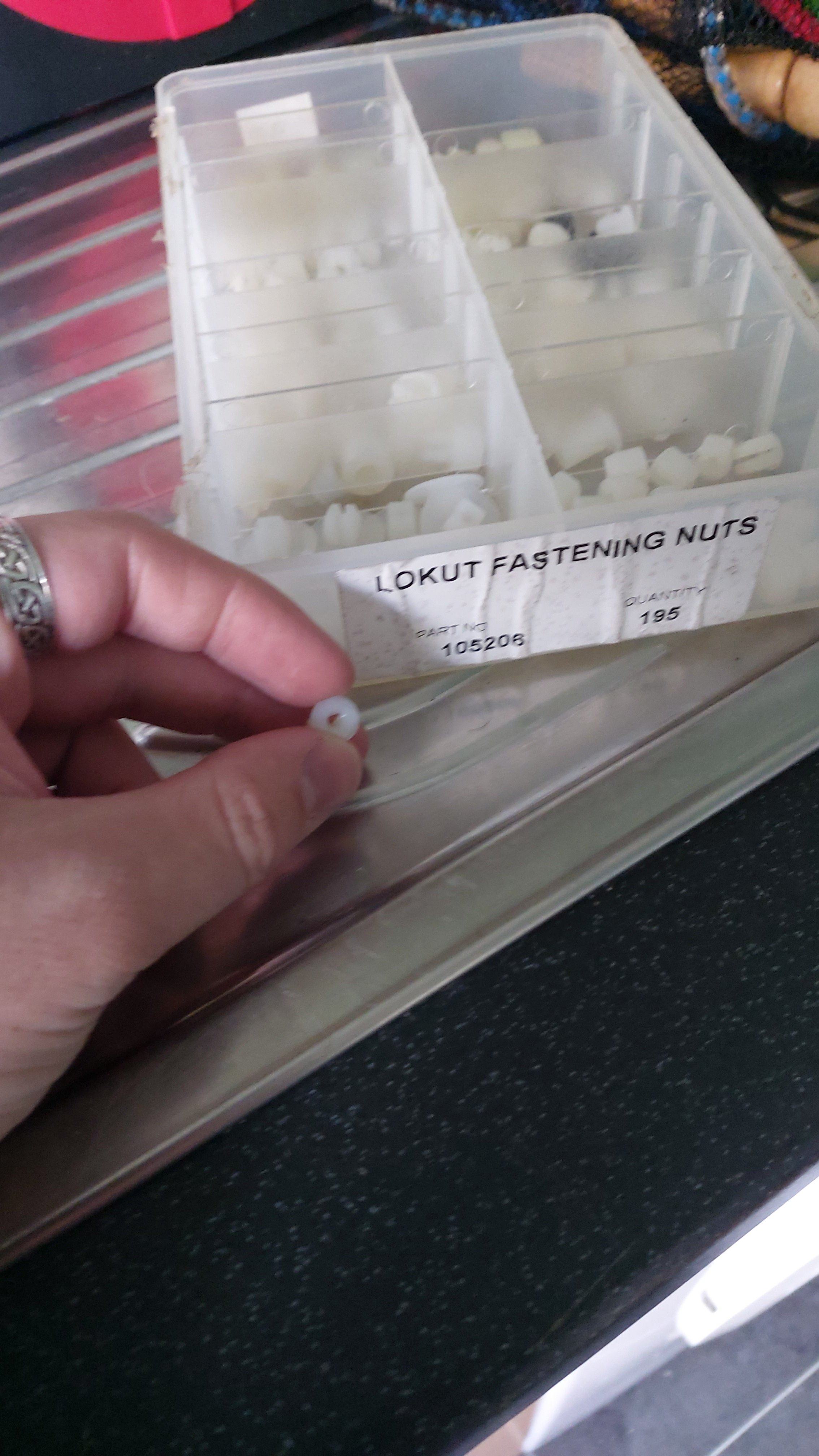

Potentially. I shall take a photo of the boxes of what I used.
At the moment, with the new doors going on, I'm about to have three doors that have screwed in regulators, and one that's still rivets... :D
These are what I used. Cannot remember for the life of me where they came from, though.
Drilled rivets out, and replaced them with these and self-tapping screws. No issues so far.
^ Those are designed to go into square holes. You cowboy 😁

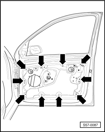

Last regulator I did I drilled the rivet holes out to 9mm, then used an M6 Rivnut in each hole. With obviously an M6 bolt in after. 9 in total (from memory??)
As I only have this job to do, I was hoping to avoid buying the tool if possible. There are a number of people using these kinds of methods, according to YT. I would use Deon's first method
10 🙂
