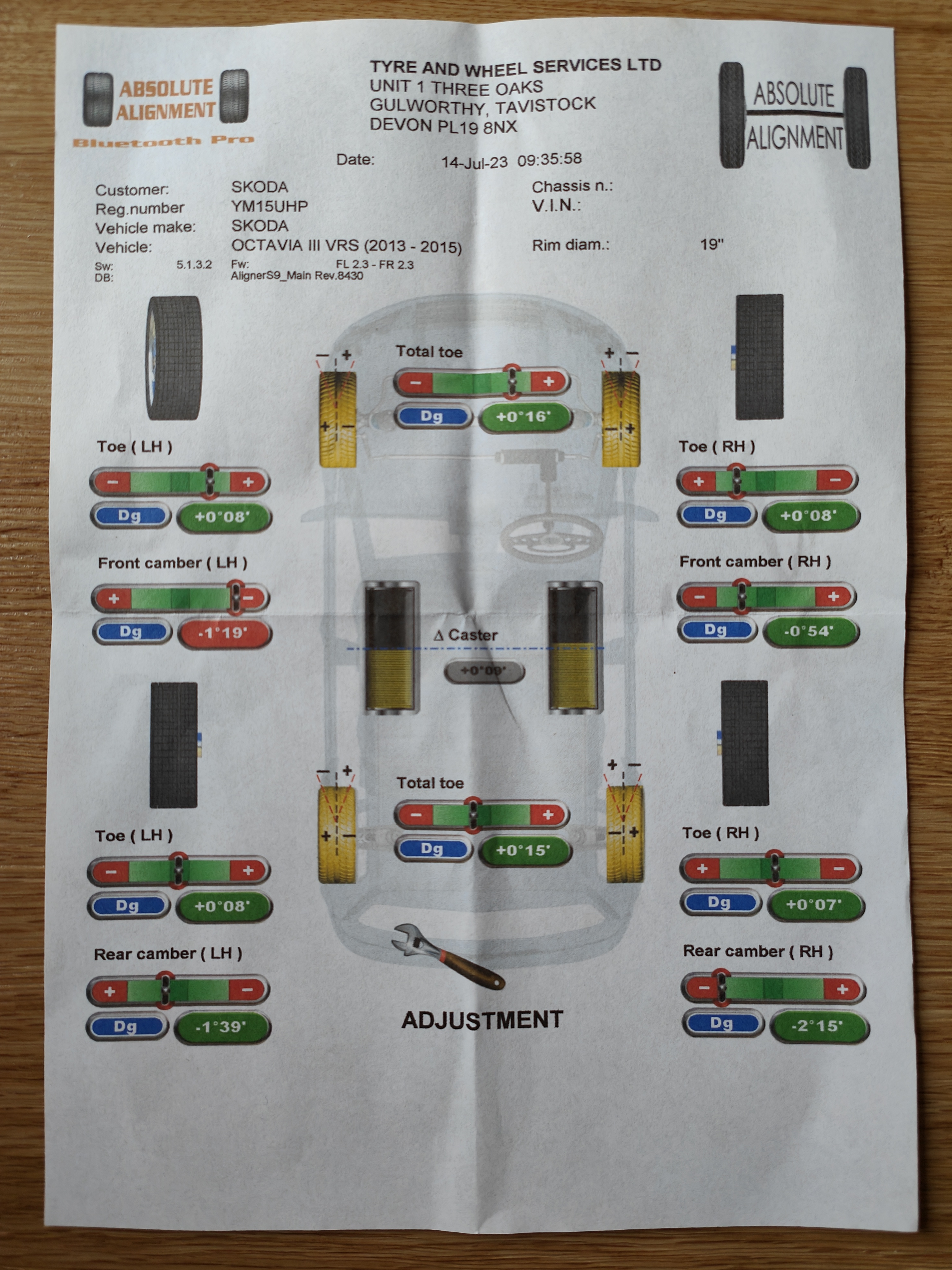

After fitting my front suspension with a friend last weekend and having a nightmare with rusted and seized bolts, I took my car for tracking and alignment today.
Unfortunately, they can't adjust the rear camber due to a completely rusted bolt. I'm not worried in the short term as I had the toe adjustment bolts and bush replaced last year so toe is ok. However it's something I'd like to sort at some point as camber seems to be on max acceptable adjustment. When talking to them about it they said the whole subframe would probably have to come down due to its location near the boot floor, the part sourced and the old one ground off.
Due to this, it made me wonder if the later 3.5 (facelift) rear end will fit the pre-facelift. If the entire rear subframe has to come off, and with my current one being rustier than I'd ever expect an 8 year old car to be, I figured it could cost just as much as trying to replace the original bolt, as long as the subframe I replace it with is in far better condition.
It would have the benefit of adding track width so I wouldn't bother with spacers too.
Does the 3.5 fit the 3? Does it have to be an estate version or is the saloon the same? Is the mk7 GTi rear end the same?
Thanks in advance,
Doug
