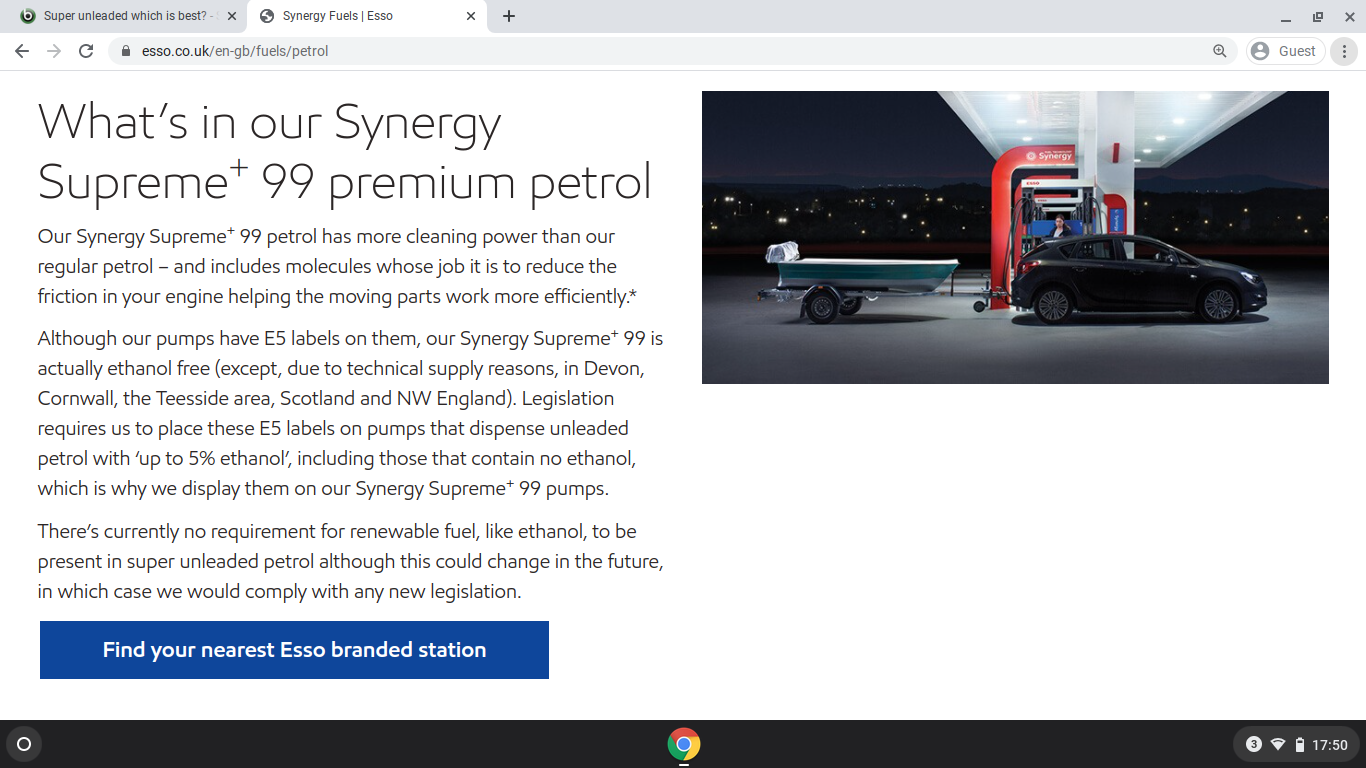

but Tesco Momentum 99 is a Super market fuel as is Sainsbury 97 (min) super Unleaded.   Good stuff from a supermarket and the E10 95 ron is hardly 'Own Brand' crap it comes in with the base fuel from Royal Dutch Shell that have importation and storage with Greenergy as partners.
Then not all E5,s are the dame around the UK, and not all E10,s have up to 10% bio.
Some ESSO E5 or E10 in the UK is from Greenergy that is part owned by Tesco & supplies others including independents.
So where are you in the UK and where were you buying the E10 from?
