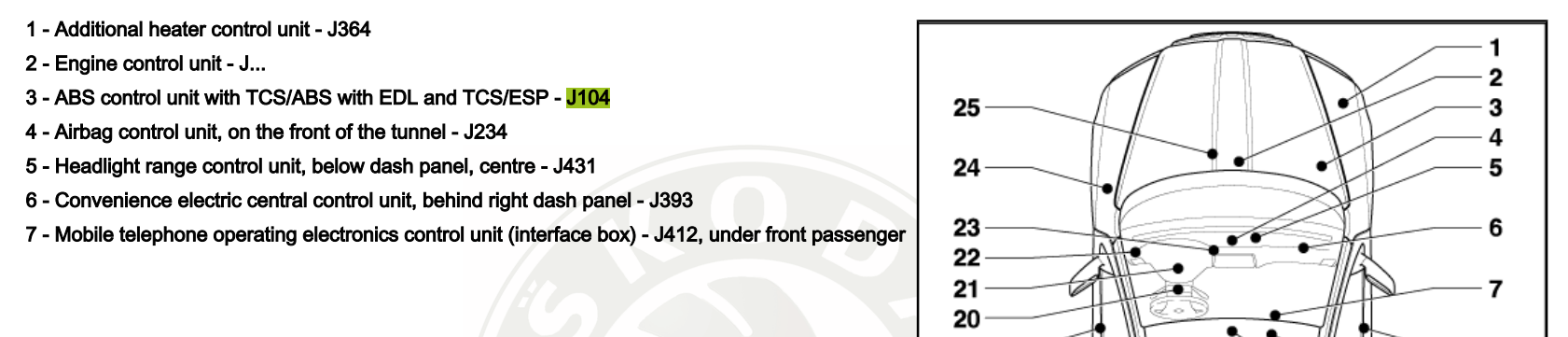

I got a simple diagnose tool that reports that the rear left abs-sensor has feiled.  Changed the sensor, and reset the error, but it came back immediately. Where is the ABS-ECU located? Is it possible to swap two of the sensor wires to check if the error moves to the other sensor? If it does the problem should be in a wire or maybe the sensor ring?

Location : see item 3

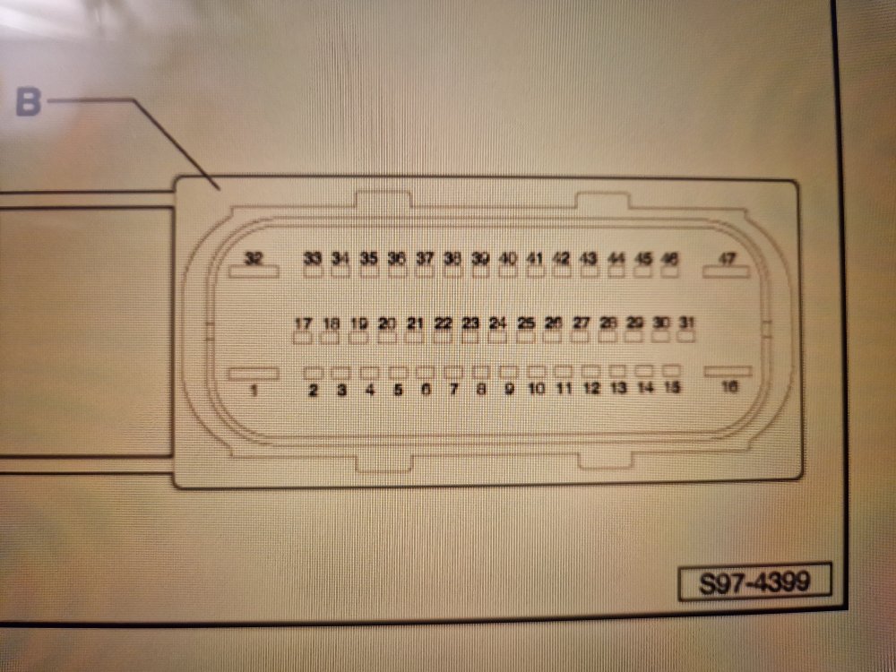

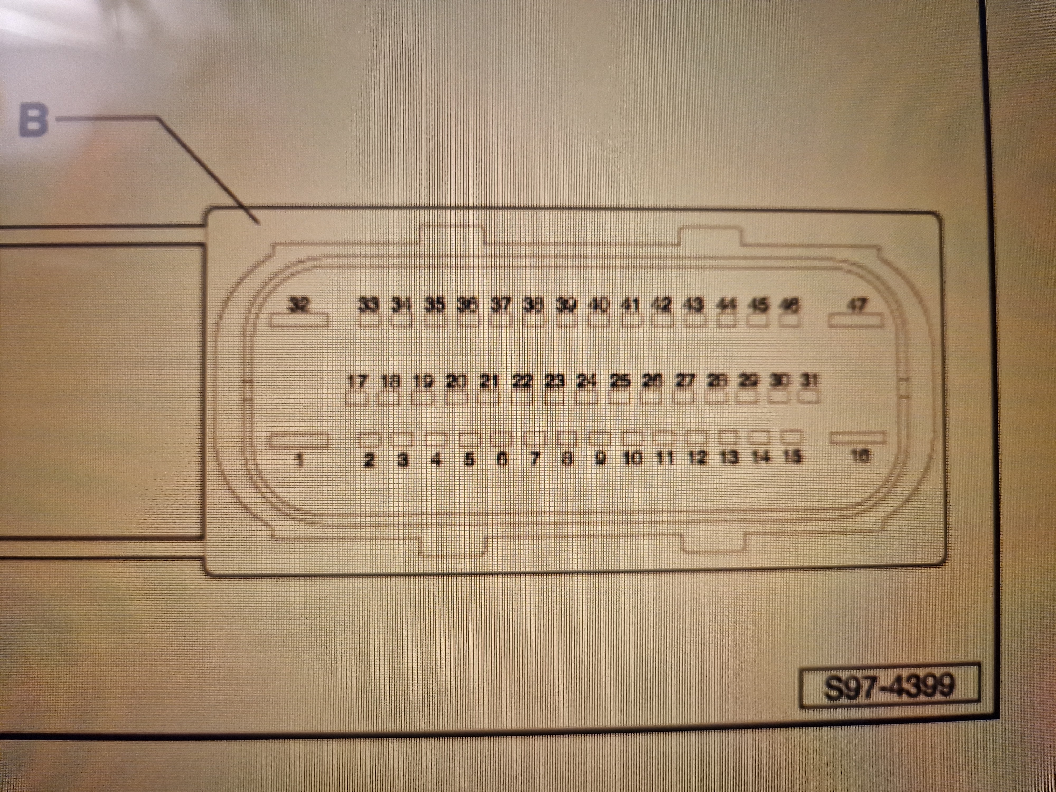

Disconnected the connector today. Looked rather clean. A small damage to the insulation on the black wire for sensor 1, if this is pin no 3? Applid some 5-56, and reseated the connector. Resat the 00290 error, and drove for a short trip. The esp light flashed when I turned into the street after about 50 meters. Then I drive a few hundred neters to a roundabout, and the esp lighr flad'shed again. Then both abs and esp light came on, and stayed on. Maybe the magnet ring is the likely problem here? IMG_9203.thumb.jpeg.184c85f9ffa9ae19afad110b86a483f3.jpeg

Next pair of black and brown to the right of the arrowed pair, I think.
You have 3 rows of connections, so left rear is pins 36 (black wire) and 37 (brown).
Edited by Breezy_Pete
  • Sponsor
Ah, yes I see, thanks!
