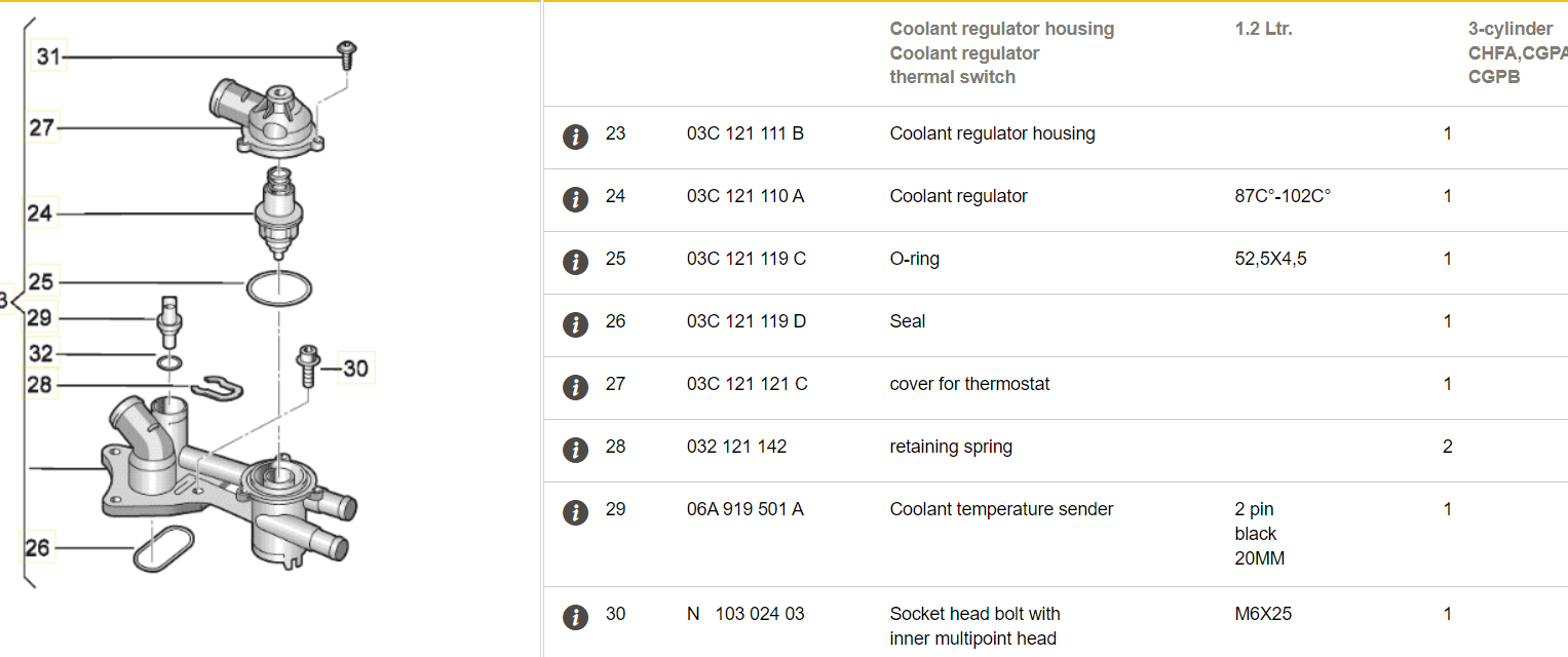

It's more cost, but I wonder if it's worth replacing the thermostat and associated flange while you're at it, to possibly improve head temperatures if the original isn't opening as early/wide as it oughta? The o-ring that seals the flange to the end of the head may have lost its compliance and fail to reseal if it has been removed, which I assume it has?
Probably worth it, I don't suppose you have the part numbers for the thermostat and seal please? I can see different looking ones and I don't want to really buy the whole plastic housing...
I have the housing to head seal.

Items 24 and 25 here:
  • Sponsor
Maybe compare room temperature pin protrusion of the current one with images in listings for new ones? If the current one's pin looks further in, chances are some of the wax has escaped. If not, maybe no need to replace?
I'll stick a new one in. Once it is all done and working fine it will be going back to my daughter who lives about 2.5 hours away so want it as reliable as possible.
